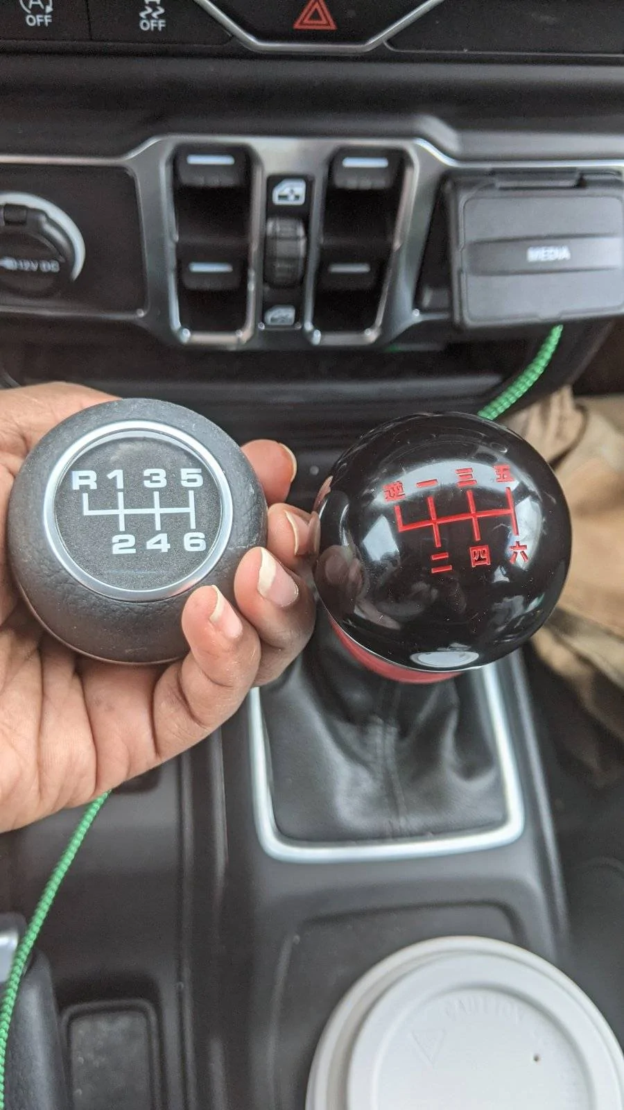

Does anyone have experience removing their stock 6 speed Shift knob on a JL, to replace it with an after market?

From what I understand, it's a little more difficult to replace than previous models where the stock knob just yanks off.
I've seen an adapter for the JL shifter here:
https://www.speeddawg.com/jeep-2018...sion-shift-knob-adapter-jl-gladiator-rubicon/
And the transfer case knob:
https://www.speeddawg.com/jeep-2018...t-knob-adapter-jl-wrangler-gladiator-rubicon/
No experience with the above adapter, but hoping someone else will weigh in. I really loved my DV8 'tire tread' shifters on my JK, I'm hoping they'll make a similar styled set eventually for the JL. So keeping this adapter in mind.

Thank you so much for your help! this is awesome!

With the help of yall lovely people Im able to remove the shift knob with ease and i have the right adapter. Unfortunately the knob that i fell in love with is too small to even fit the adapter. so for now ill put this project on hold until i find a knob that im in love with - that fits.

I did it! The company I bought the adapter from (speeddawg) suggested I try Sick Speed for a knob with bigger threads. They don't have the right knob on their website, but I called and they do have the knob with the reverse on the left, you just have to ask them. I also went to lowes and purchased washers to get the numbers to line up.

^ This is good to know, so thanks for posting. I have a Rocknob (An actual river rock) from my JK that I am looking on using on my 6pd JL (once it arrives). The knob I’ve got has set screws so I’m hoping I can get it to fit. How does the reverse lock-out workout with your shift knob?

I positioned the adapter higher so I still have space to play with the reverse.
