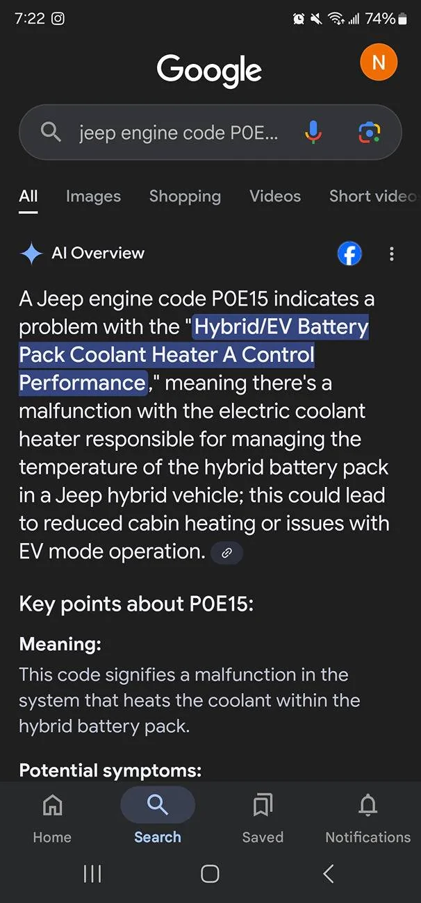

The Autozone folks brought out their good reader and it's a P0E15. Their cheaper generic one that they let people use also showed 0 codes.

Very common hybrid battery coolant heater failure. Pretty easy and quick fix that your dealer probably understands, and covered by warranty. Hopefully the newer heater models last longer. I can’t think of any reason not to continue driving with this CEL. The hybrid will behave a little differently. ICE will be on more.
Invest in a better OBD (JScan, tazer…) if you can
