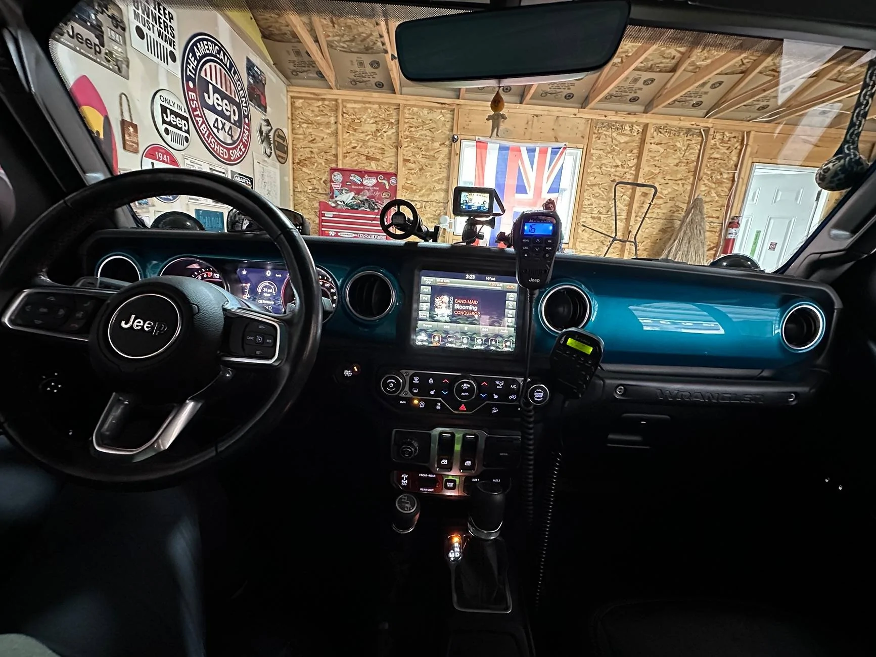

No. The closest you’ll get is a unit where all the controls are in the handset and the box can be tucked out of site.
My set up is a Cobra WX-ST75 CB for Easter Jeep Safari and the odd occasion someone on a local trail is using CB. Midland MXT-275 GMRS for general trail use.
