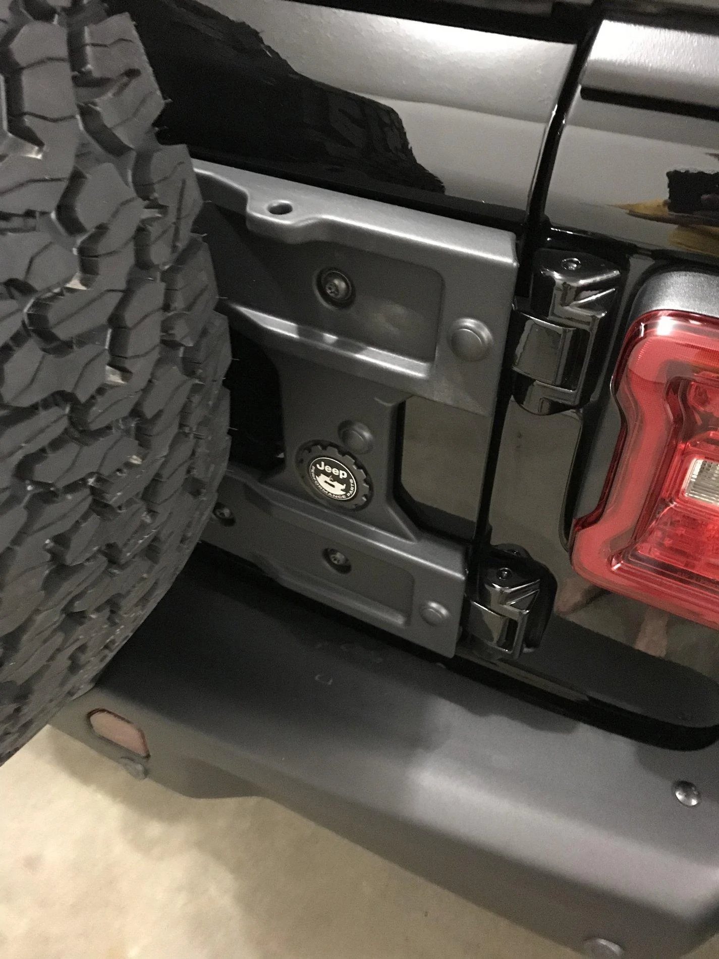

Jeep Wrangler JL CB Antenna Mount Needed! 19F33767-8B37-41F6-98F2-D05A68E02F0B
Jeep Wrangler JL CB Antenna Mount Needed! 9DE29803-3DD7-4544-91A2-A8FC538D121F
Jeep Wrangler JL CB Antenna Mount Needed! 2F32E1D1-3527-4BC9-8006-55A2BC0F65D2
I’m going to use this hole in the Mopar tailgate reinforcement for my antenna until somebody release a spare tire bracket for the JL with an extra hole for the flag. Does anyone know if the JK grab handle microphone mount will work on the JL?

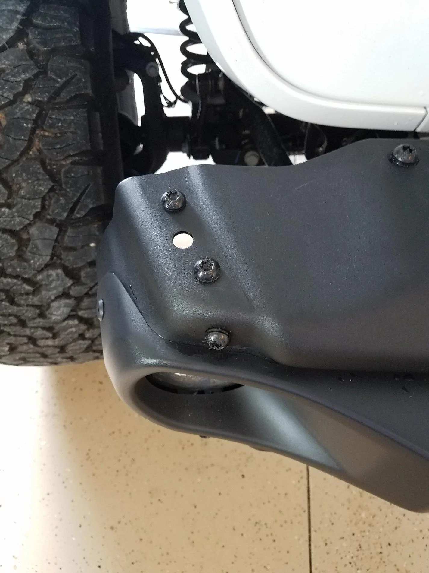

Jeep Wrangler JL CB Antenna Mount Needed! 20180221_111307
There's also a mounting point on the passenger side of the front, Steel bumper when you remove the end caps. I didn't go that direction but I'm definitely running a trail flag off of it.
