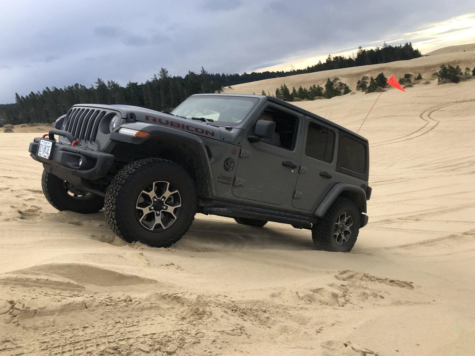

So my JL unlimited Rubicon is currently stock with original tires. I drove her on the dunes yesterday pretty hard hill climbing and joy riding. Ran at 15 psi. I could feel the shocks/suspension "bottom out" when i would hit ruts and dips at higher speeds. The jeep drives perfect on the road and i do not wish to do any mods that might change geometry or the current stock road ride but was thinking that a different set of shocks might be the solution to the bottoming out occurrences while out duning. Any thoughts or recommendations would be appreciated. @American Jeeper
I would say that it may be an issue of the JL itself not really being meant to do dune buggy type-jumps. Shocks and springs will help, but unless you have a lift and longer travel shocks/stiffer springs you may still run into the same issue. How fast were you going?
I will be running Radflo shocks soon, but don’t have any significant firsthand experience with them yet. I like what I see so far but I really would like to run them for a bit before I fully recommend them. I do feel like the stock JL shocks should be upgraded, and Radflo seems like an excellent choice.

I have an auto and ran in 4H (1 & 2), hill climbing speeds of 30-45 mph. After reading more today i see that it may be a spring issue as well and perhaps a dual rate spring might do the trick.
You are talking about turning the JL into a whole different animal to handle that long term. It would be sweet to see it! A lift would help you have more travel and the shocks should match the springs.
