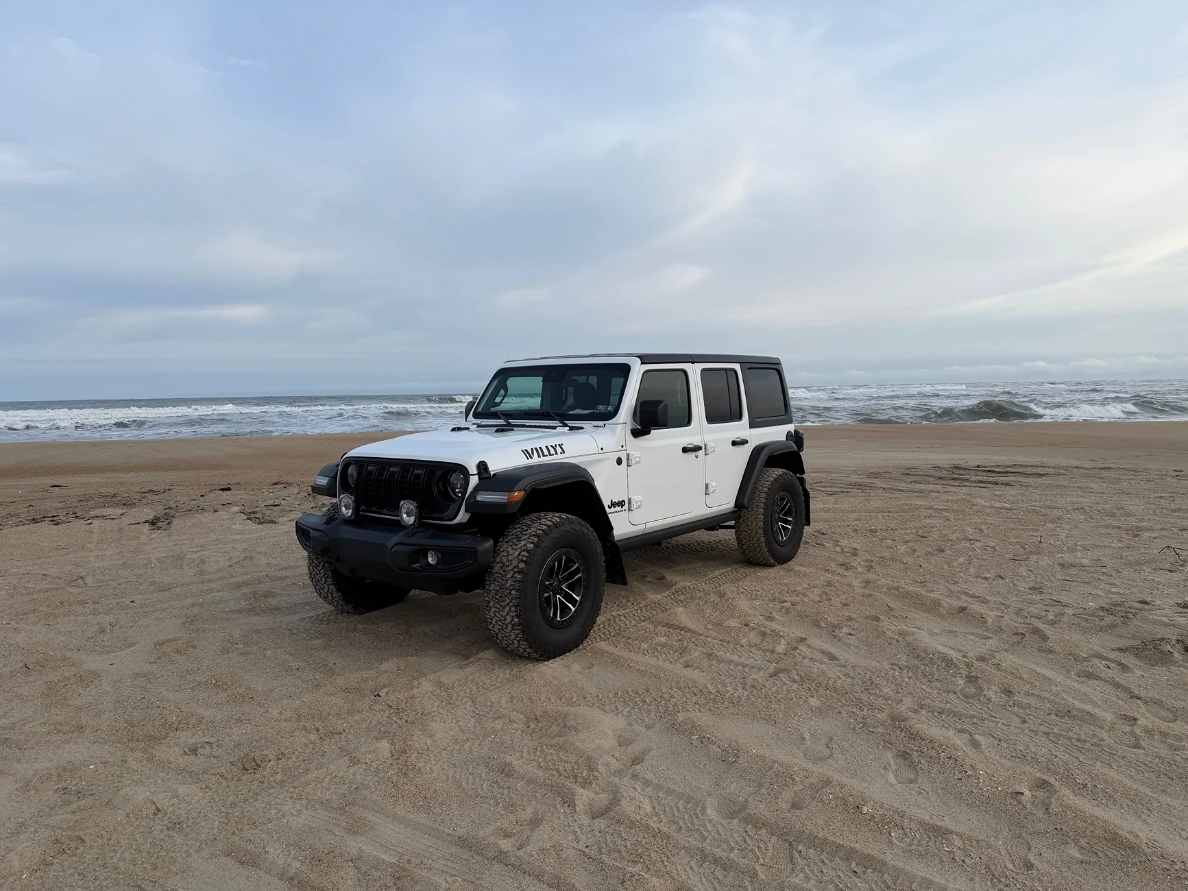

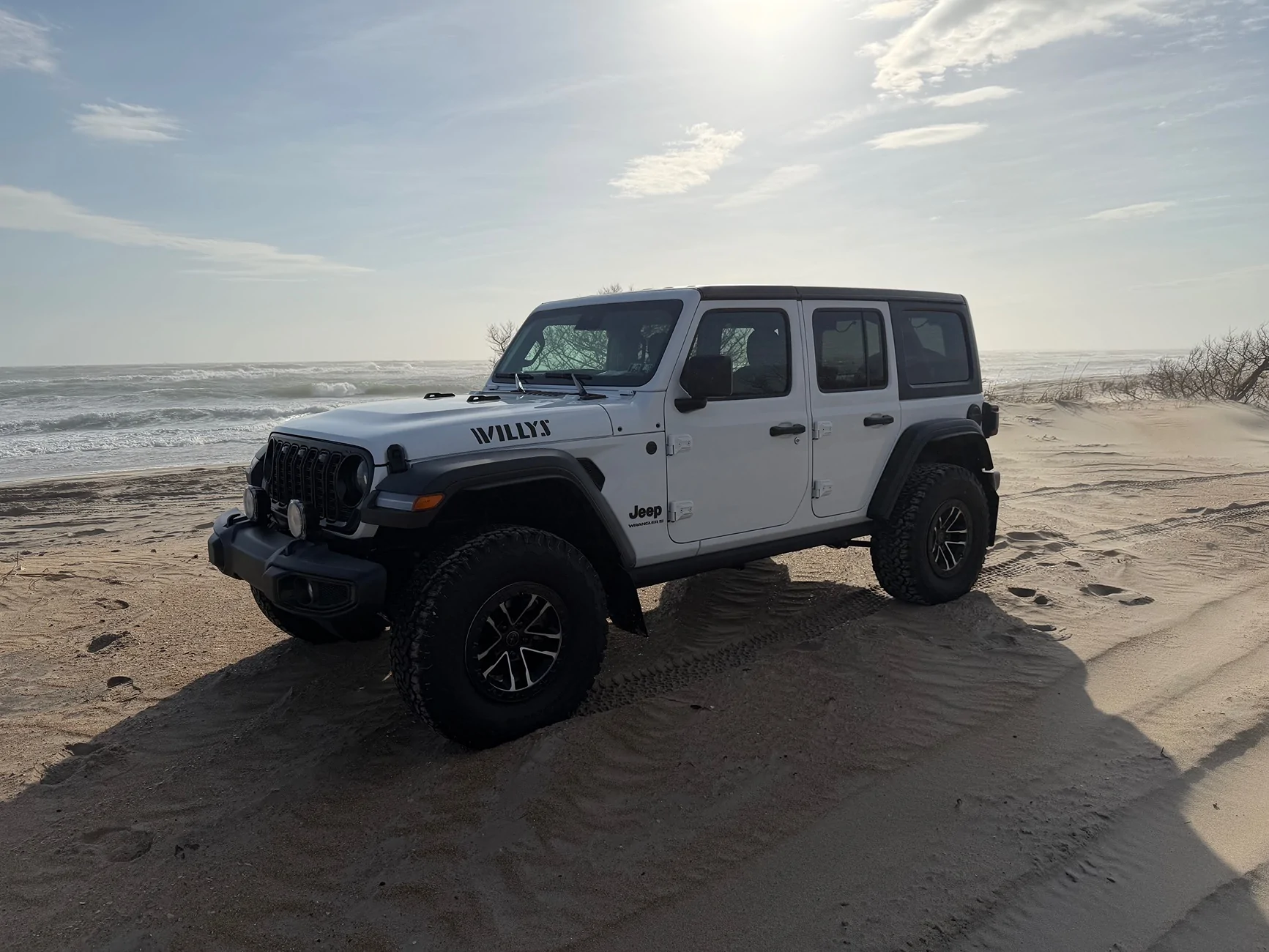

OP, beach running shouldn’t require disconnecting the sway bars as you shouldn’t be putting the suspension at full articulation like in slower speed rock crawling. I’d suggest some Bilstein 1500’s sized to your 3” lift height to firm up the ride at speed over the sand. They will also perform well on road. I particularly love beach running 👊🏼🍻
