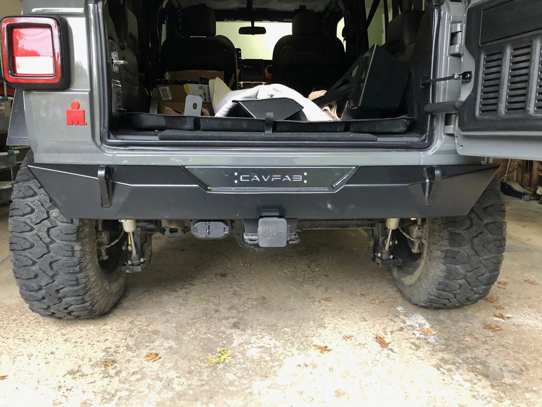

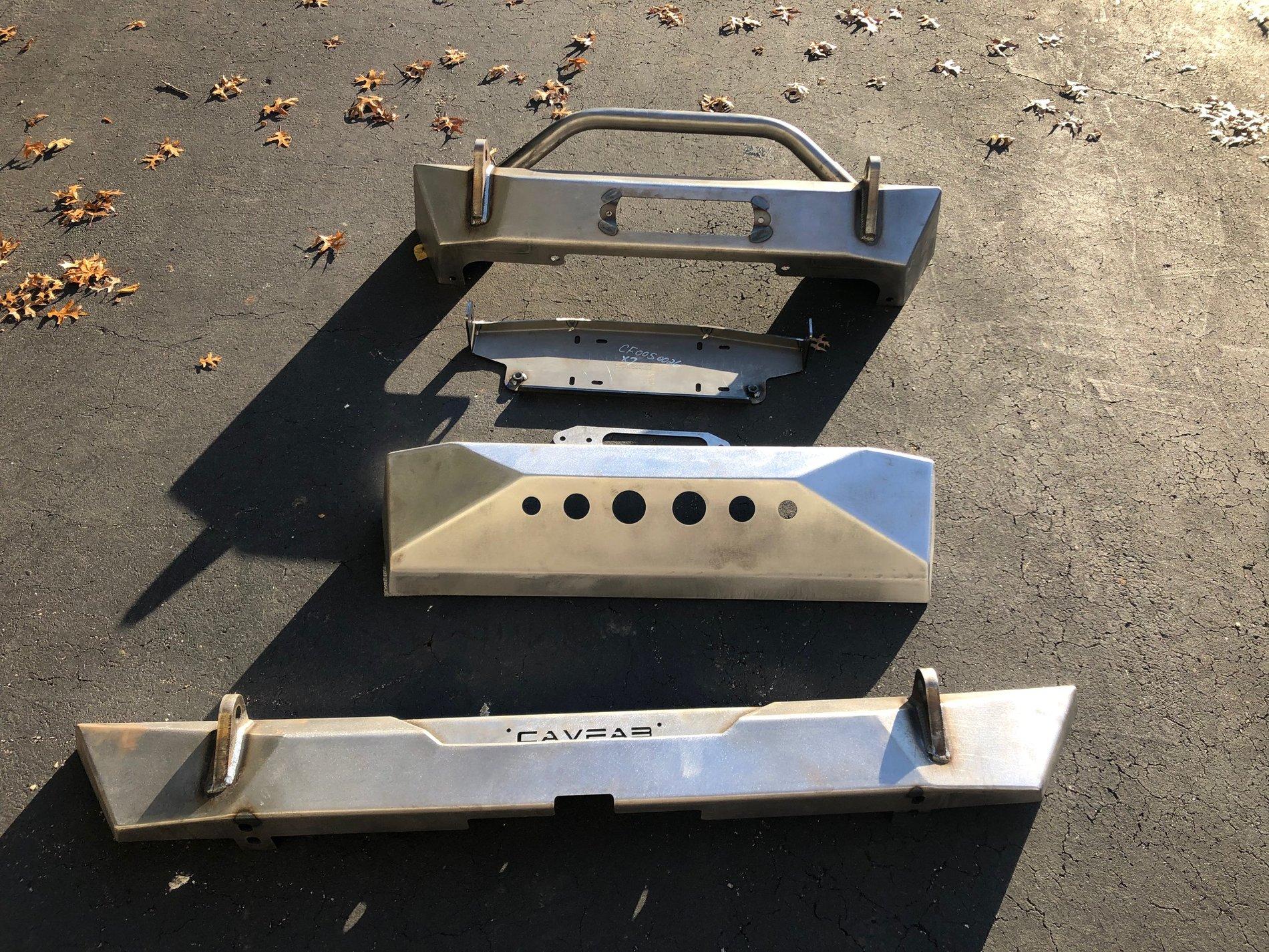

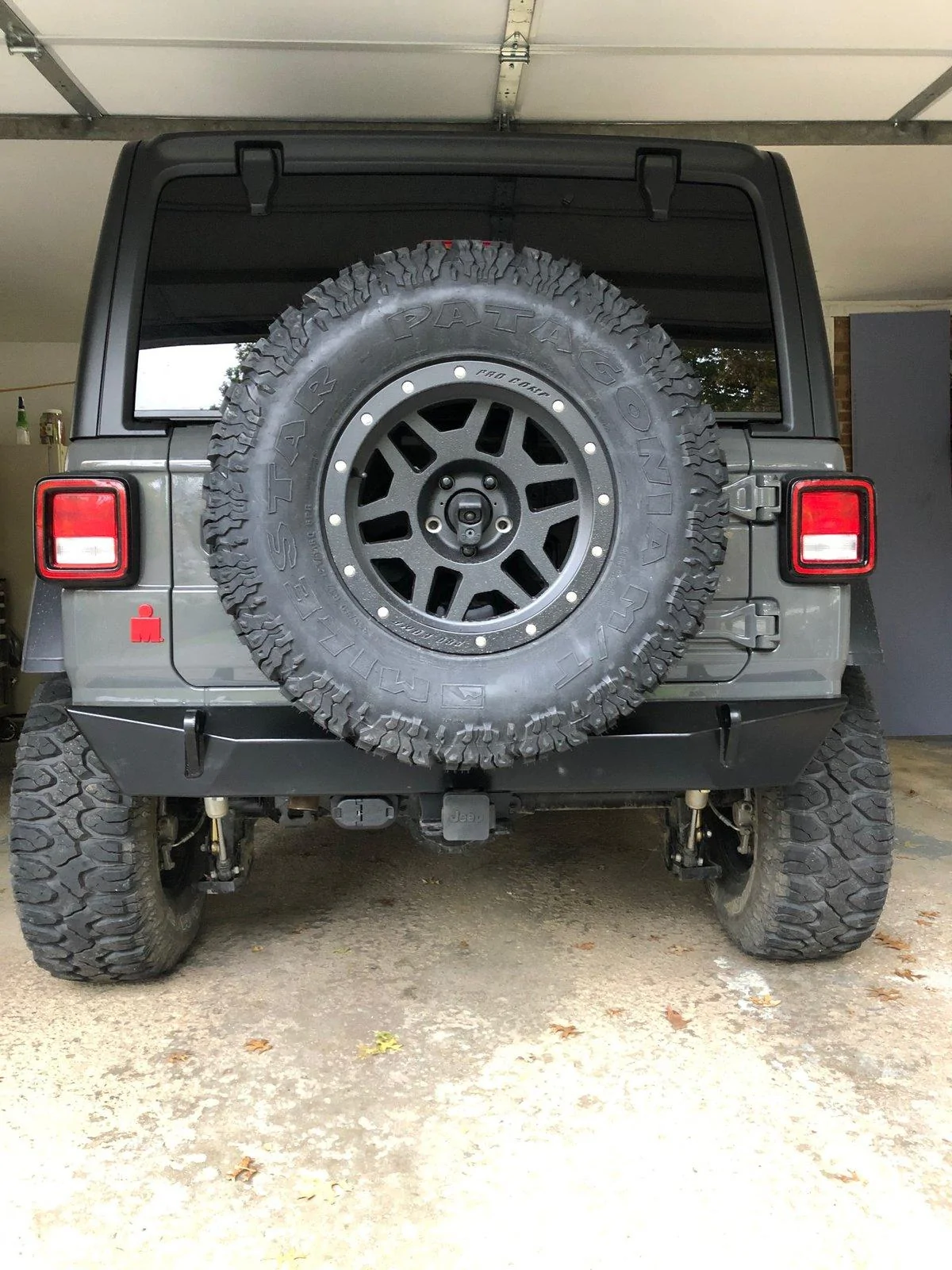

These babies just arrived yesterday. Cavfab Predator Front Bumper with Winch Guard Hoop and Skid Plate. Accompanied by matching Predator rear. Very happy with the craftsmanship.
Already dropped at the powder coater this morning.

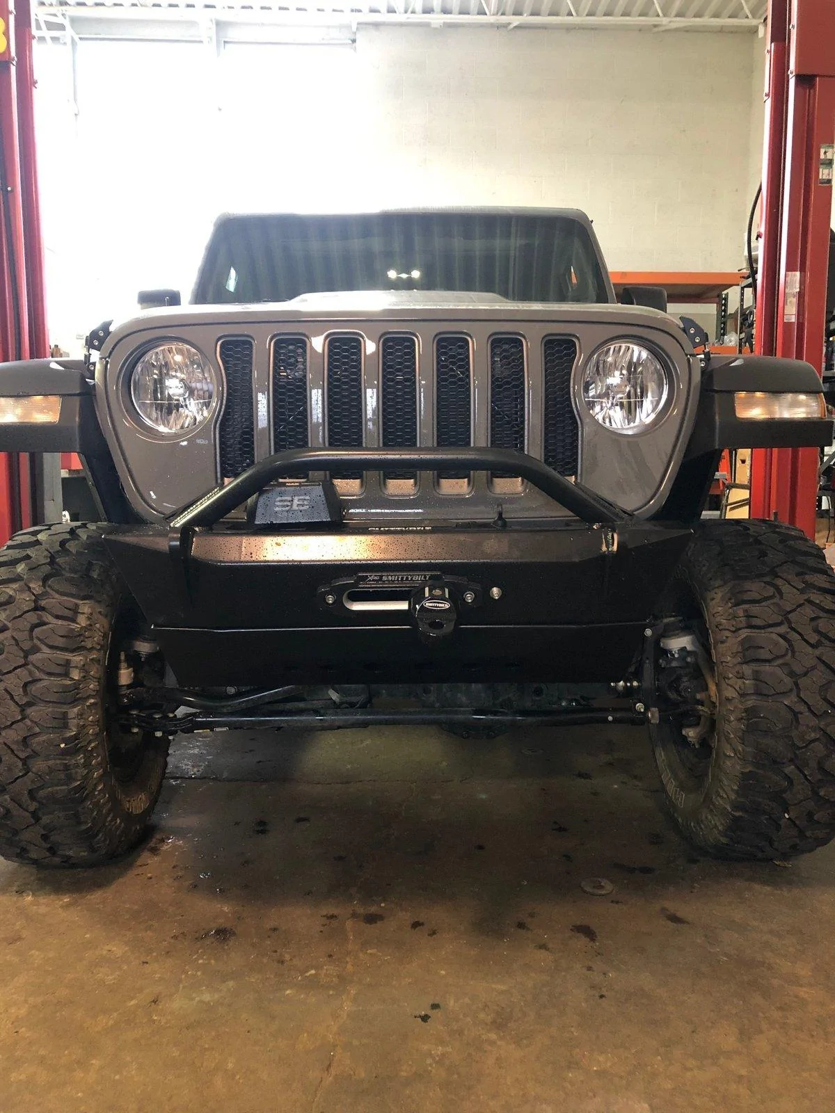

Front bumper and skid plate are on. The fit of everything was great. However, getting a winch in there was a major PITA. There is barely enough you to squeeze it in. I had the grill off so I didn't damage it, but then I couldn't get it back on. Then I moved the controls to the left to eliminate some of the bunched wiring behind. I had to basically mount the winch plate and winch to the bumper and then mount it. It worked out great but it is really wedged in there.

The factory bumper had a side mounting plate on each side of the frame rails. I removed them and installed the LOD support brackets to strengthen the bumper to frame connection with two bolts instead of one. Also, the winch plate rear bolts connect the rails so the bumper/frame connection is extremely strong.
