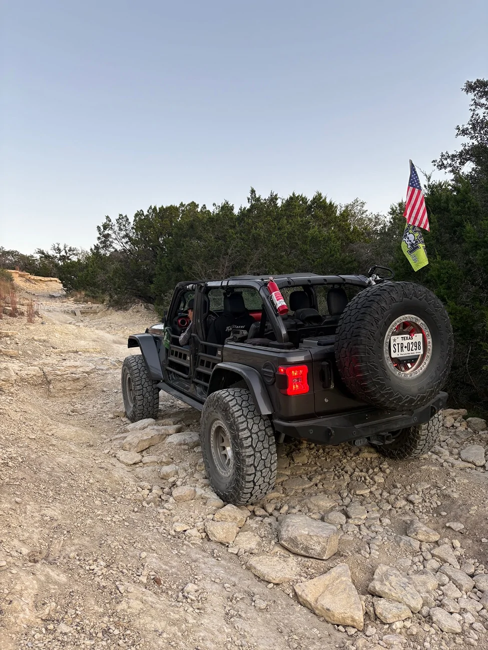

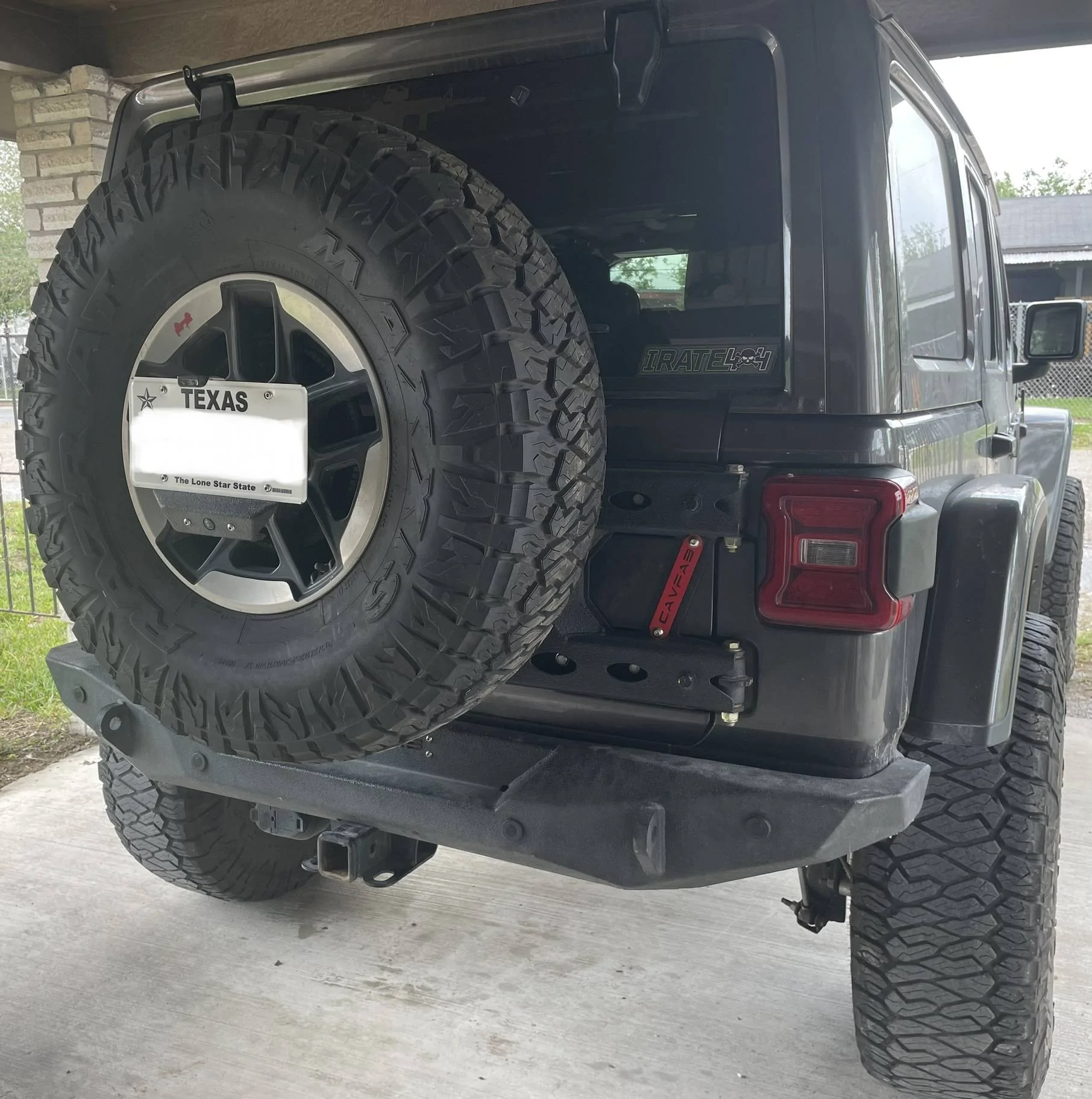

Finished mine up. May move over to the recommended deutsch connectors from above with 2 or 3 pins. Maybe a project for a later date. Opens and closes perfect No adjustment needed

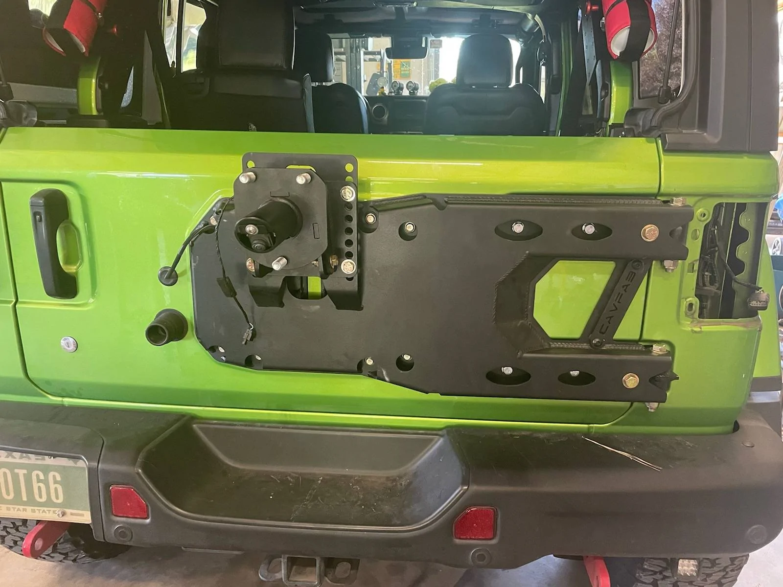

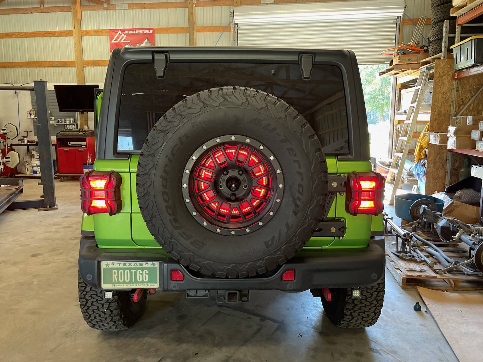

I went a slightly different way with my CavFab. Since I have the OEM steel bumper I did not relocate my license plate and I also did not want to have to remove or replace anything when I have to pull the spare.
To that end, I went with LOD camera relocation kit and it turned out really clean:

Were there any fitment issues using the LOD camera relocation kit when installing? I just got my CavFab tire carrier installed after it spent close to 2 years in my garage waiting on me to get it powder coated, but now that I have it mostly installed, without the license plate relocation bracket and camera mount, I think I'd like to go the same route you did.
None, you just need a longer bolt and a large fender washer that is at least 1/8" thick as a backup plate on the back side of the bracket.

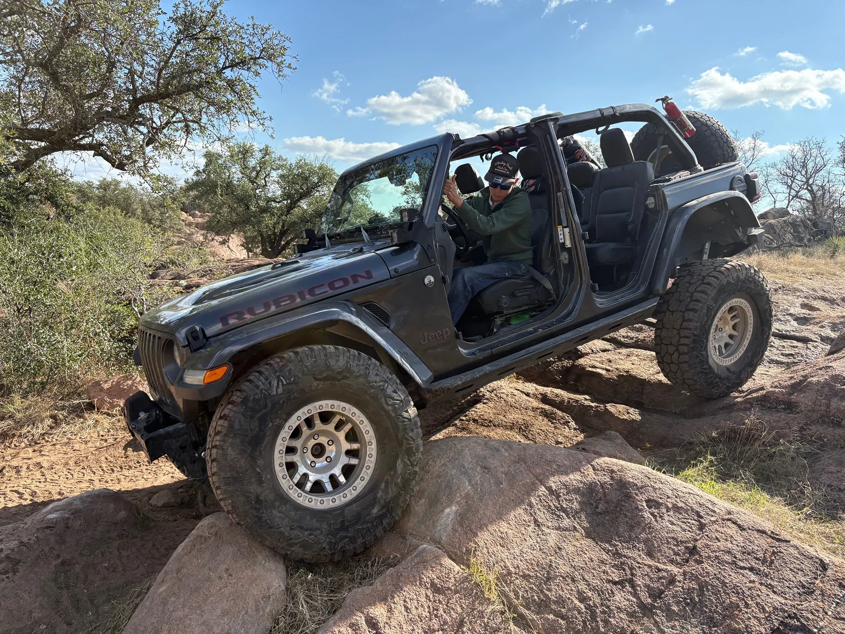

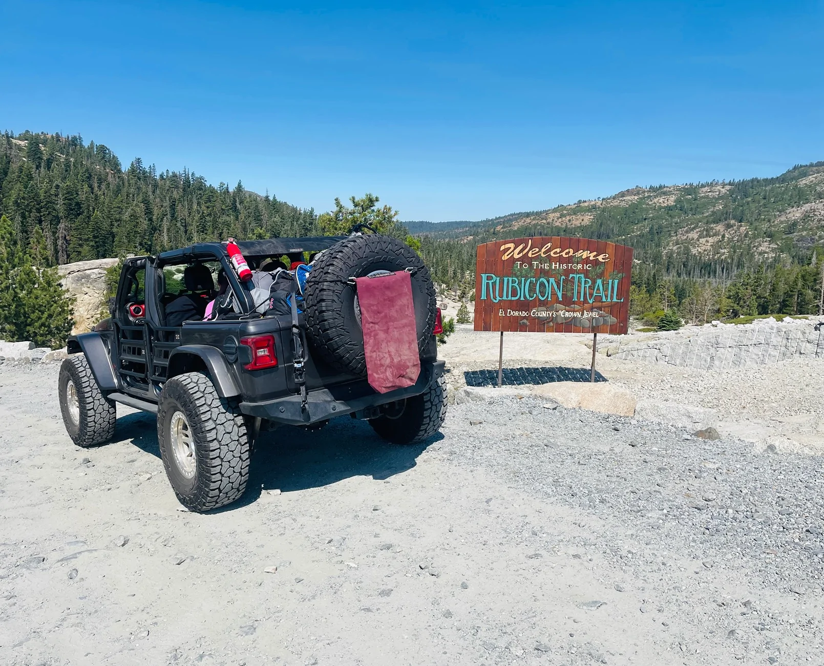

Pick the one you like. You’ll be happy with whichever. I’ve done some hard wheeling with my @CavFab_mfg bumper and tire carrier. Rubicon, all around Texas. About 50k miles on the setup that I removed from my previous JlUR. About two weeks ago I did a tire rotation and noticed my spare was loose, the bracket had loosened all around carrying a 37 and now 38s. Understandable. Tightened it all up and all good. I noticed recently the tub is slightly rubbed off where the rear bumper is. I’ve seen some max articulation on my jeep so I can see that happening. I plan to tighten up the bumper bolts up soon too.
