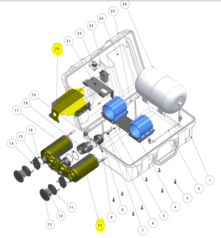

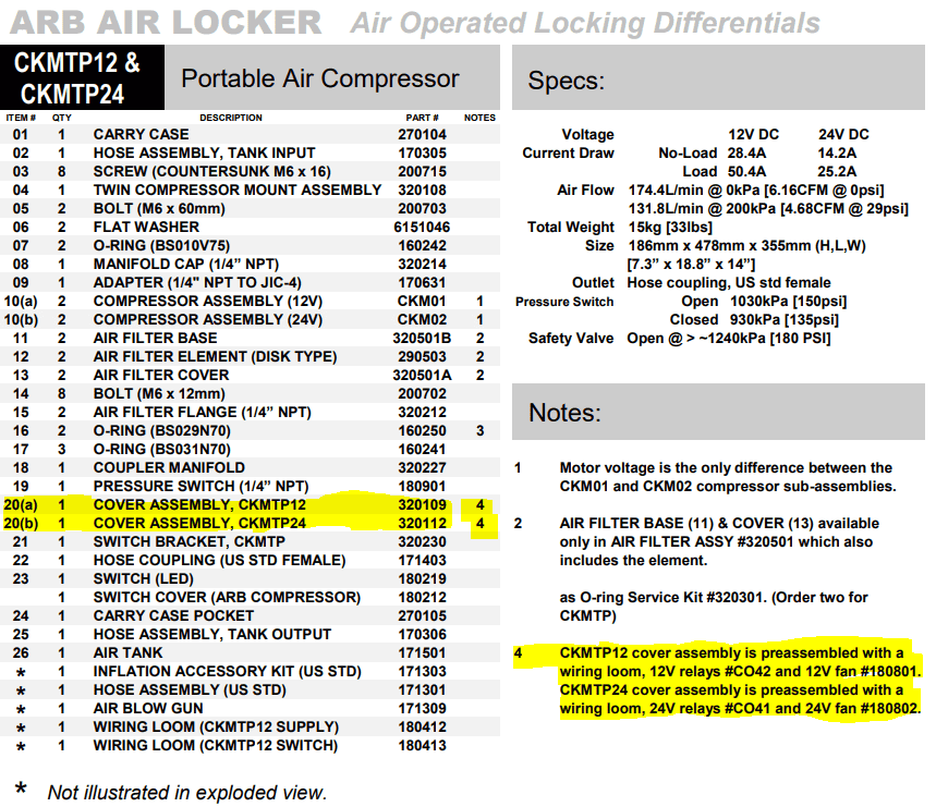

Looking into the details of the compressor versions I noticed that the 12v and 24v versions have Relays and fans that are specific to the voltage... as noted by note number 4 in the first page of this document:
https://www.arb.com.au/assets/air-lockers/3-07.pdf
Jeep Wrangler JL Can an electrical guru help? 1704326922462
That means you need to get (from image above):
10(a) Compressor Assembly (12V) Part number: CKM01
20(a) Cover Assembly, CKMTP12 Part number: 320109
I found the Compressor assembly for sale... but not the
Cover Assembly... I guess one option is to disassemble it
and replace the relays and fan with 12v versions
https://www.polyperformance.com/arb...K3HMt2QiWLSqV_gW0vrf7xQq0py_9wIBoCdlMQAvD_BwE
Part are highlighted on image below:
Jeep Wrangler JL Can an electrical guru help? 1704327113929
Good catch. The footnote has the relay and fan part numbers in it. Looks like the relay is pretty common online.
The bad news is that item 10 is only ONE of the two motors. Per ARB's email I need x2.
My bargain 24v compressor is no longer a bargain :(
