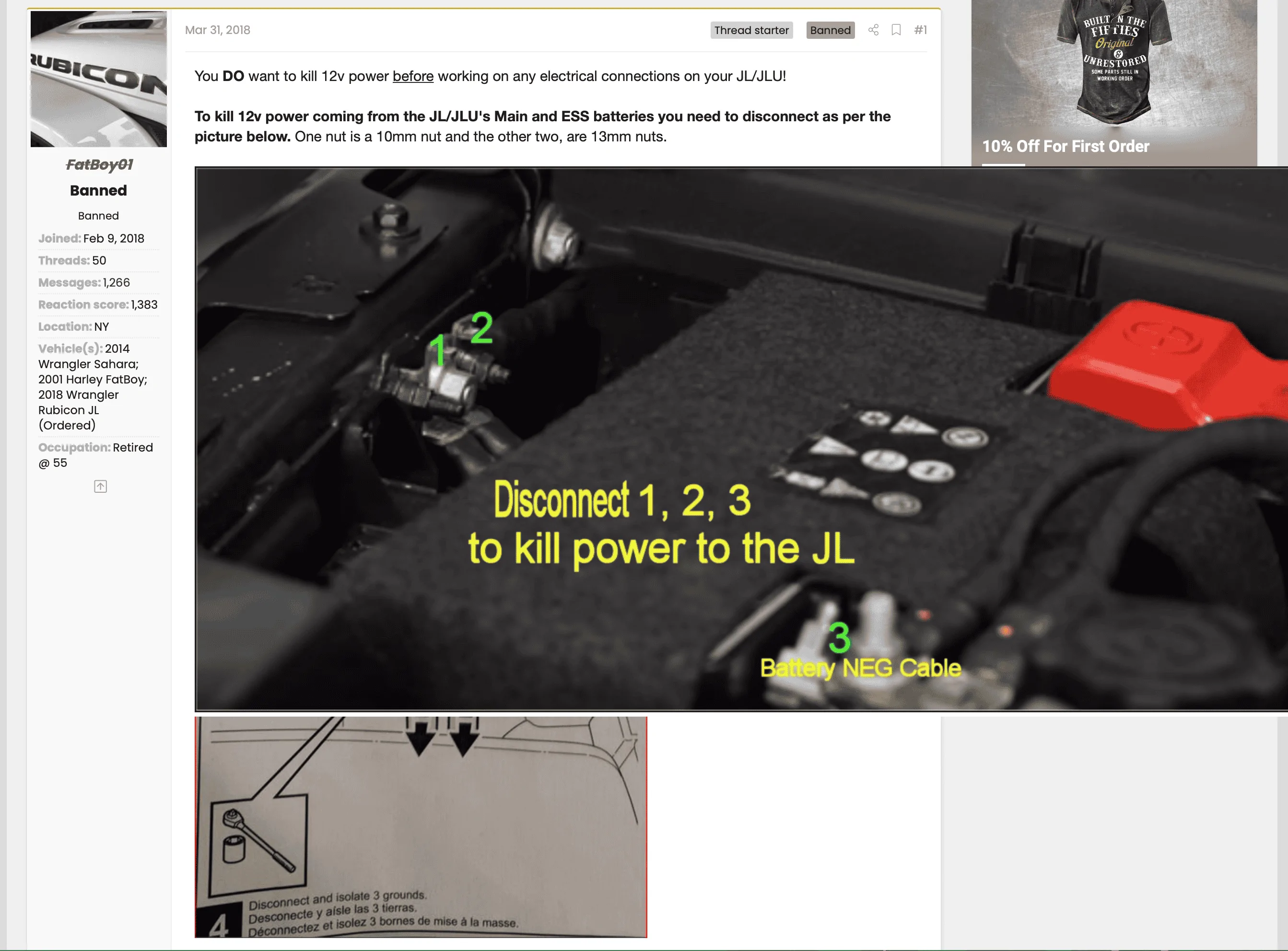

I read the link for: You DO want to kill 12v power before working on any electrical connections on your JL/JLU!
and I removed all three one 13mm from neg side of battery and the 10mm and 13mm on the fender,
Now I put the one on battery back on the the other two and it sparks and makes a noise, so I quickly remove the 10mm and 13mm

@4x4snowmachinejeep
I encourage you, when you do want to do a total 12v power kill to do it as mentioned below...
Also, that spark when you reconnect is normal to see with your JL/JLU.

Hi
what should I do??
thank you
That looks like a post by a banned member. Not sure why he is saying that. Makes no sense whatsoever.
