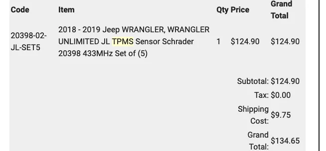

Bought these from TPMSdirect.com to go in my wife's new beadlocks. I called them and they told me that Schrader is the OE supplier for Mopar's TPMS sensors. Sure enough they looked right and worked perfectly requiring ZERO screwing around. The computer picked them up instantly.
Basically $25 a piece vs. who nkows how much for factory ones.

So if I read this correctly. You installed them on the new wheels and the Jeep automatically sensed them and assigned them to the display?

Correct. Bought a tire stem install tool off amazon and they popped right in and by the time I backed out of the driveway they were being recognized by the computer. That's exactly what should have happened since they are OEM supplier. All it does is emit a frequency and the computer is designed to read that frequency. Any vehicle that is tuned to that frequency will read them.

Thanks, that clears up a lot of questions.
