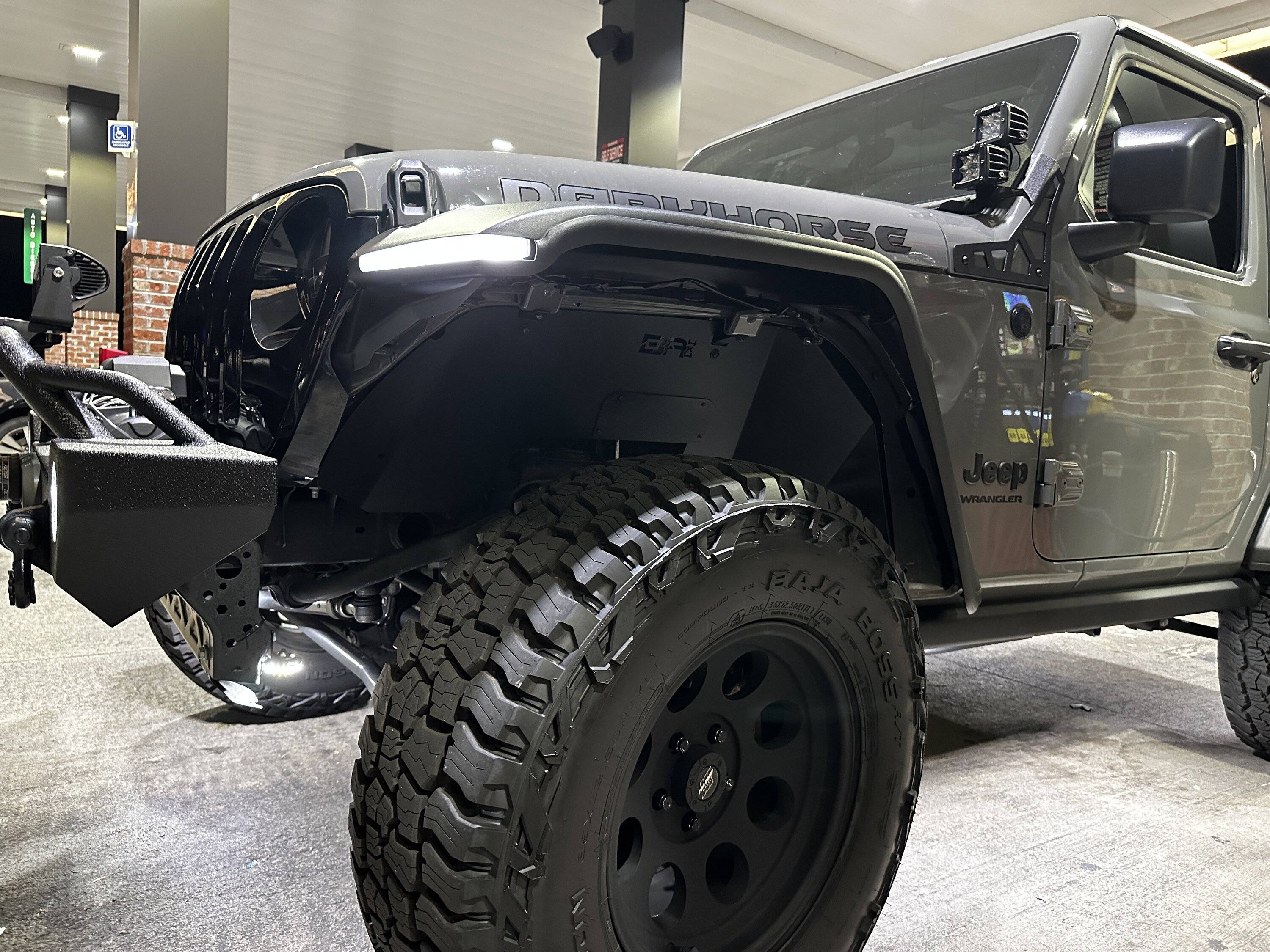

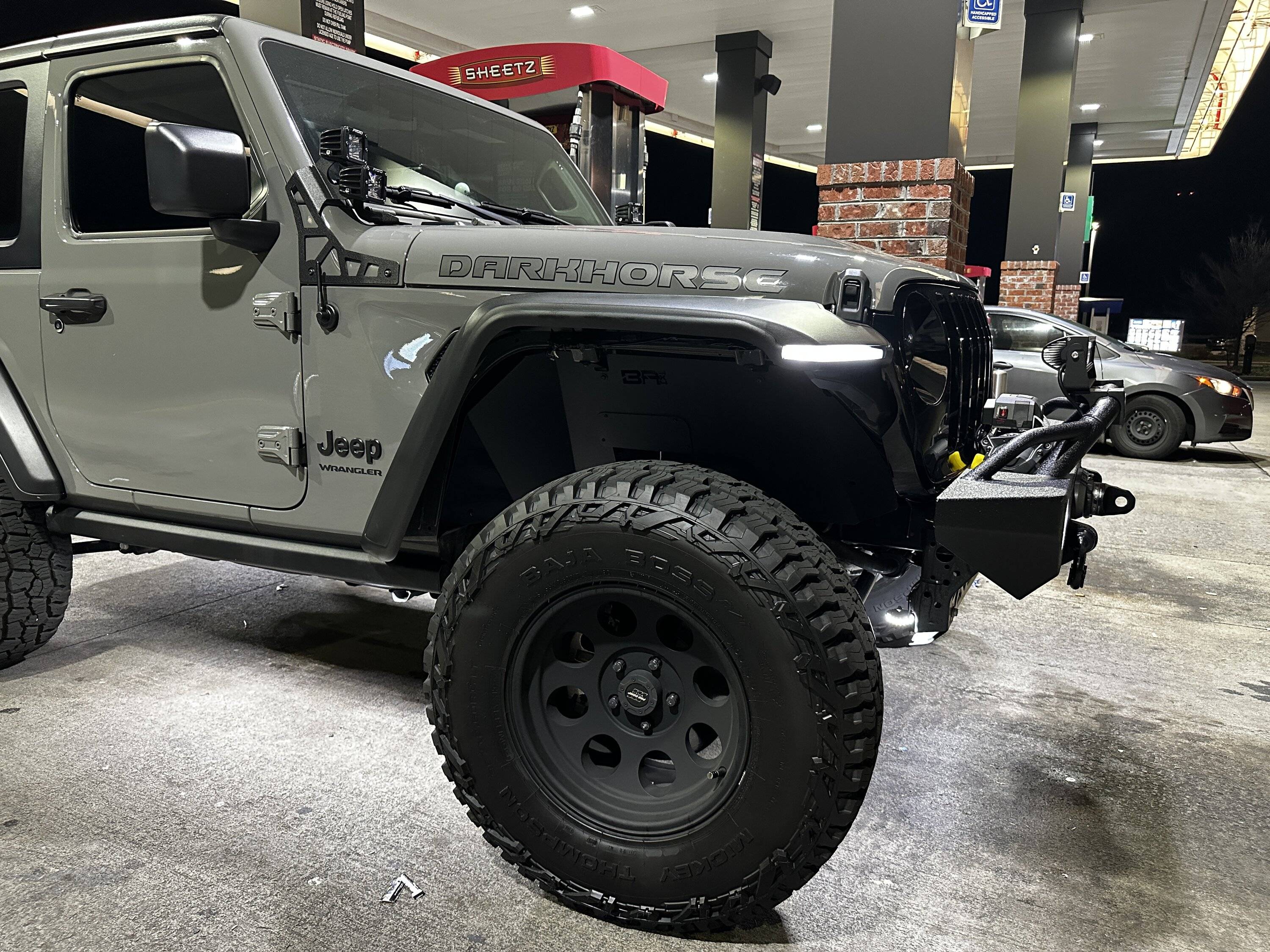

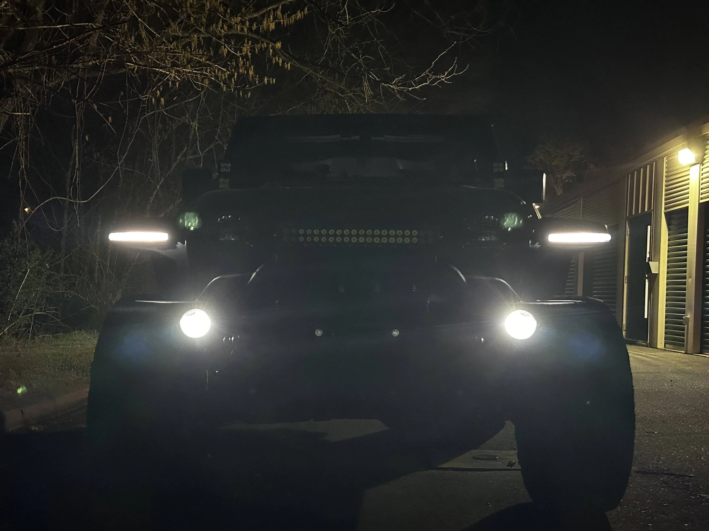

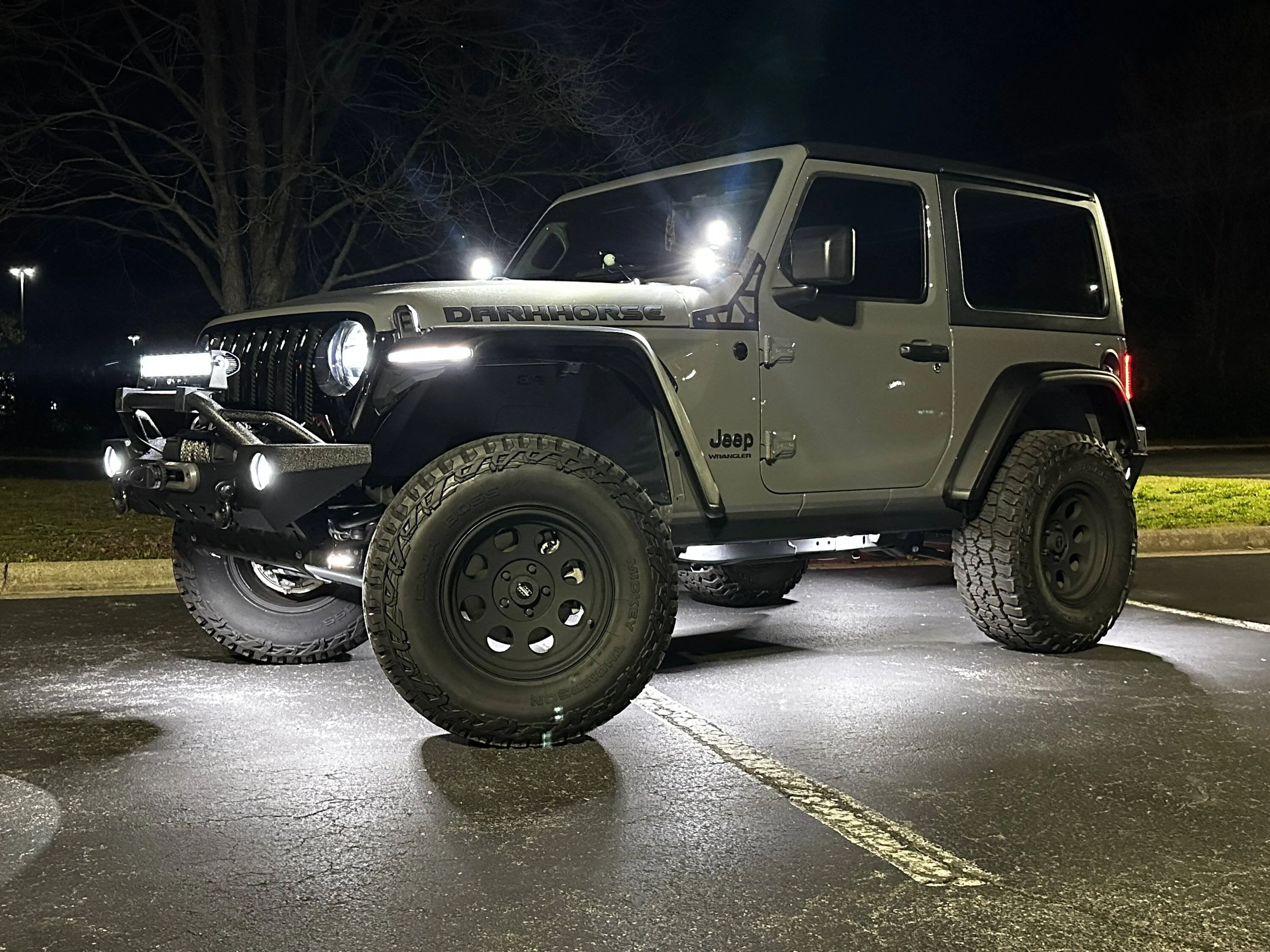

So this weekend, I installed my new fenders and fender liners and had a buddy of mine come help who runs the Max Terrains. Here’s the end result and a good comparison for everyone that is either deciding or worries about quality….
today, we went off roading on a fire trail then a back woods that was full of rocks, water crossings, deep mud and a tremendous amount of gravel that shot up and broke his mirror.We laughed only bc he had bought the new Oracle mirror mounted light bars and hadn’t installed them yet so he just damaged his factory mirror not the expensive new ones. (Thank God.)
Anyways, Friday and Saturday morning, we installed my fenders and wired up the new DRLs… took us roughly 3 hours to pull fenders, install the liners, mount up the BW fenders(front and rear) then wire up the lights as well as clear the codes via TazerJL so no hyper flash or “bulb out” warnings.
as we were doing this, we both noticed some particular, yet interesting “finds”. Yes, the RR are about $100 more versus the $600 for BW… he still has his full instructions incl the LED DRLs wiring info. Stamped on the fenders and various brackets on both our Jeeps was “Bushwacker” and part numbers matched except his had “RR” and mine had “BW” at the end. Both directions were the exact same except for the header and footnotes. But what really stuck out was even though his DRL mounts had the “Rugged Ridge” stamp and mine has “Bushwacker”,the only difference was that my DRLs are tinted and his aren’t but both had “Rugged Ridge” embossed on the light housings. At first, my fenders, once the engine got to temp and idled, were flimsy right at the grille when we went to dinner Friday but once we mounted the DRLs, they were very sturdy and rigid. So as far as the price discrepancy, that was the only difference, other than that, they are the same down to part numbers and even the customer service chat forum used the same interface (we ran into a small hiccup when it came to directions for the mount closest to the door in front since the part and holes didn’t exactly line up per the directions included). Basically, after some extensive research, we found that it’s the same parent company.

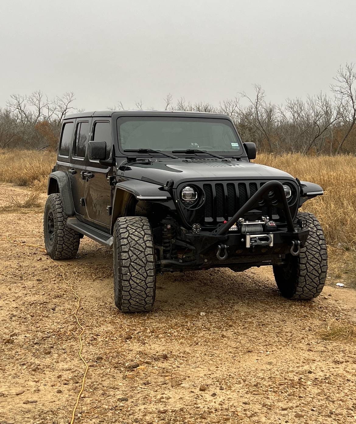

Not to change the topic, how you liking those mickeys? i’m beginning to get into the rabbit hole of searching for different tires, looking at ridge grapps or those baja boss at. And they look aggressive like an RT so it’s appealing compared to my klever rt.
Im pretty happy w/ my ridge grapps, they handle dirt rds better than my RT’s and wet pavement pretty great too and miles anove the bfg km2 it had

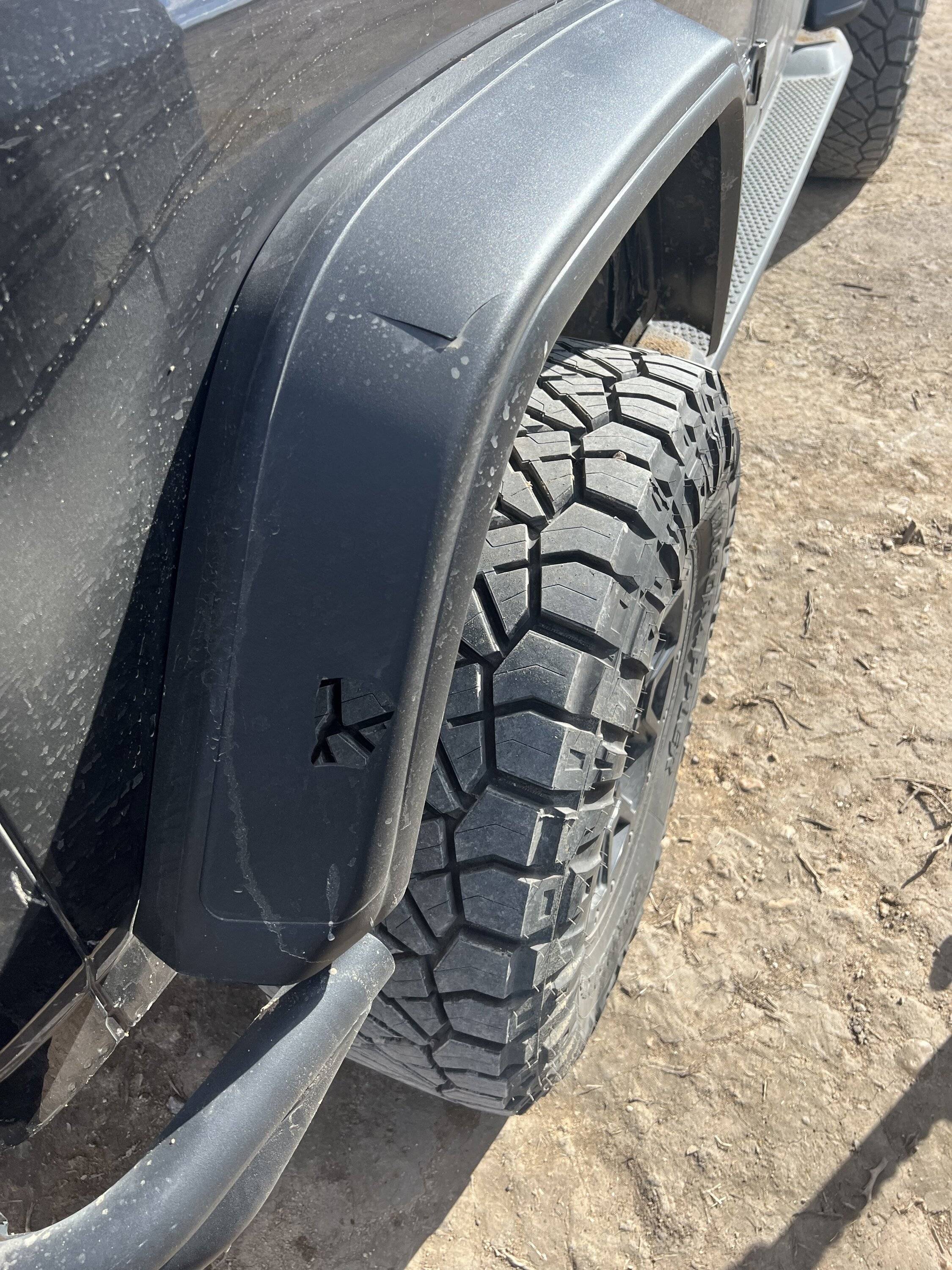

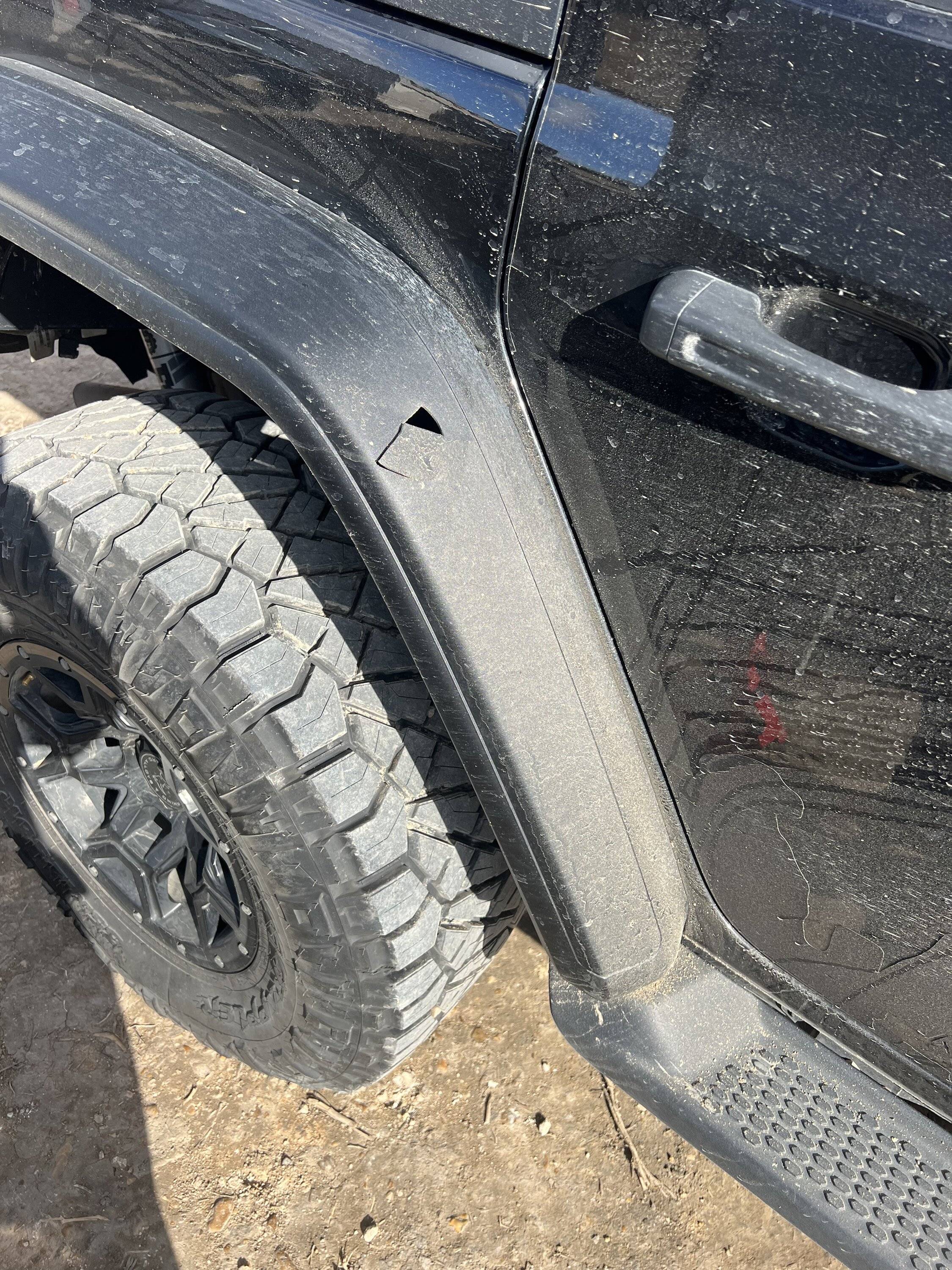

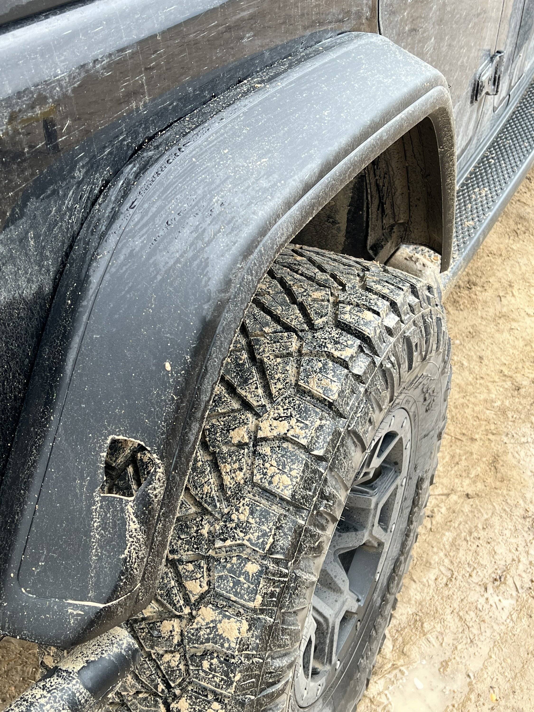

I have read through the threads discussing Bushwacker Hyperforms and everyone is generally happy besides the floppy fitment and gaps. I worked hard making everything as tight and aligned as possible and was really happy with them. 3rd week i had them it rained one morning and I was driving down a county rd i travel often and naturally mud and small rocks stick to tires and sling off. I was happy to have the extra coverage to keep the mud and debris from slinging all over my jeep like before with stock fenders. When I got to my destination I noticed holes in every fender from rocks slinging through them like they were shot out a gun???! I never went over 30mph and I feel like common expectations is for these to do their one job and deflect debris and stuff from hitting the paint or other vehicles.
has anyone else experienced this and did bushwacker do anything to help? I reached out to customer service 2 times and sent pics with zero response. Its been another 3 weeks since I contacted them and nothing.
anyone else get bushwacked by these weak floppy fenders??
First they are FENDERS, their job is to PREVENT mud, rocks, gravel etc from hitting the sides of your vehicle. So Job 1 they failed at it. The fenders did not perform as sold.

The plastic they used was substandard and did not meet even their low specs. I bought into Bushwackers, ONCE and they did not last but a few months and the plastic was failing. Then driving down the highway one broke off and the other began to follow, so I pulled over and with my hands the came right off. Guess it was that Texas sun that did it.

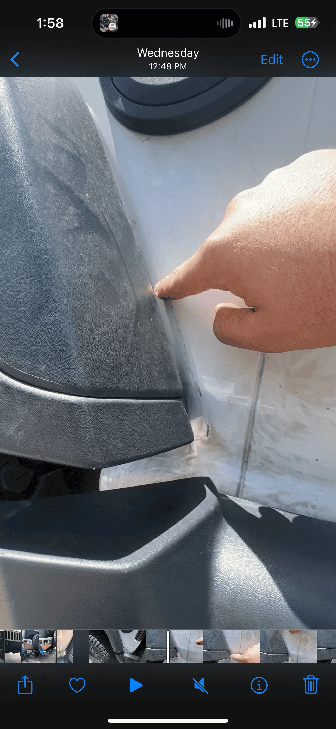

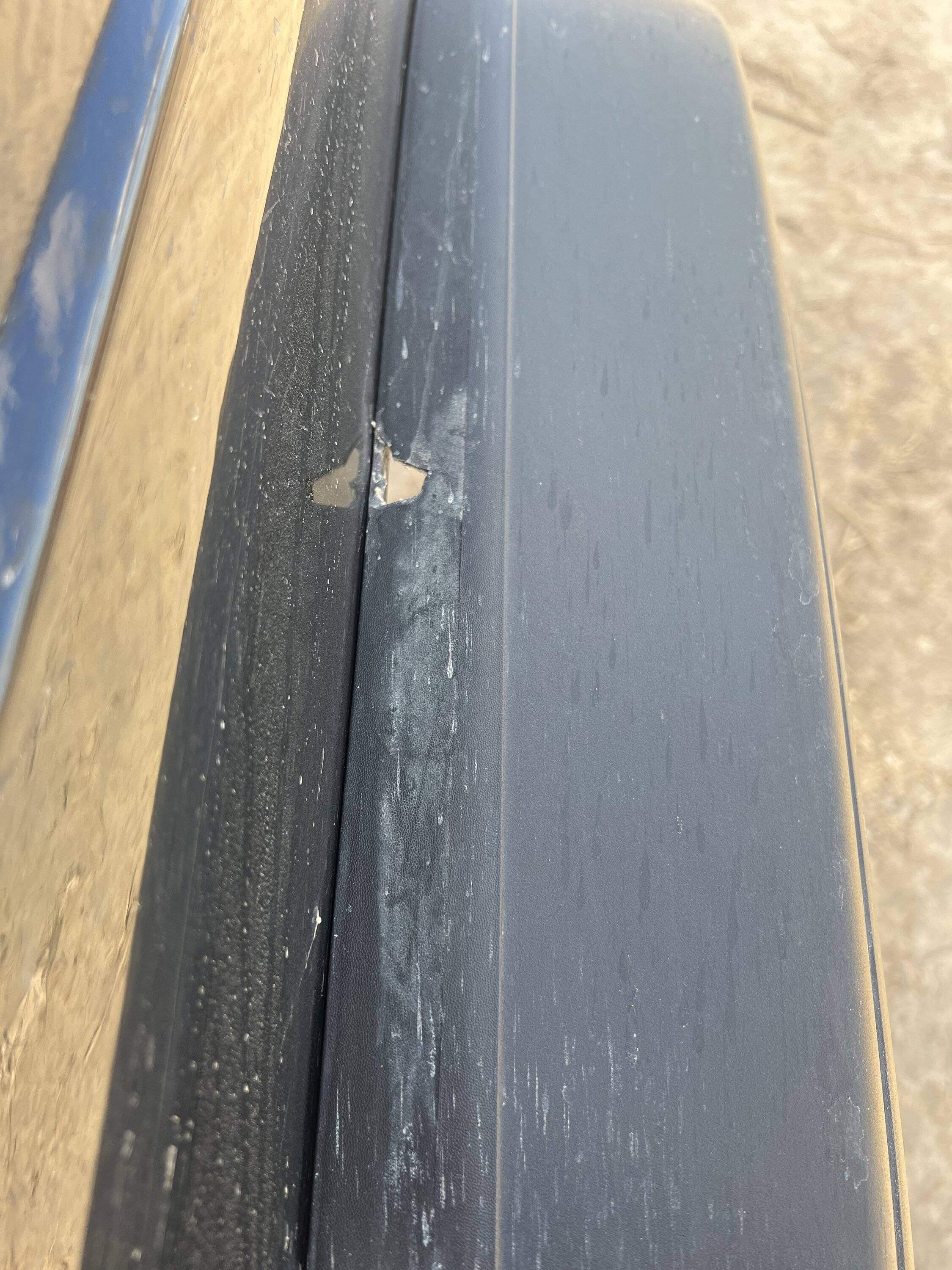

Whoever is still running these check your rear quarter panels :(
The flares vibrated enough I guess to get down to bare metal. You would think the fenders wouldn’t mess with the body. Thought I used enough of that tape they include in the packaging, but I don’t think it’s thick enough.
