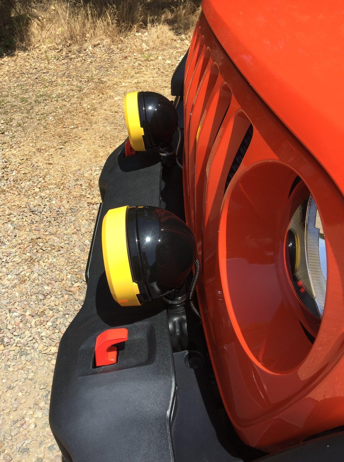

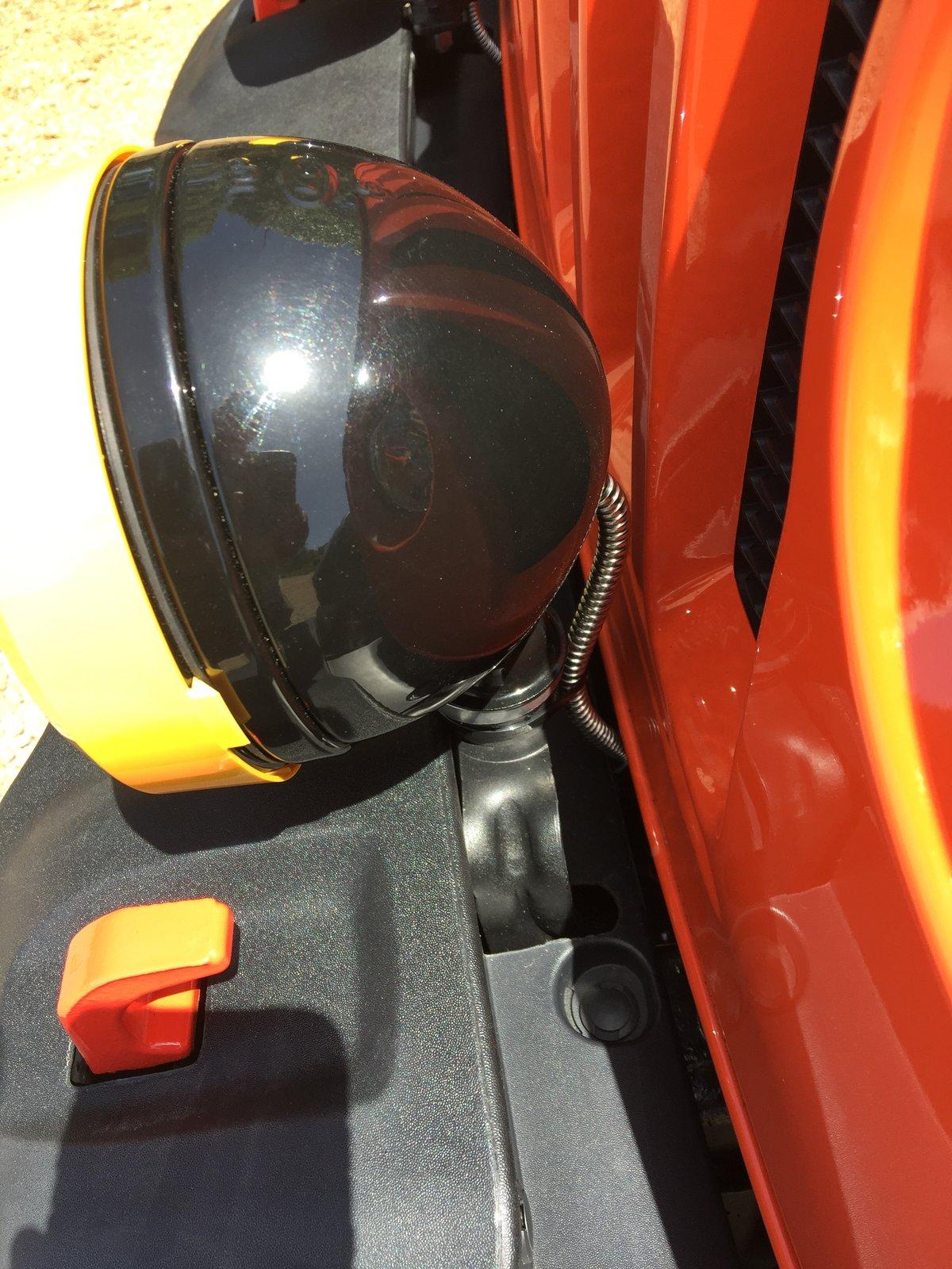

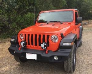

You may be referring to the Mopar bumper mounts, which actually mount to the frame just behind the bumper (see photos).
They seem pretty rugged, but the install is quite involved...you have to remove (easy) the grill for access, and enlarge 4 existing holes in the frame (Wrangler; Gladiator install is different) by drilling them out, applying rust preventative to the resultant bare metal, and installing nutserts for the mounting bolts. Also, be prepared for cutting up the plastic bumper filler, if you choose to reinstall it.
Nice mounts, but a lot of work for a Mopar accessory; hardly a ”bolt on”!
Yup, they look good (thanks for the reply) but I’m not interested in that install.
