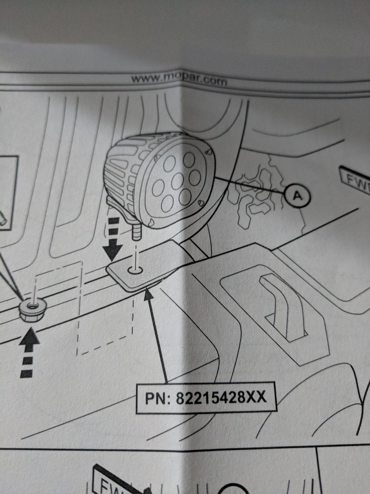

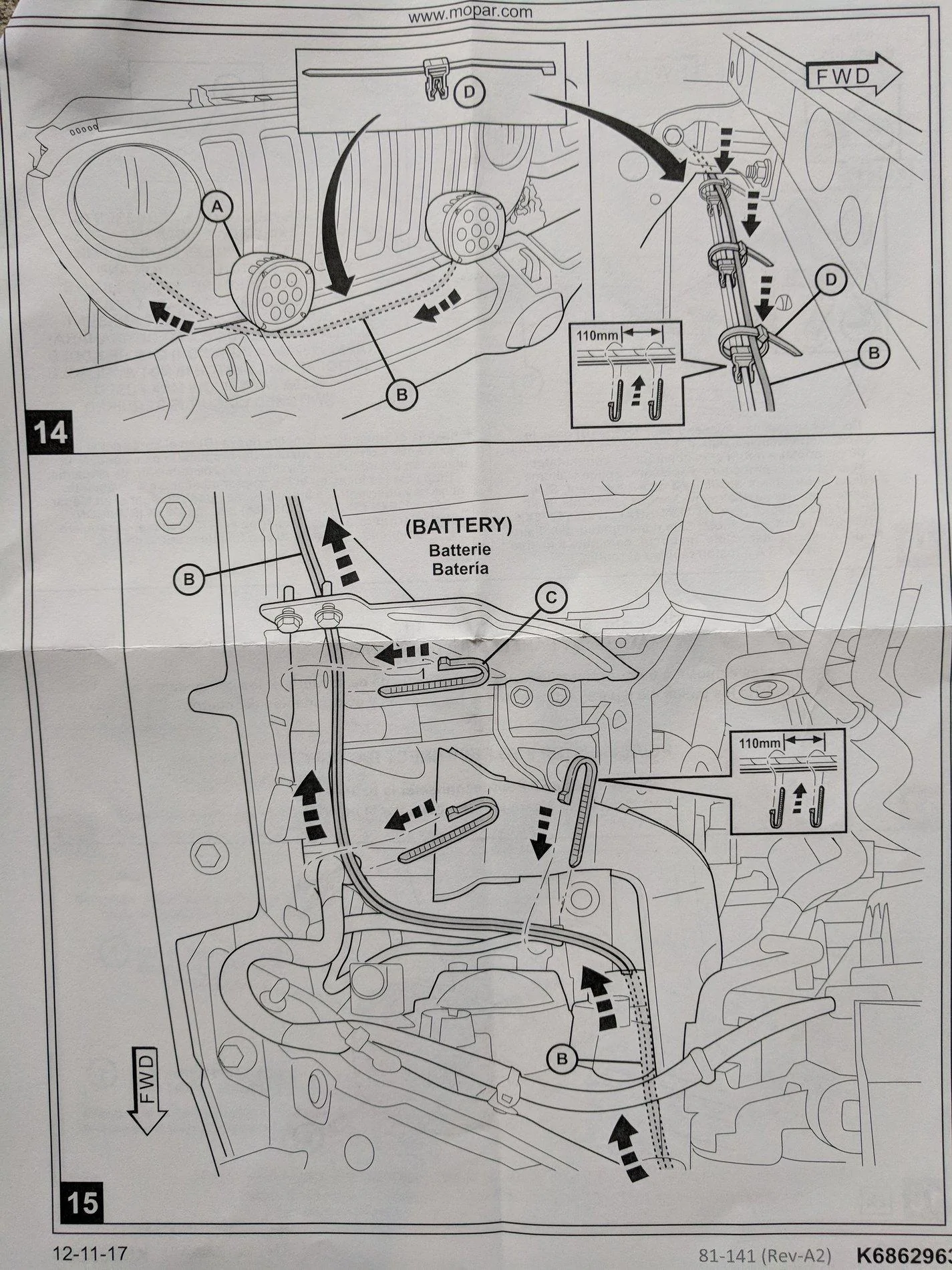

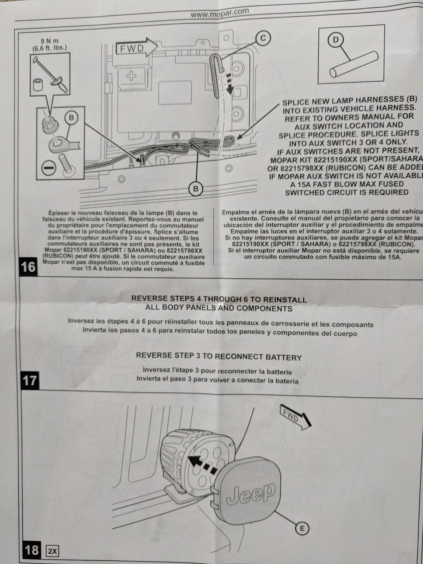

Does anyone have pictures of the best route for a wiring harness to front bumper mounted lights?
