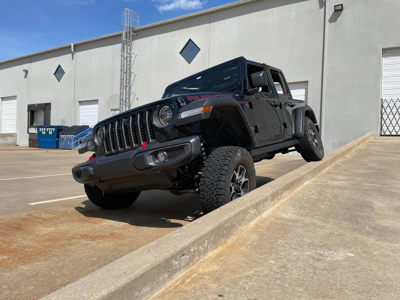

Just flex it out a little at a time and see how close you’re getting to either A. bottoming out the shocks or B. rubbing the fender liners.
This is how I checked mine when I added longer Fox shocks.

I believe this was full flex or very close to it. The upper bump stop had about a 1/2" before fully compressed. I don't think the shock was bottomed out but probably close. I'm still not 100% but I think it's good or good enough.
