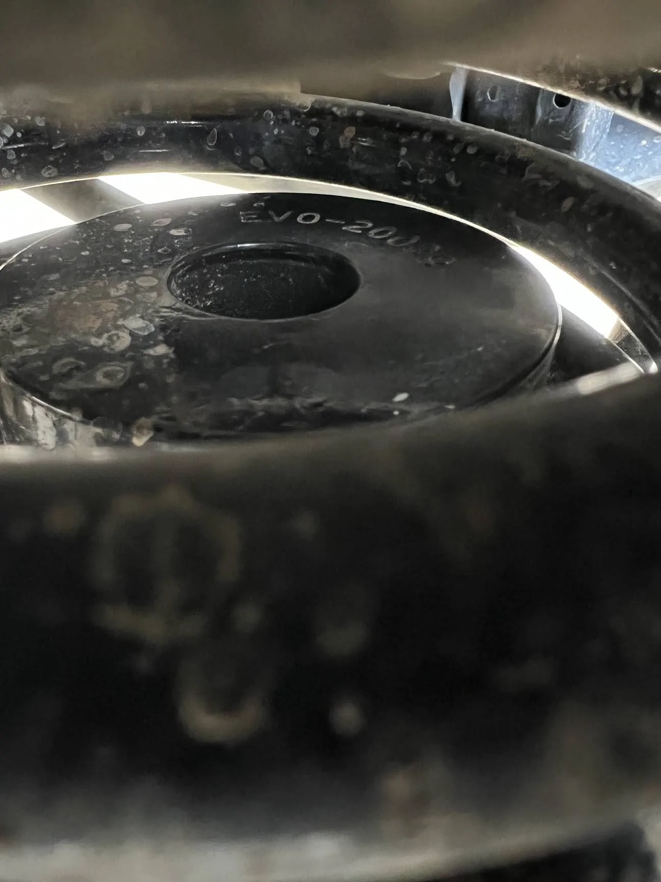

Hi all.
Trying to figure an issue out and hoping for assistance. Recently installed a Diesel specific 2.5" suspension lift kit on a '21 JLURD . The issue I am having is that I now only have 2" of clearance between top of bottom stop to the rubber cushion on the front. This is at standstill on level ground. This is allowing the front suspension to bottom out rather frequently even on minor bumps in the road at slow speed. On road its great but off road just about any pothole will bottom out even at 5-10mph speeds, definitely a solid contact of bump stop.
I guess my question is shouldn't I have gained more upward travel over stock after installing a lift kit?

Well after looking over everything and comparing part #s this is entirely the wrong kit for a Diesel front end. Spring P/N is coming up as gas engine 4.5" lift. Shocks coming up as gas 3.5-5" lift.
This makes sense so now springs and shocks have used up about 2" of travel just sitting still. And makes sense that a 4" tall bump stop came with front kit. Keep ya posted on outcome. Think going to get refund or correct kit installed - prob not EVO though unless they correct it. I kinda wondered why front spring had a curve to it.

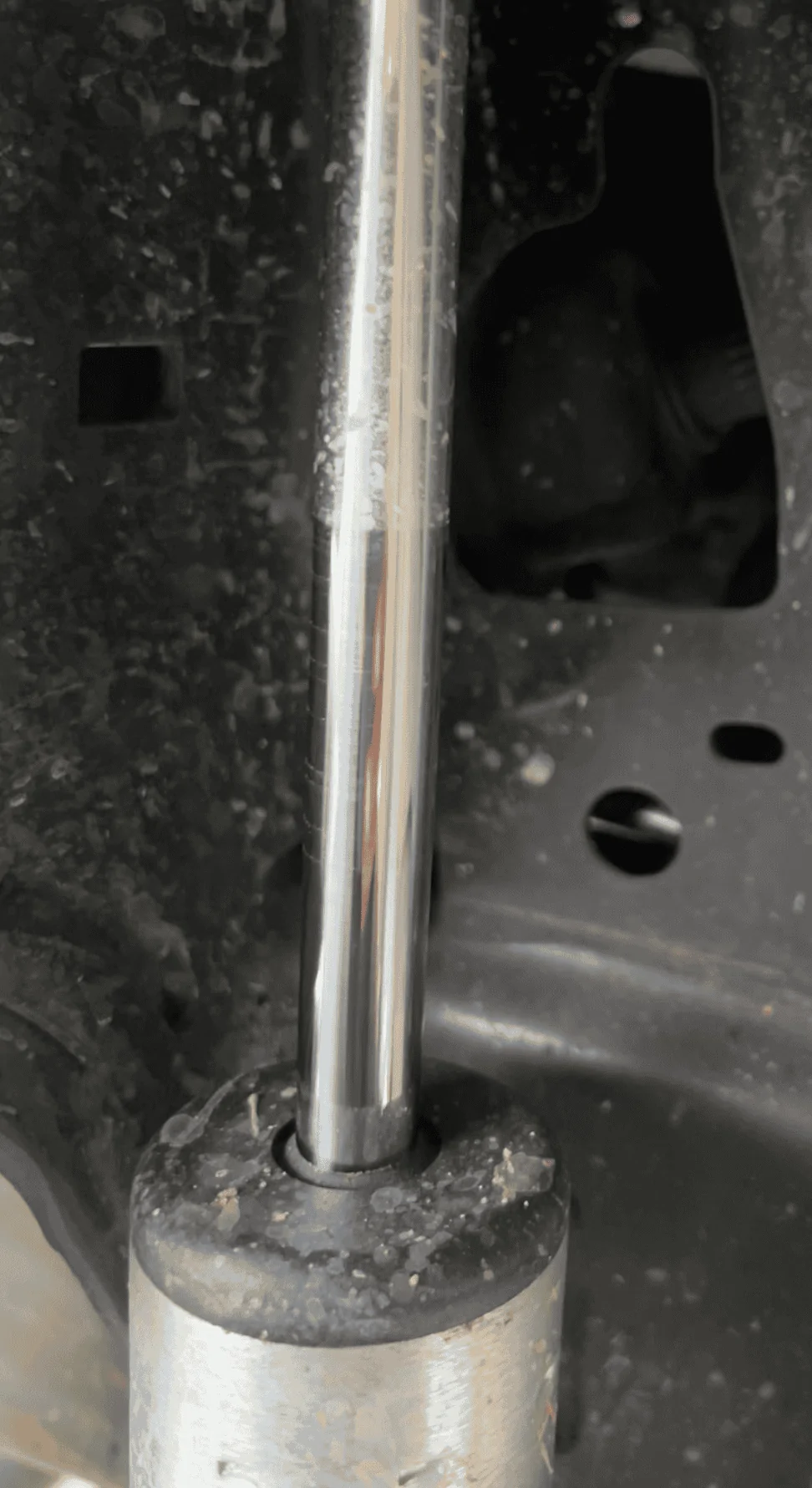

Omg is that at ride height? Seeing that alone would tell me those springs are absolutely not for that jeep. My springs look like that when I’m pretty flexed out
2021 3.6 eTorque
Dynatrac 2” lift
2” bump stops
FOX 2.0 2-3”
17x7.5 wheels -6 offset
35 ko2s
Sway bar disconnected
About 70% flexed

Yes those pics I posted are sitting level, unloaded and on a flat driveway.
