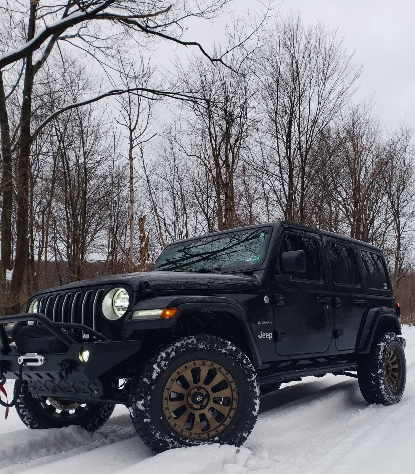

RC budget lift has been on for about a year and half . Have had no issues thus far and I think it drives great personally. I am not crawling around moab or anything but for what we have trail wise in Pennsylvania I can go almost anywhere I want to.
