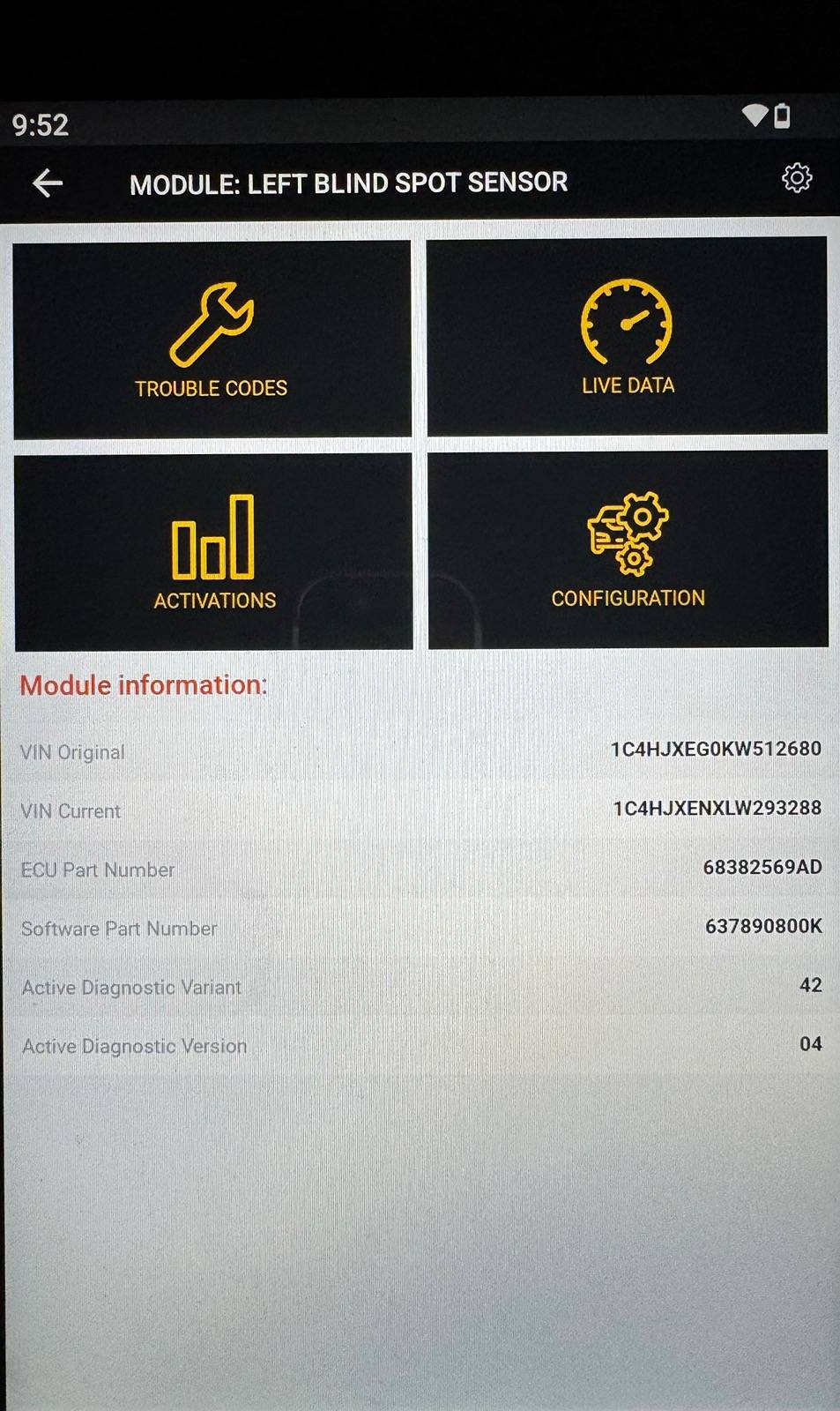

Im made my own swapping out the power and led leads today. Got new mirrors and used sensors. Dunno if I need to program sensors to my vin.

I don think you need to for the modules, they will automatically pick up your vin on the bus. If they are used they will just show the original VIN also with yours.

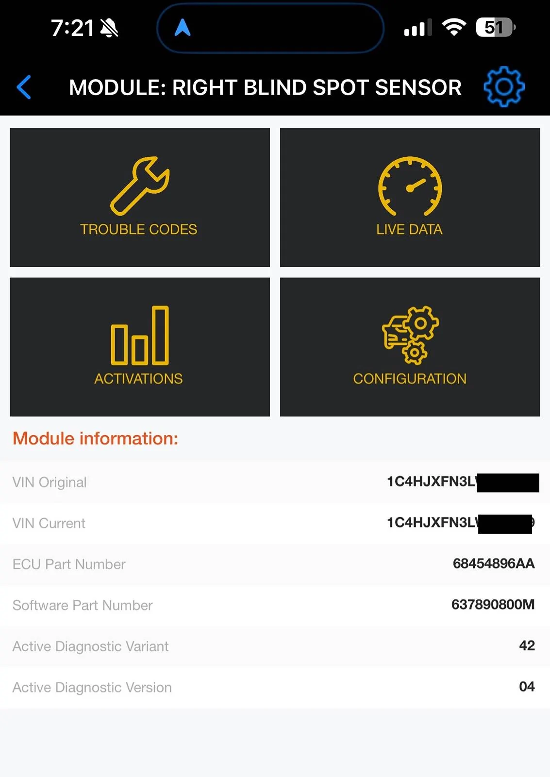

Here is my right side (only one I can see even if I only have the left plugged in)
You can see it will have the original VIN then your current VIN will populate.

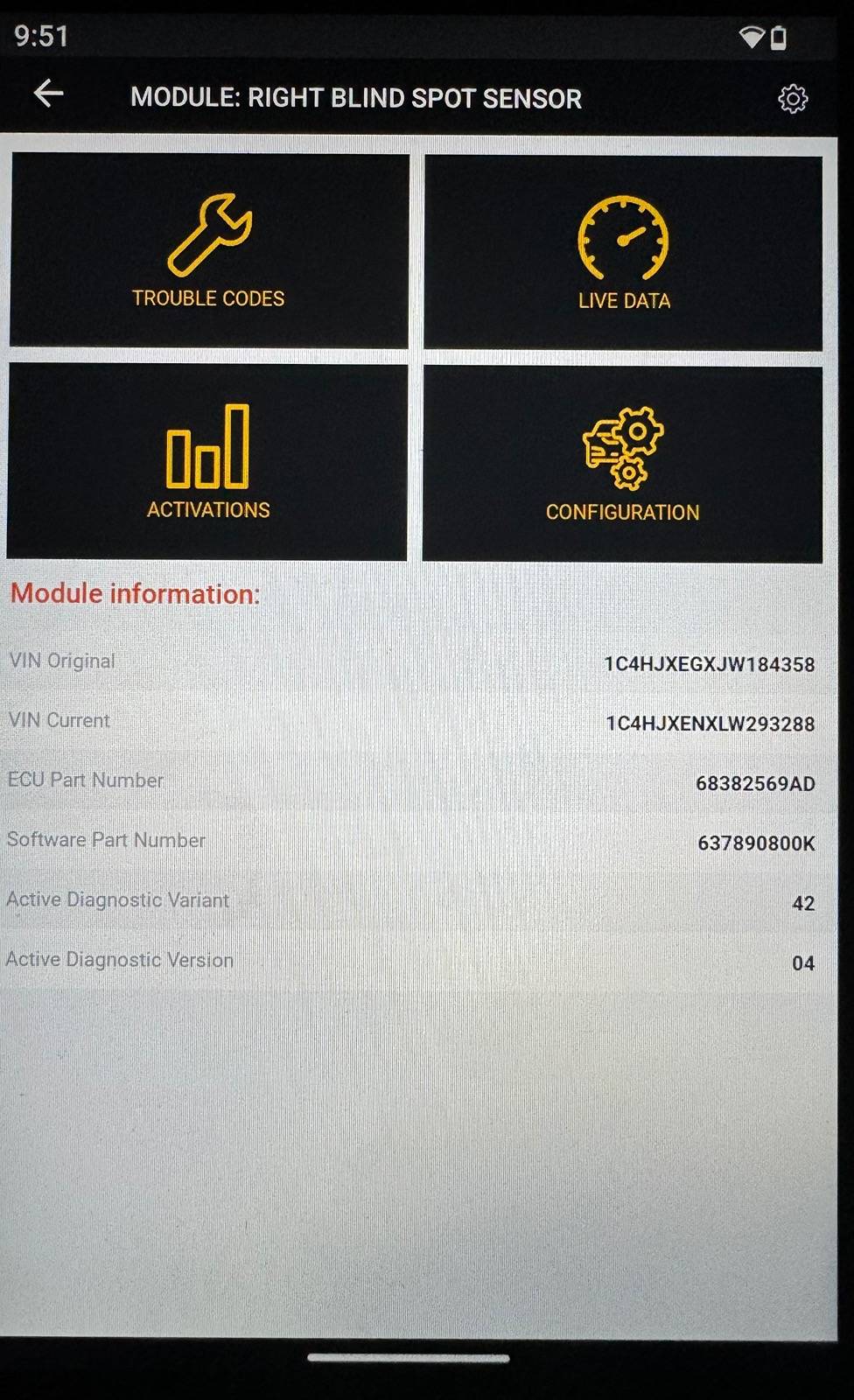

This is from my wife's. She has 00 for right and 000f for left (these are hex addresses). for my right it is 00 and if I swap sensors the other is also 00 so I "think" that is my issues. I need to assign the left side 000f but when I try to set one it does not take (says success). Reading online I may need a "blue cable" that changes pinout to program but I am not sure yet.

Yes, mine does goto lighter for power. it also supplies it for the ParkSense. I have checked both sides and bot have +12 and grounds.​
If I plug only one sensor in to either side it still only shows the right module. It makes no sense, unless both modules are coded for right. I have been searching and still can't figure that out. There is no wire that tells them left from right side. There is only the wire that goes to the LED out put on the mirror but nothing designating right from left.​
