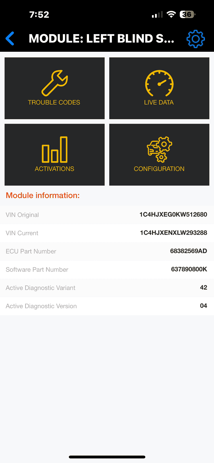

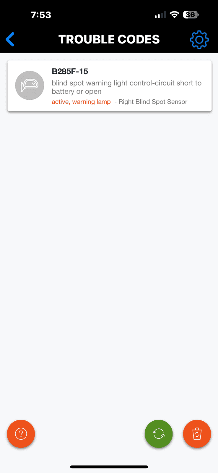

I have both JScan and alfaobd. I’ll get the dump later. JScan sees the modules but something is wrong. What is short to battery or open?

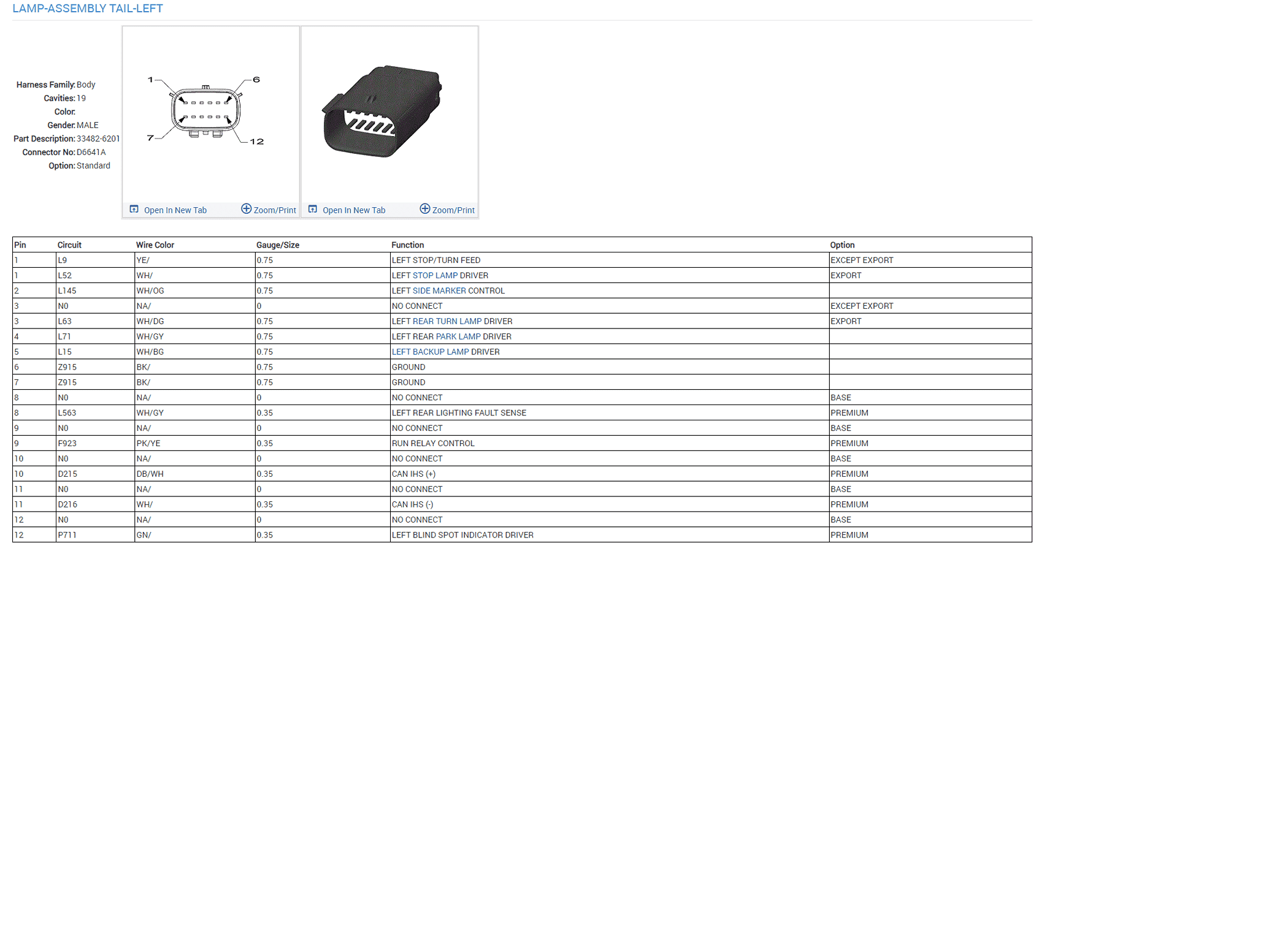

that error is typically when one of the mirror warning lights isn't turning on. If one side isn't turning on due to a short or open. The BCM is expecting a specific amount of current draw by the LED in each mirror, and if that threshhold is either too low or too high, will set that fault. If its too low, it indicates an open, if it is too high, it indicates a short on the supply side. The BCM is only reporting that either condition exists, but not which one, so you'll have to figure it out. So, the bcm is reporting the fault to both modules in your case. Is either Blind Spot warning lights turning on? If one or both blind spot lights are on, that indicates continuity for that side to the mirror. If both are on, and you have that error, then something is drawing too much current from the BSM module for that side or both sides. If only one light is on, then I would suspect the opposite side that isn't lit as an open from the mirror light to the BSM module for that side.
The connector at each door is always suspect. This is how I would fault isolate the problem.
1. Disconnect driver door connector xy600.
2. Pull left rear (driver side) rear tail light off and do a measurement between driver door connector (harness side) xy 600-21 and rear tail light connector (harness side) pin 12. Use diagrams below to assist in getting to corrrect pin at both locations. Measure for resistance, If its open, then rerun wire or troubleshoot why.
3. Measure either at the tail light connector (harness side) pin 12 or driver door connector xy600-21 (harness side) to exposed frame of car for shorts. If there is a short, then run a new wire for the supply or find out why that pin is shorted to ground.
3. Put the driver door connector back on and measure at the tail light connector (harness side) pin 6 to frame ground. You should see a short. If it is open, then fault isolate why your harness isn't grounded either on pin 6 and/or at the door harness xy600-12. I typically use the grounding lugs in the side panel behind the covering that under the driver door connector.
Then you'll need to do the same for the passenger side.
