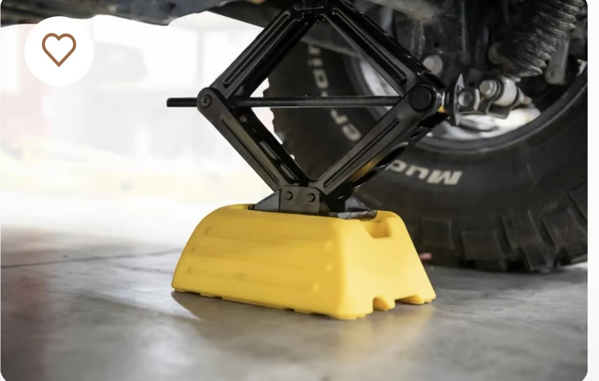

Not sure about bottle jacks, but I use the AEV scissor jack base, which also makes for a nice wheel chock. Used it recently to change a tire on soft dirt and it worked great.
Jeep Wrangler JL Bottle Jack pads 1675197853741

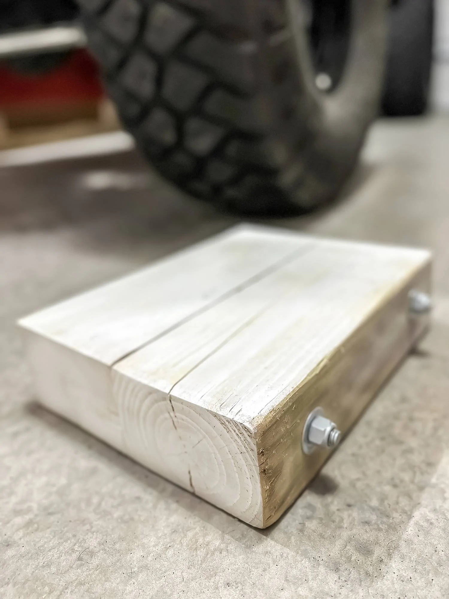

I use pieces of 4x6. I also have one that serves as the base. It's two 4x6s double bolted together to form a jack-pad that is 14x12x4. It serves as a pad for my hi-lift and my bottle jack
I wheel mostly in sugar sand here in Florida.
Jeep Wrangler JL Bottle Jack pads 4x6 Cribbing
