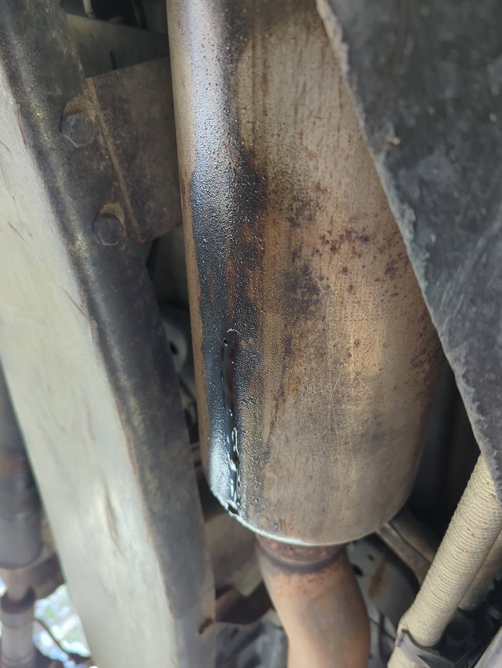

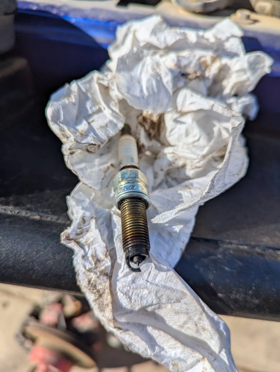

HUGE amount of blue smoke from tailpipe on cold start... Less as she warms up but still very visible. Oily fluid actually drips from the weep hole on the muffler after a while. Spark plugs are ugly and oily.

that and that oil looks like used rear end lube.

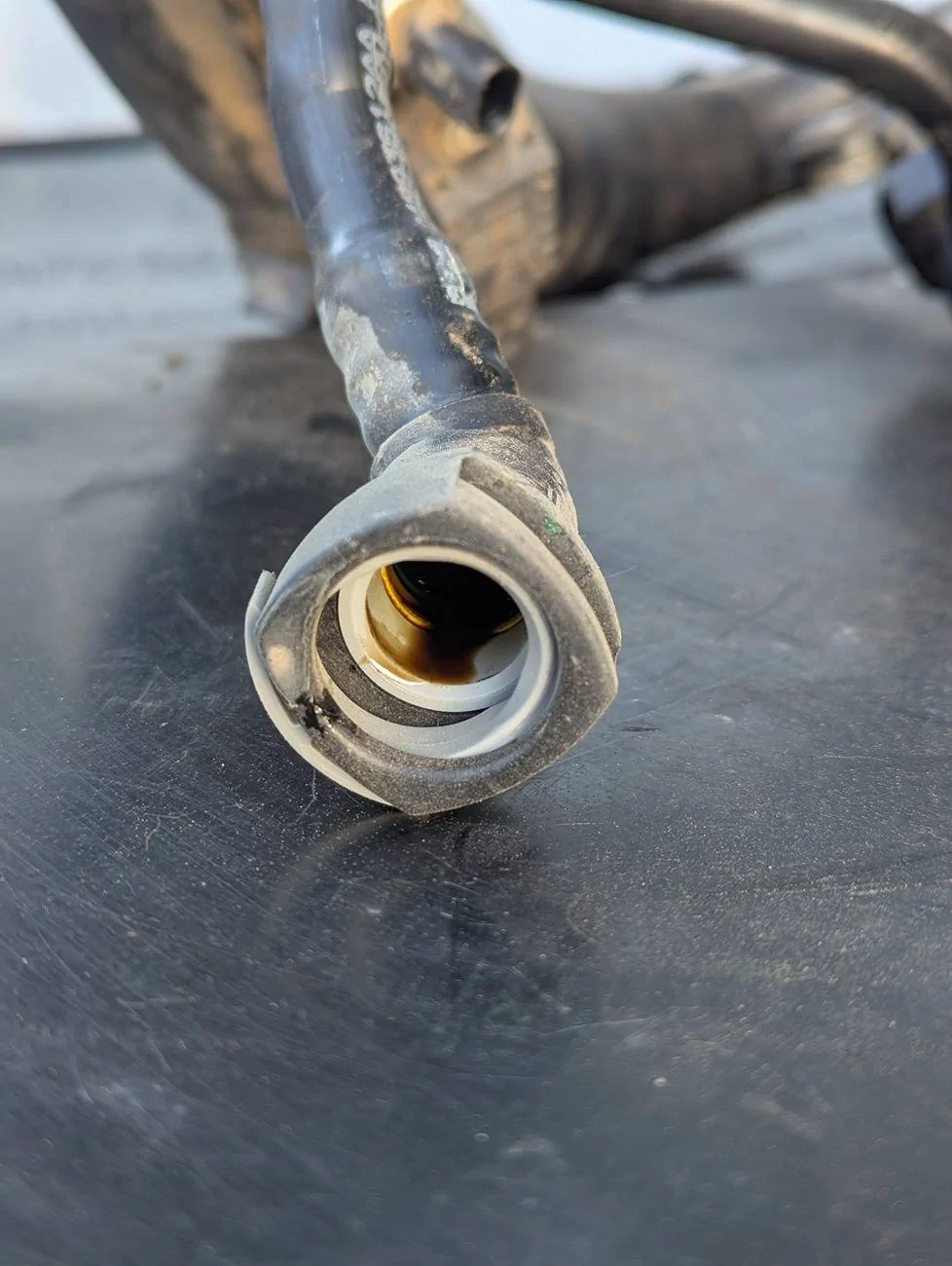

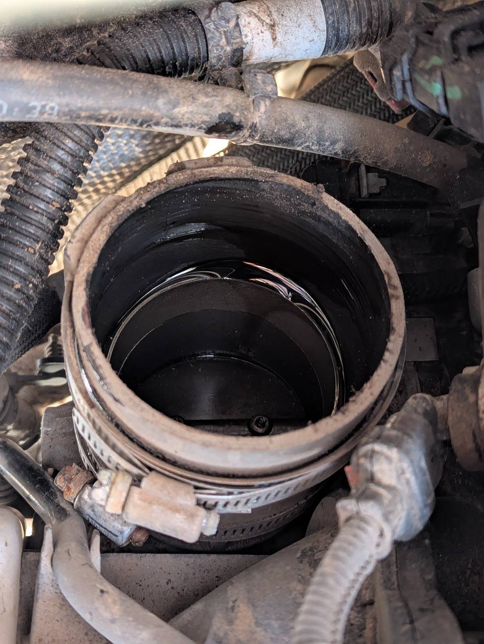

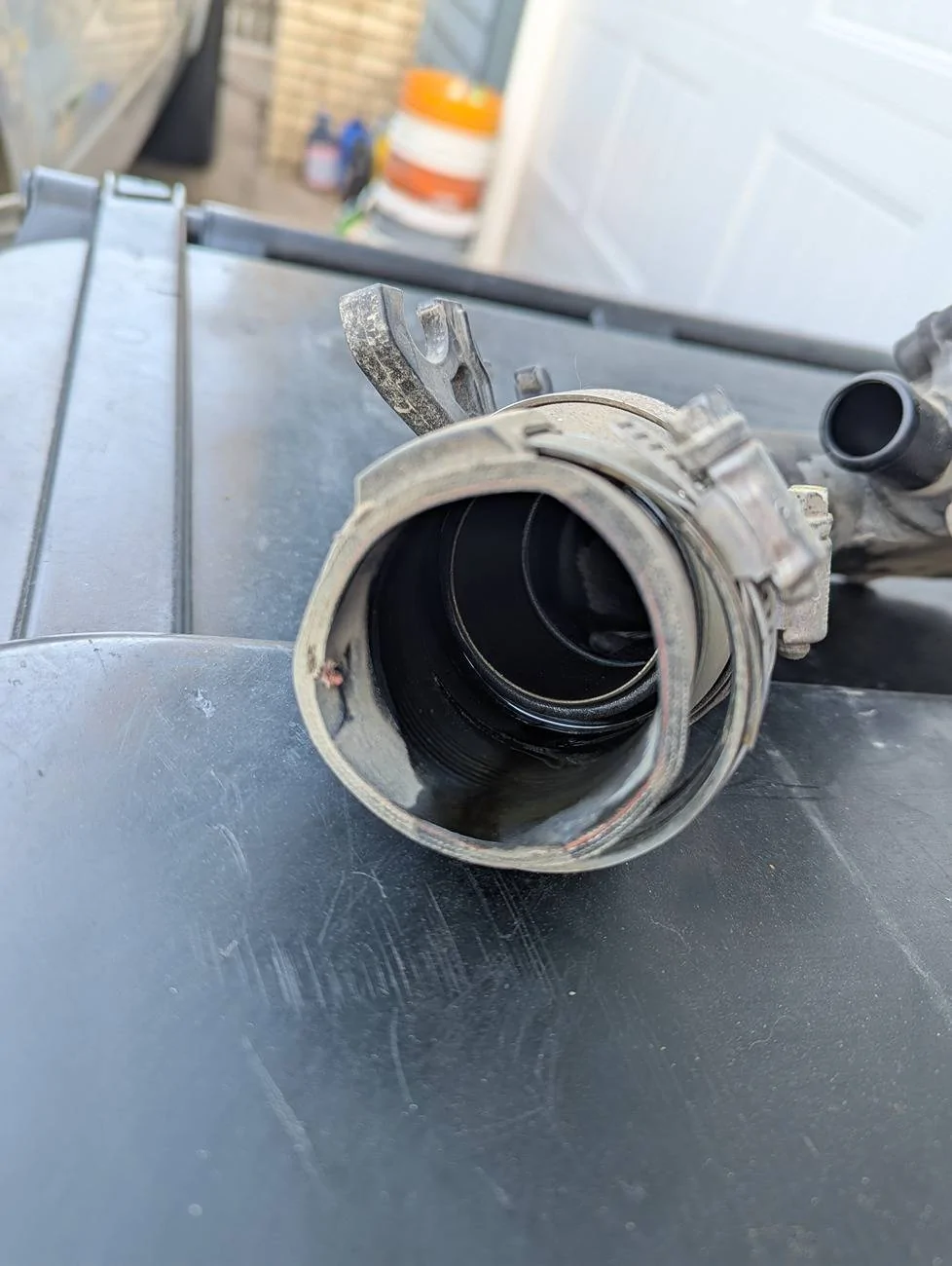

There is oil at both ends of the intercooler from the turbo to the intake. There is also oil in the PCV line.
I'm trying to locate the PCV valve and figure out how to swap that out. Any tips on that?

I would remove the other pipe from the turbo to inspect it as well.

Thanks jrocket, which other pipe on the turbo are you referring to? I removed the one between the throttle body and the turbo- Mopar calls it the Charge Air Cooler Duct. are you referring to something different?

The air filter box to turbo and the other tube from the valve cover, and inspect the turbo probably full of oil as well.

Could be a blown head gasket or the rings are shot. Could also be valve seals. Could be multiple things at once. Turbo, PCV, and EGR are easier to check first. But a salvage Jeep on tons may have been abused a bit.

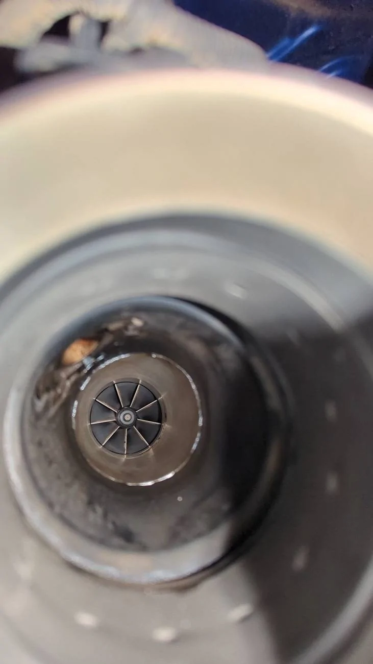

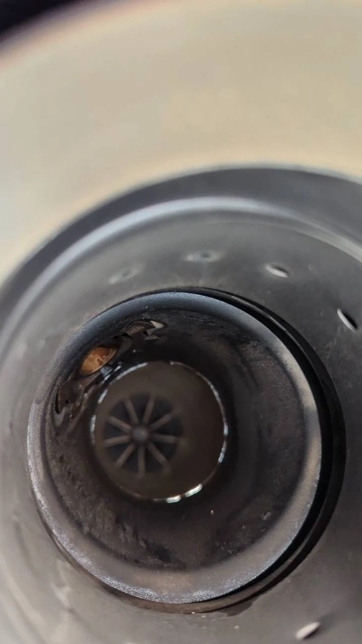

Also attached are photos of the turbo cold air intake- a little oil coming in from the crankcase ventilation pipe, but the impeller doesn't look overly "wet".

The compression numbers sound okay for a 10:1 ratio engine. By chance has the jeep been on its side or upside down?
If you find no other reasons for the oil, I would suggest cleaning it up and adding a catch can. Once cleaned up, if it still smokes it probably needs a head job. The compression test checked the rings and sealing of valves in combustion chamber, but not the valve seals.

I don't know for sure since I just bought it as a salvage vehicle, but the damage to the aftermarket fenders and wheels suggest it was on its side at some point. I figured there could be oil in the cylinders from that, but thought it would burn off pretty quickly.
Any recommendations on how to clean the boost/crankcase pipes and throttle body? Seafoam/CRC into a vacuum line?
I realize the other possibility is that the turbo could be leaking oil internally and feeding it down the boost pipe to the throttle body, but I'd like to rule out other possibilities before going to turbo replacement.

Looks like it was run with the oil all over engine in dirt or sand.
I'd spray off motor as best you can without getting water down the turbo pipes, check all those turbo valves and such, clean that up (brake cleaner), new oil, what codes you getting?

Lots of brake cleaner and rags. Might be a good idea to remove the intake to clean as much oil out. While that is off you can check the oil separator too.
