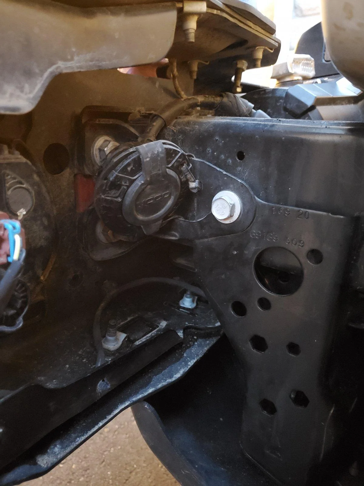

Jeep Wrangler JL Block Heater Cord Options 20201028_182612
Got the NOCO GCP1E 6ft, wasn't about to drill a 2 in hole so just zip tied it behind the bumper.
Make sure to put some dielectric grease on it and tape up the connection in the bay(at least thats what I did).
