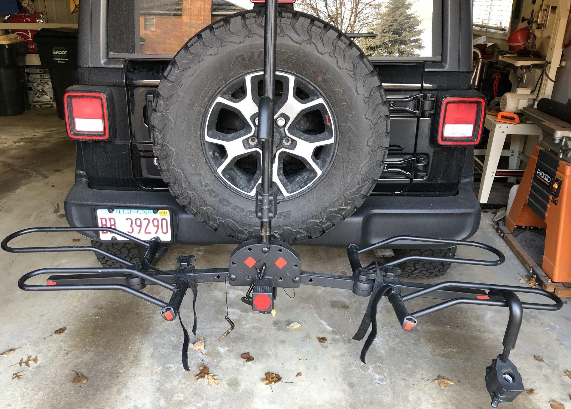

I have a Hollywood racks hitch mount that does 2 bikes with a 2 bike add on. It’s heavy and a little clunky but it’s a great value.

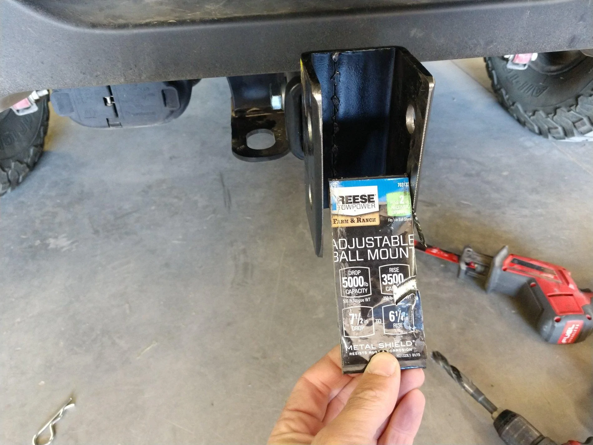

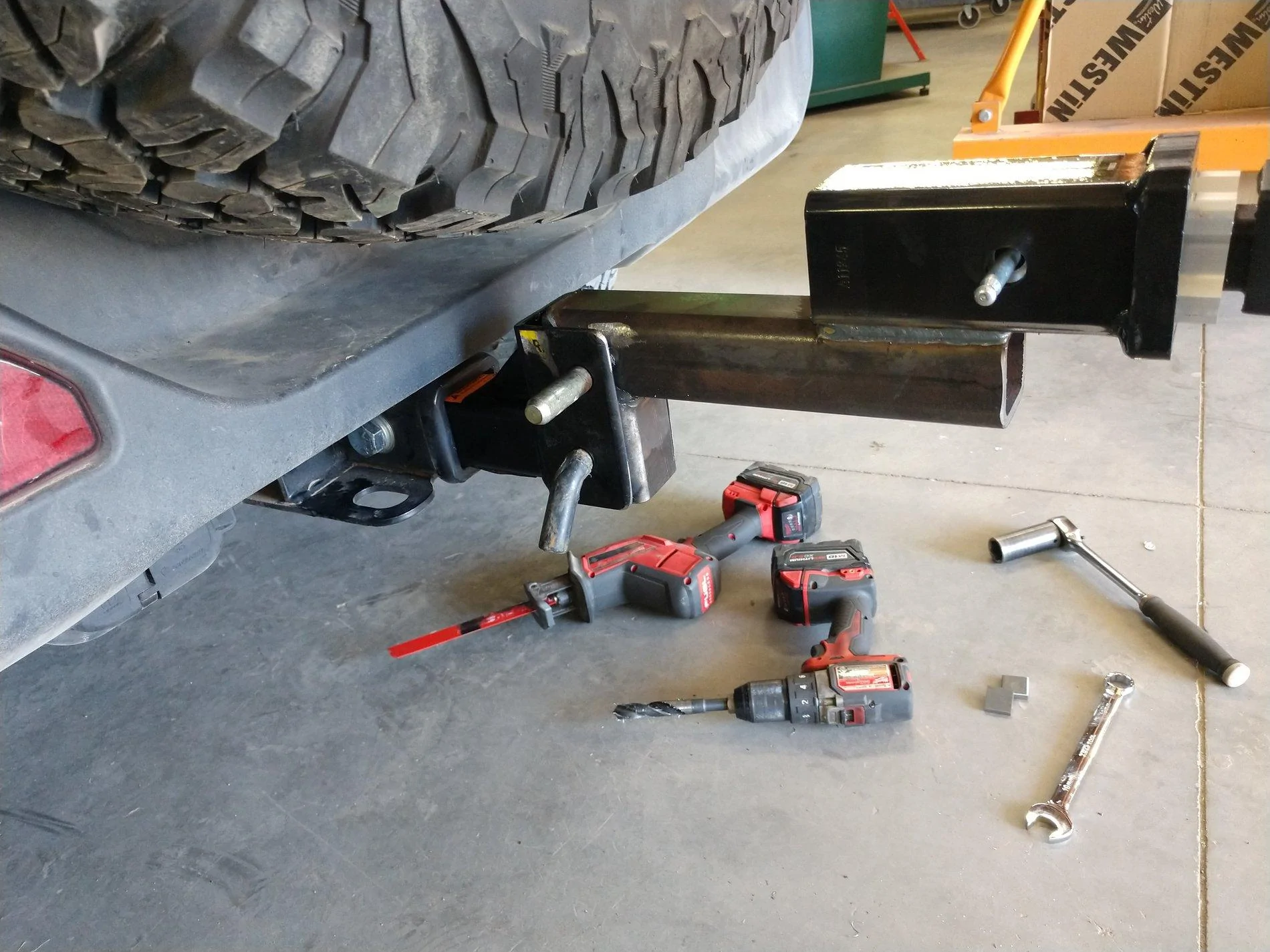

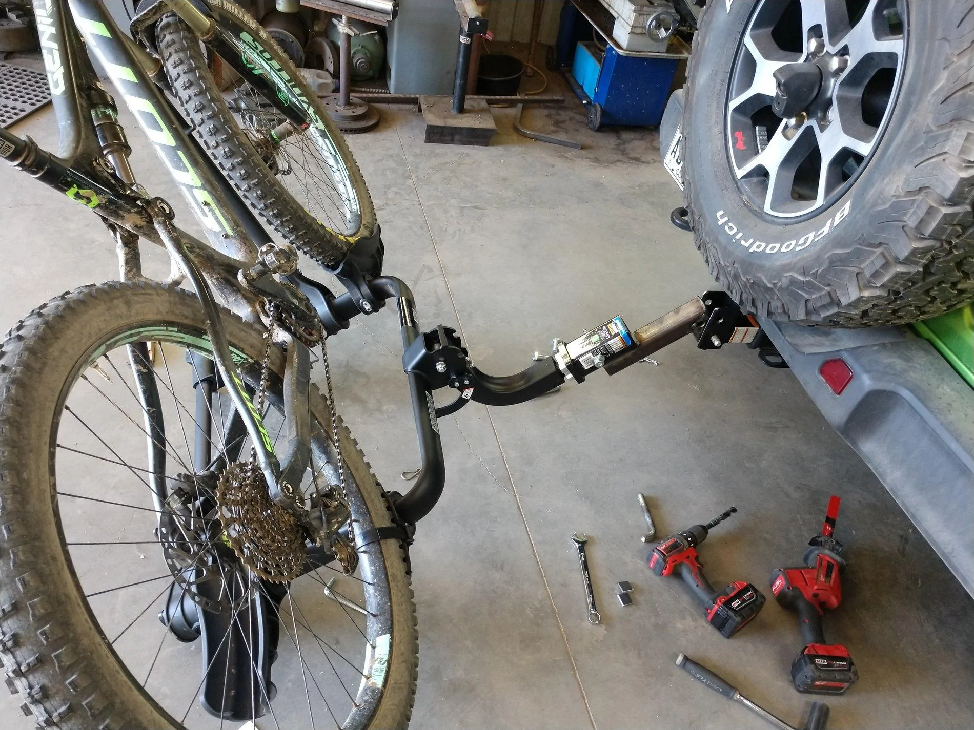

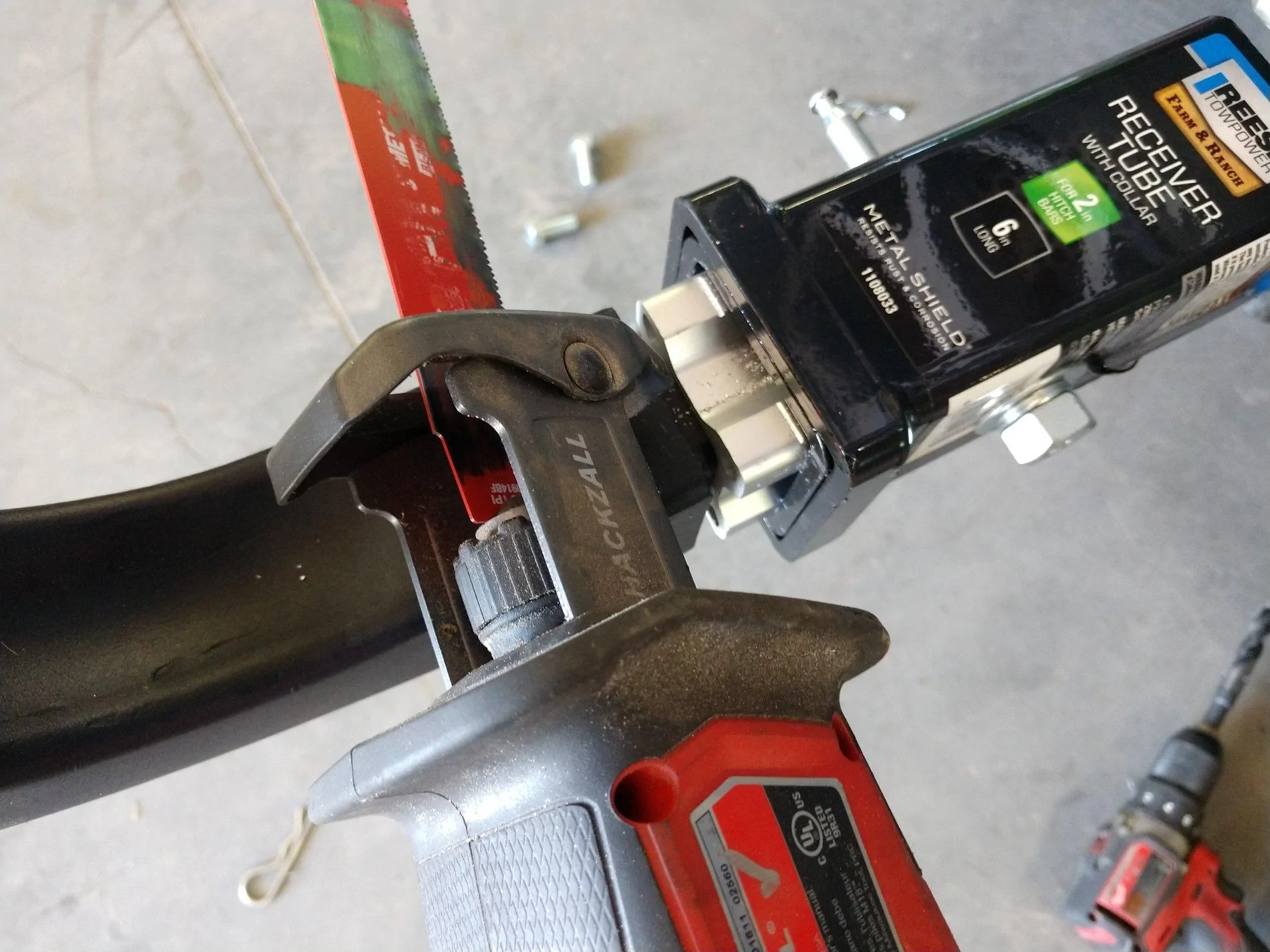

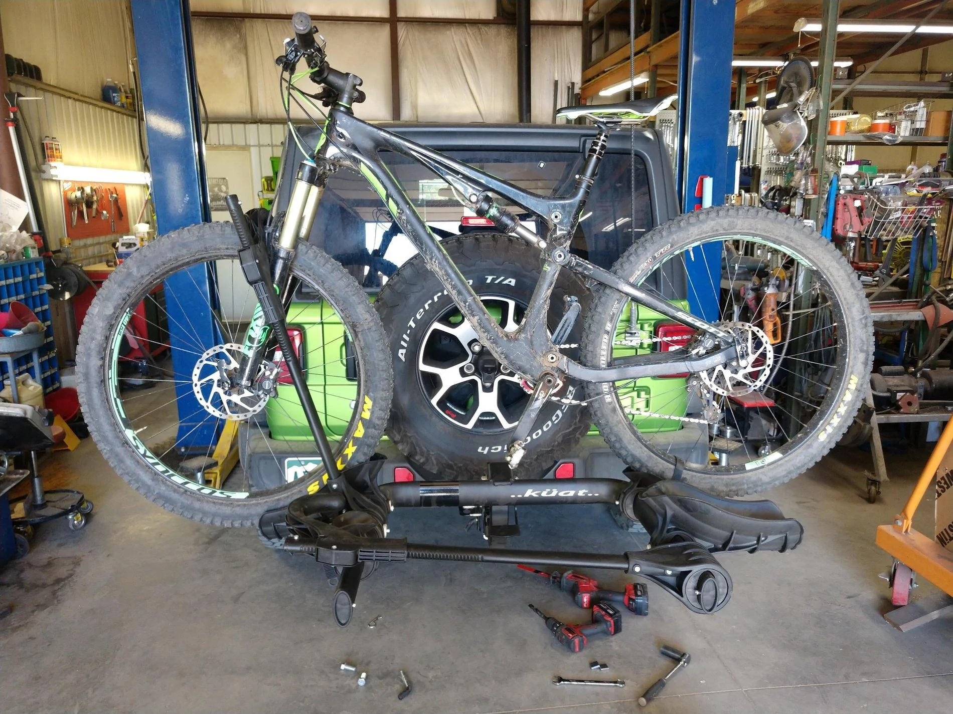

I just ordered the Kuat Transit 2 because it was one that was 1) relatively affordable (maxing your budget here) and 2) I could confirm it would accept the 3.0s on my plus bike.
You'll need a hitch extender to play nice with the spare, and forget about opening the rear while the rack is in.
I now have a plan to custom fab a way to lower the rack a bit and have it drop out of the way - of course more expensive racks will do this for you, but while they'll clear liftgates on SUVs and cute-utes I dunno if any drop enough to allow our gates to swing open
Quoting myself here 'cause I finally got around to this. First, I kinda lucked out 'cause I stumbled upon this adjustable ball mount being clearanced at my TSC for $10. It was clearance because the actual slider tube and balls were missing, but I knew it'd get me going in the direction I had in my BAD (that's Brain-Aided-Design) and was worth $10 for me to not have to slap some 2.5" square together at a right angle.

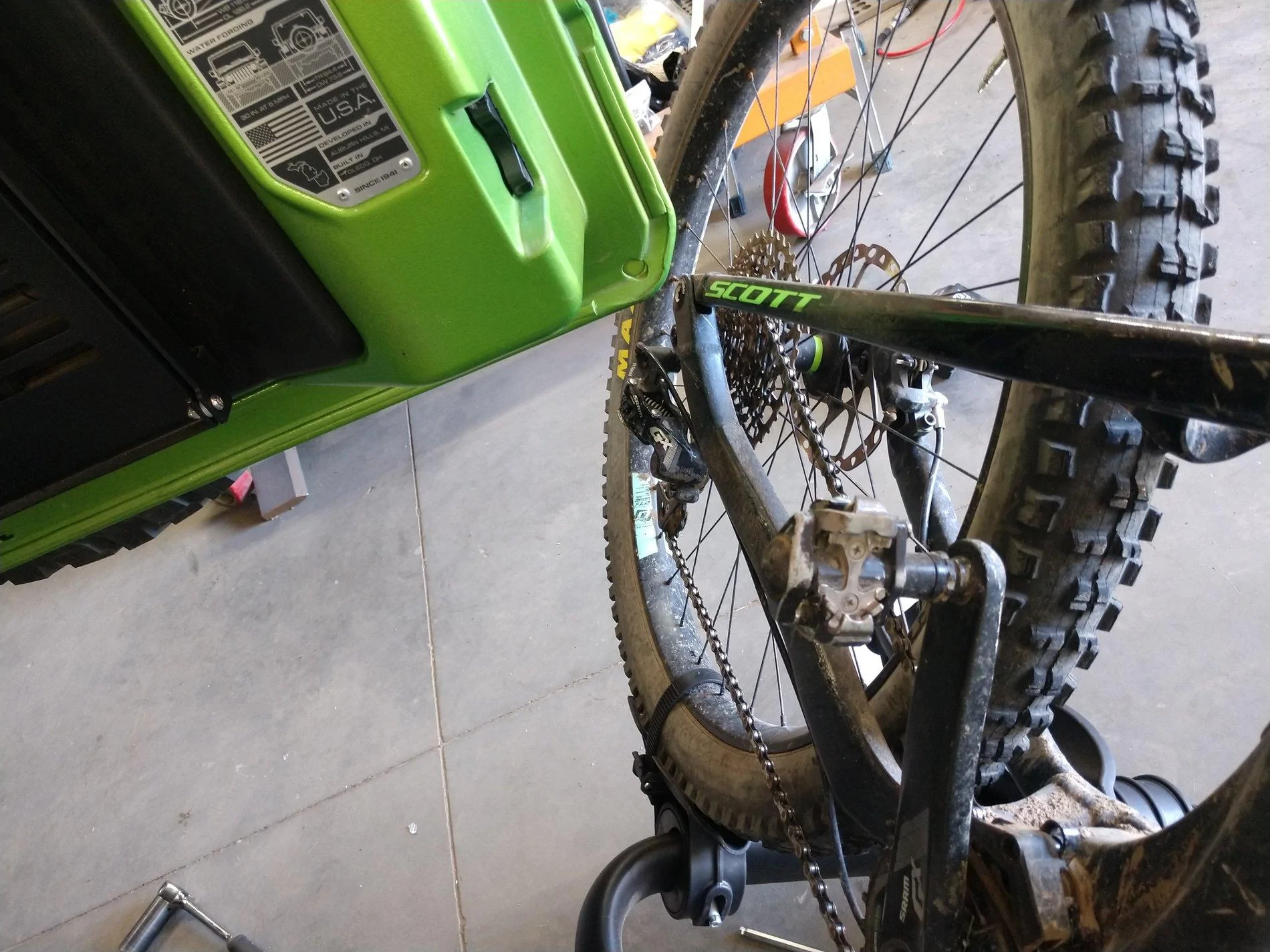

I cut out the back wall (pic) and added a second hole higher up. If I pull the higher pin the whole thing drops down and I again got lucky 'cause on level ground at least the tailgate JUST clears my mtn bike.
This is all pre-paint on my booty fab but the pics are pretty self explanatory.
Now I get to be the poseur with the green Jeep and bike with green accents to match (sigh)

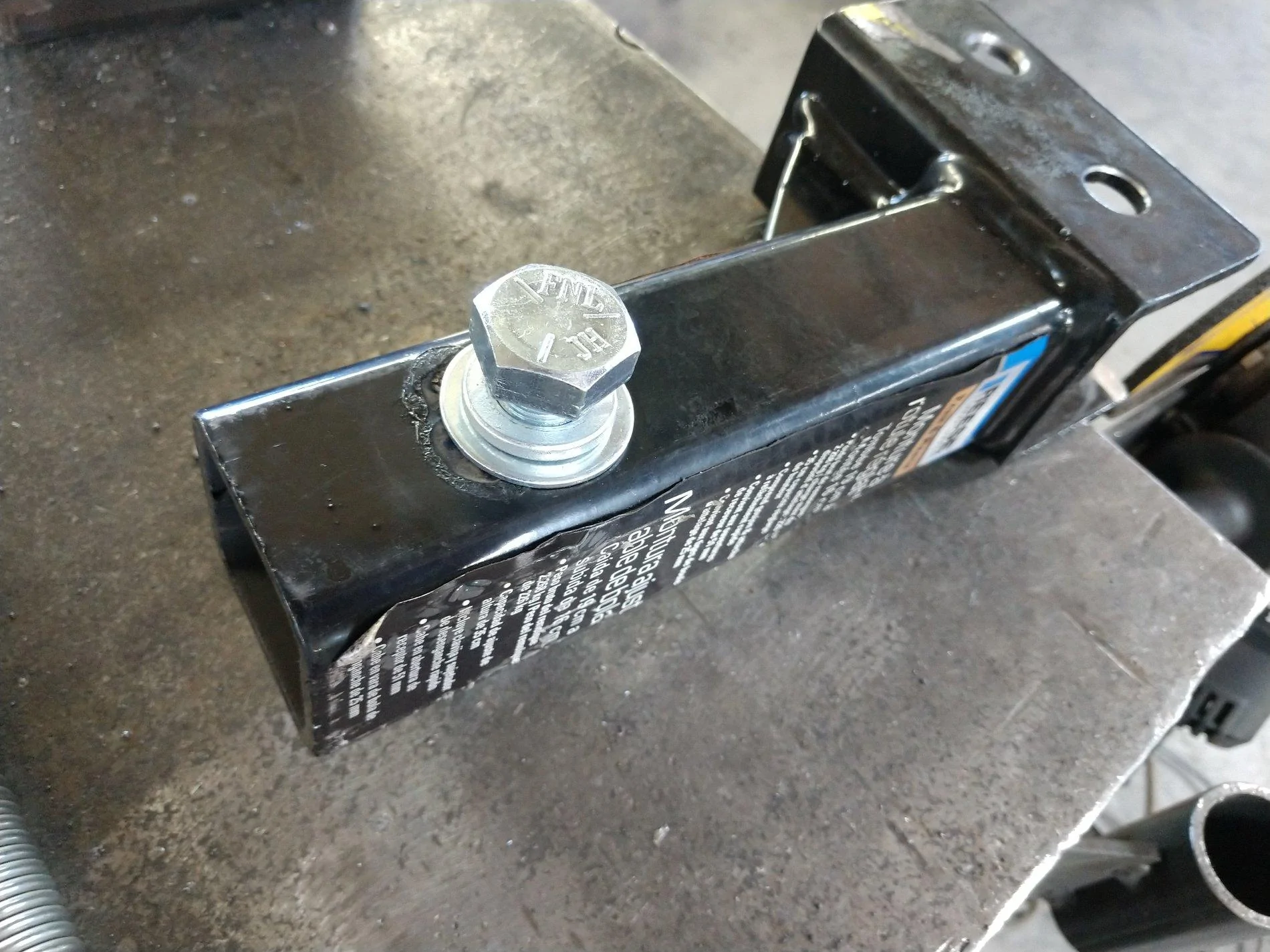

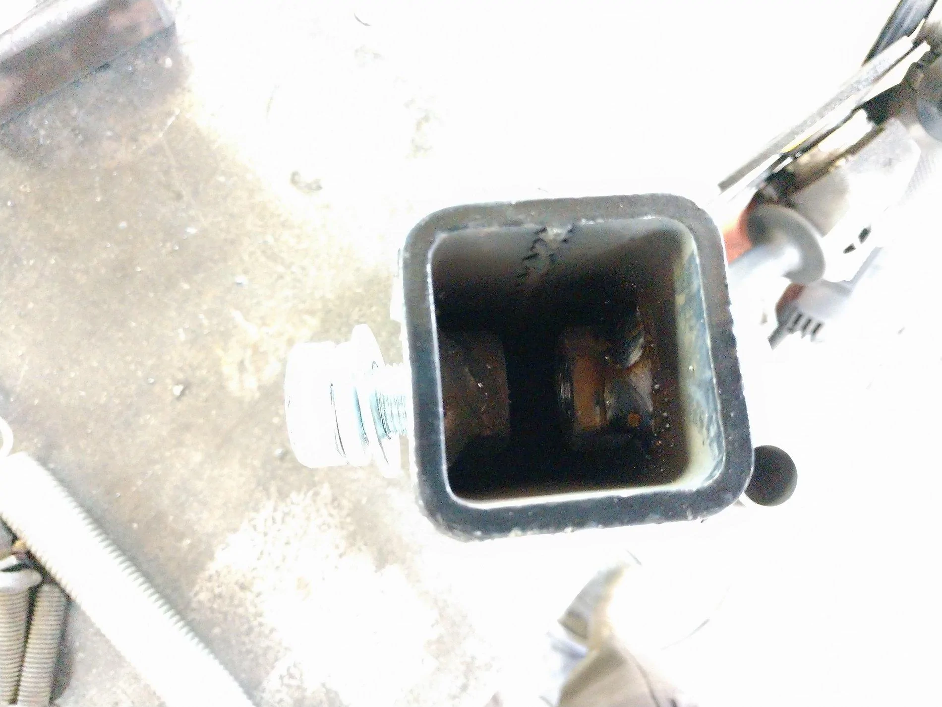

One final thing I did for the male tube that actually slides into the Jeep factory receiver is to tack in a 5/8-18 nut on each side, then I install a short 5/8 bolt on each side to eliminate any slop or wobble. It works like a charm.
This means I need to have a 15/16" socket and ratchet at the ready, but that's no big deal - Kuat expects you to keep a 19mm wrench for their threaded pin anyhow, so it's not like any of this was ever supposed to be tool-free

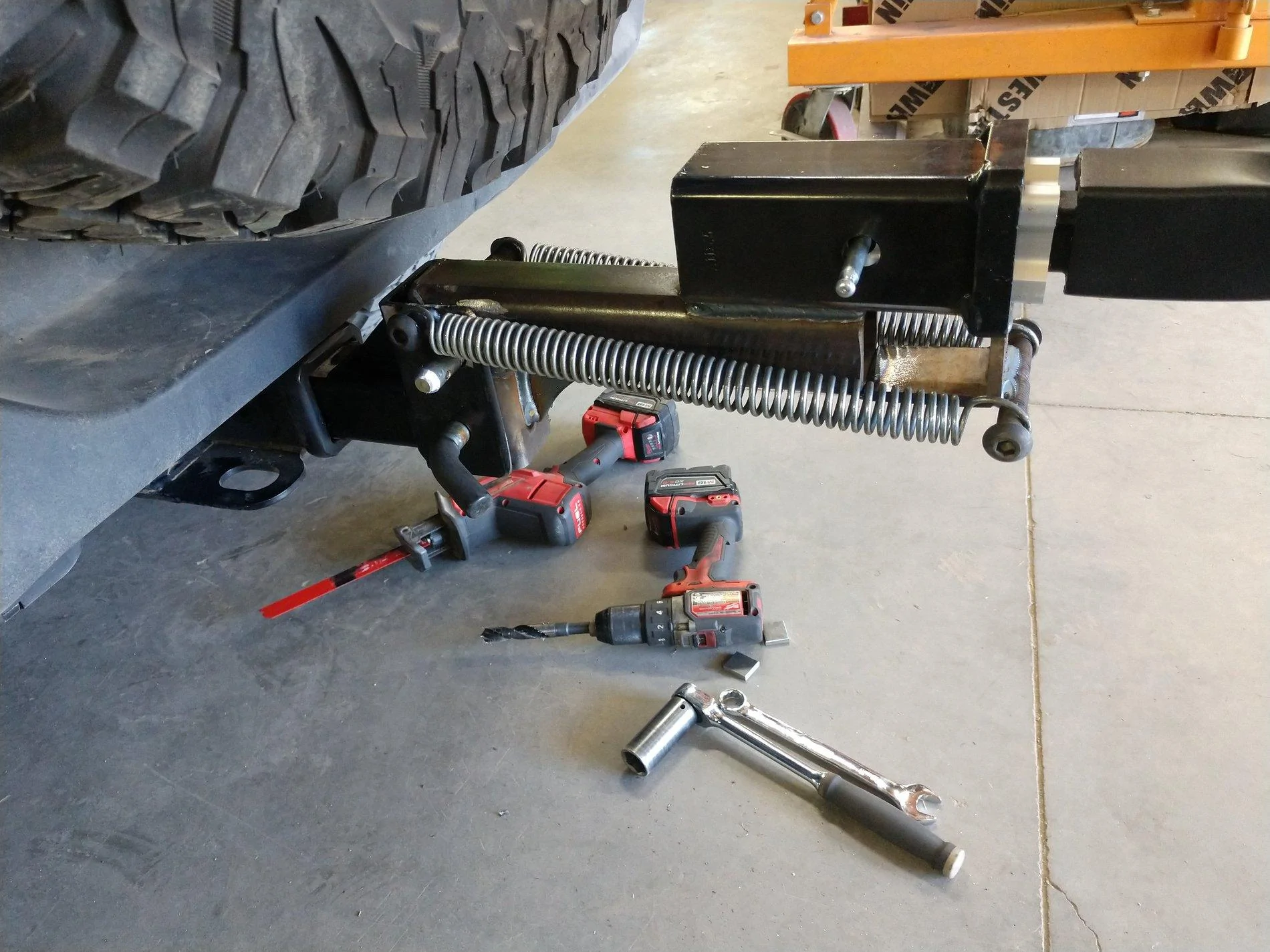

Ok last thing I did was add a couple springs I had sitting around. Swinging the whole thing up into place w just my mtn bike loaded was surprisingly heavy. The springs aren't a panacea but definitely helped.
