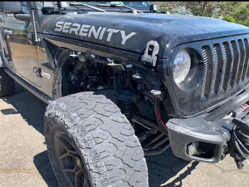

I noticed my rear bumper was bent up. Lost the front passenger fender flare at Holcomb but John Bull loosened it first. Skids did their job so everything was well protected. Jeep does look likes it got a zoot suit with all those pinstripes.Yes it was good to get them both knocked out in one day. We didn’t start Holcomb until 4pm and were really pressing the get done before dark but as we were finishing up the middle rock garden it was dark and the auto-headlights had turned on. We didn’t have any choice but to continue in the dark but we have good nightlights and it was actually pretty fun making the best of the situation.

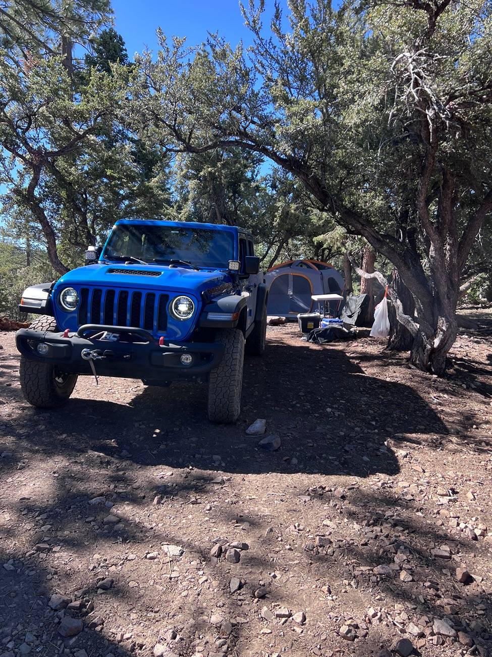

Out campsite.

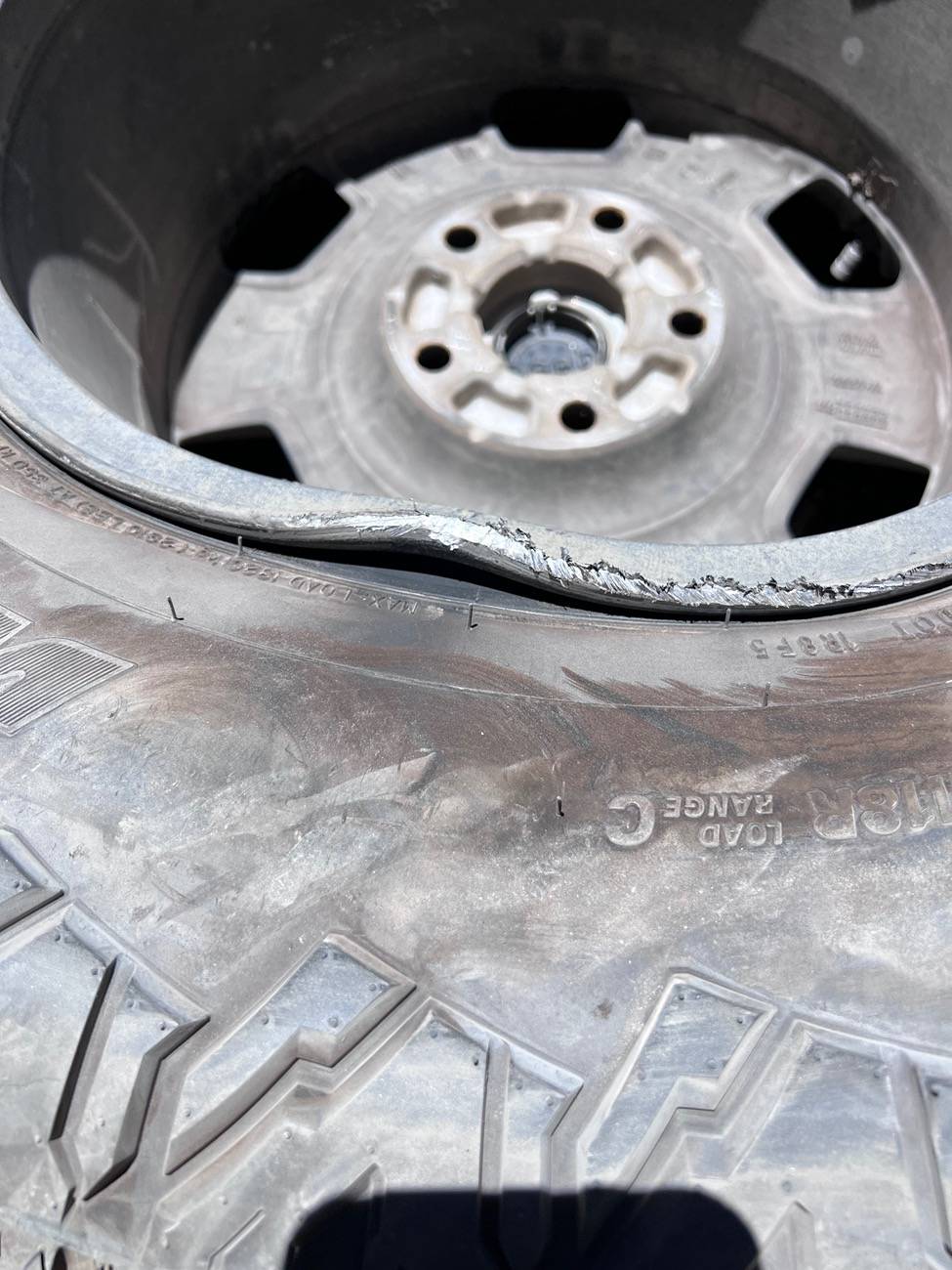

A pic of My bent rim that took this morning before loading it up on the undercarriage. I don’t know that I can fix it but I’m not getting my hopes up.
I plan on giving that a try. I did hit it a little bit with a small sledge this morning and it was moving but I want to get a little more precise with it. I figure I'll either fix it or make it worse so I have nothing to lose.how the heck did that happen??
you can fix that. Wack at it with a dead blow hammer. The best way is to heat it up a bit with a torch, or a powerful heat gun. That will make the metal more maleable.
ive fixed worse than that, though they were forged wheels. Should still work.
That's part of what I meant by more precise. I'm thinking a piece of wood rounded to the shape I'm looking for. I also have a dead blow in my home arsenal.Dont use a sledge hammer. Use a dead blow hammer.
If you must use a sledge, put a 2x4 over it
I'm thinking I slid off the slide of a rock and landed on the wheel.how the heck did that happen??
