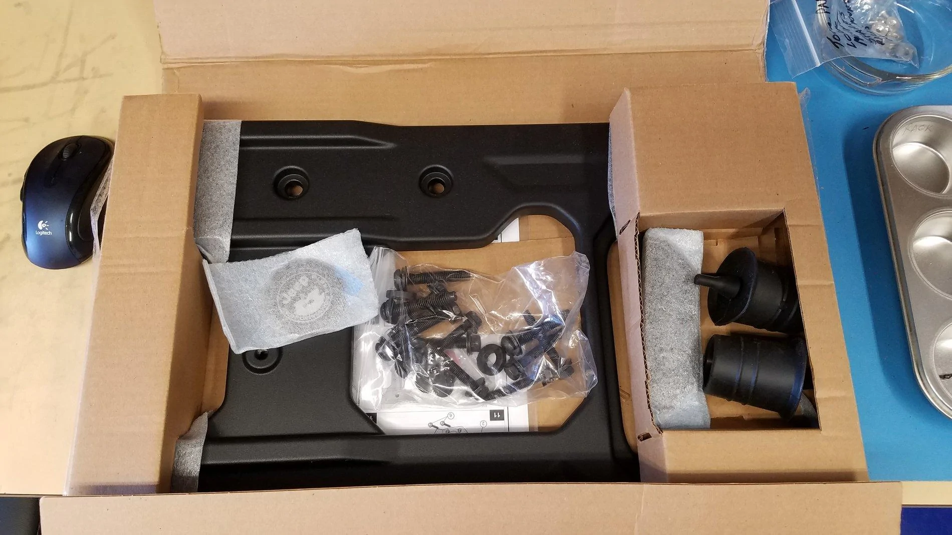

I just received my reinforcement bracket and see that it comes with the spare bump stops/isolators. Were these not long enough for the Mopar wheel/KM3 combo on your rig? Too long?
Thanks.
Thanks.
Those did not even touch the tire with the kit installed. They might work for the stock wheel and tire, but not anything aftermarket that I can think of. They were short of the Mopar wheels by about 1/2”.
The “accordion” style bumpstops that were a part of the bracket lift kit fit well. I had to cut off one of the sections and then they were perfect.

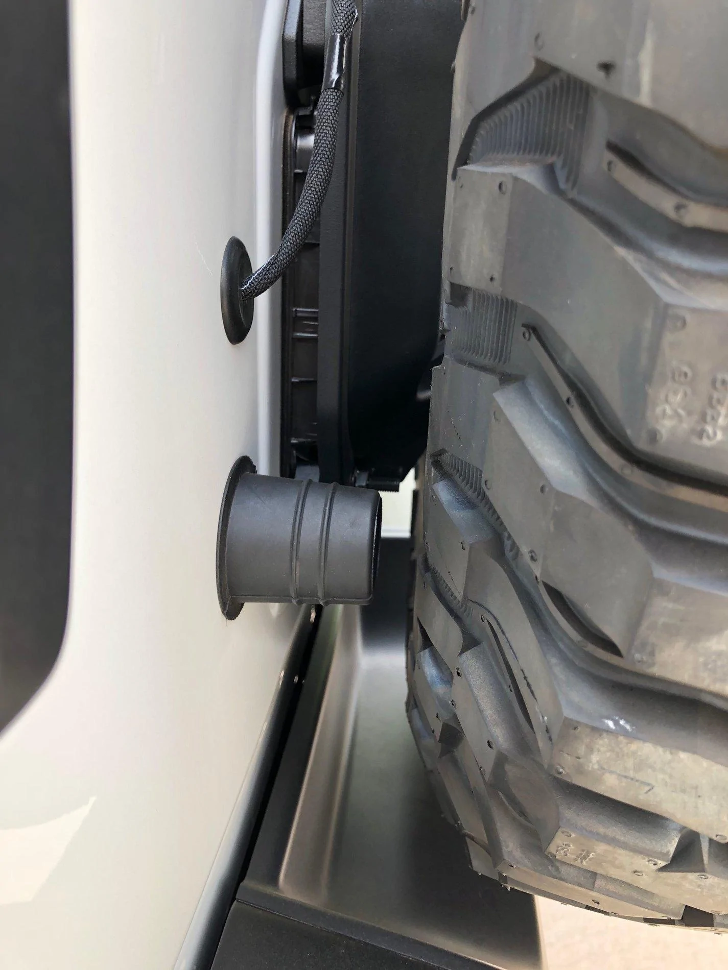

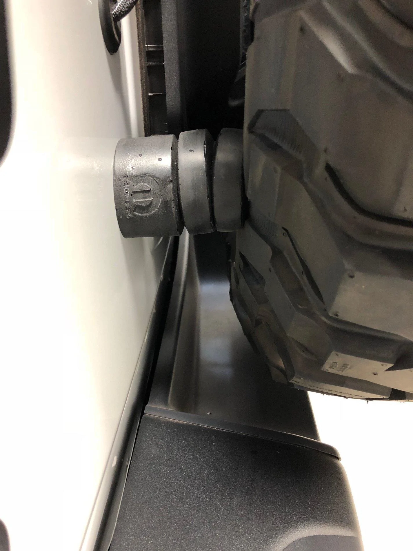

These versions of bumpstops are shown with the Mopar wheels and 35/12.5/17 KM3 tires. The first is the extended bumpstops that comes with the tailgate reinforcement kit. The second is the bumpstops that come with the Oversized spare tire kit (with one section cut off).
