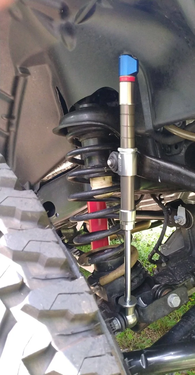

AutoLynx for the win!
Expensive? Yes, but when it comes time to reconnect after a long, hot day on the trail, they feel worth every penny.

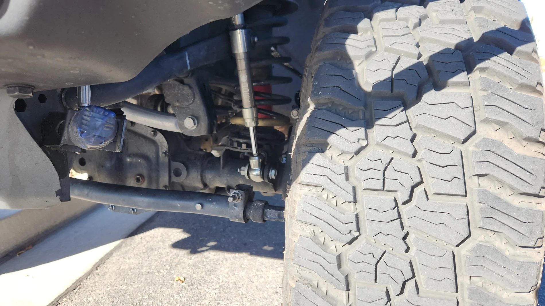

Apex AutoLynx!!!!! I’ve ran them for 5 years at least and have not had an issue. Easy to install and even easier to use. Simple twist of the knob unlocks or locks them. Cannot go wrong on road, Offroad, or crawling.

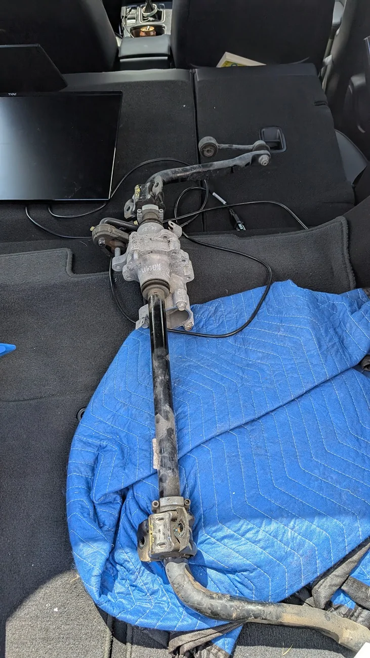

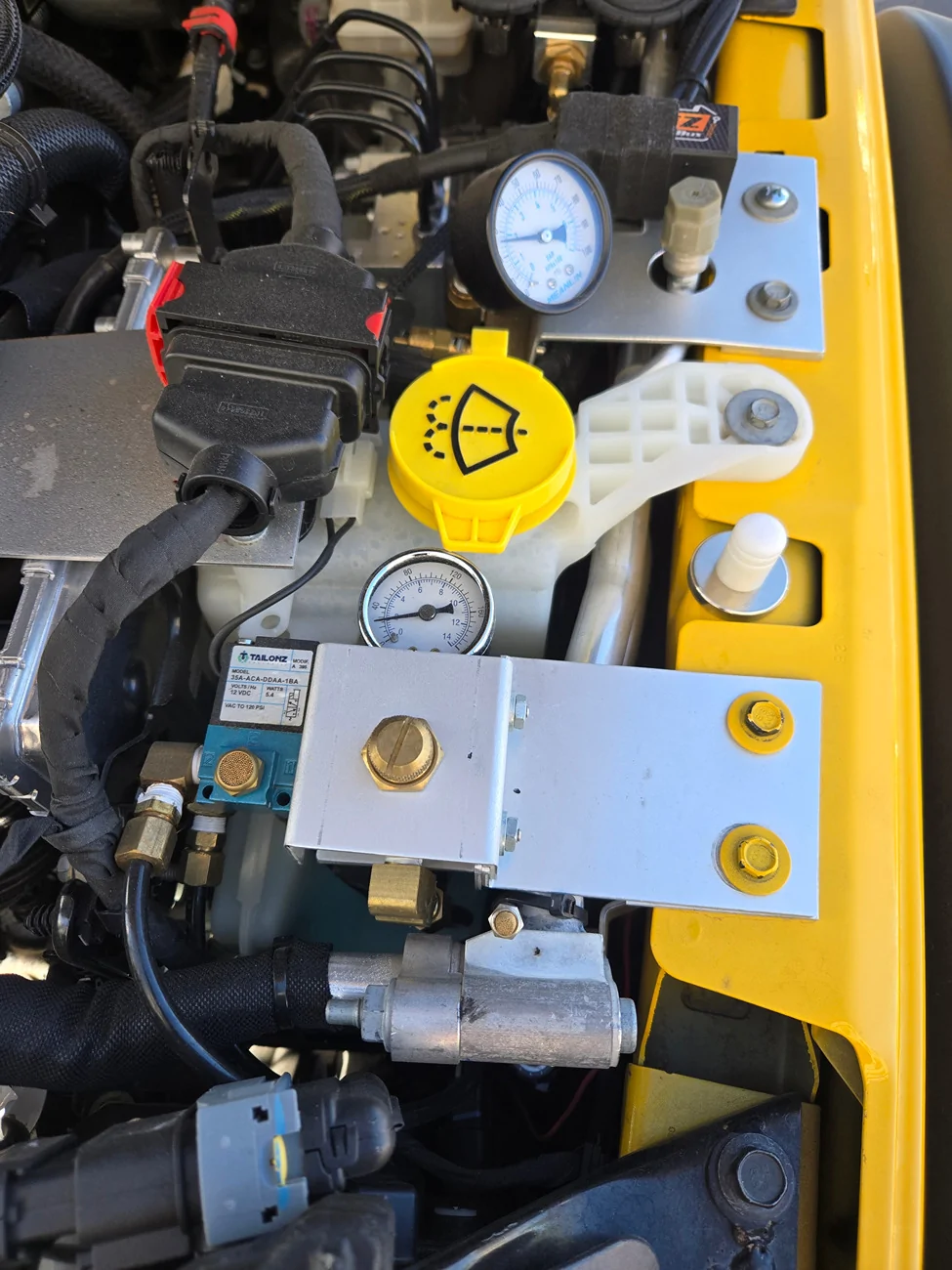

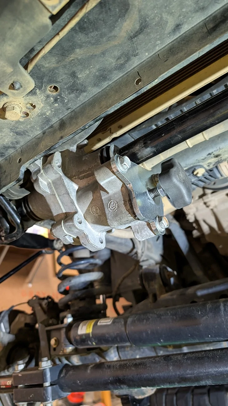

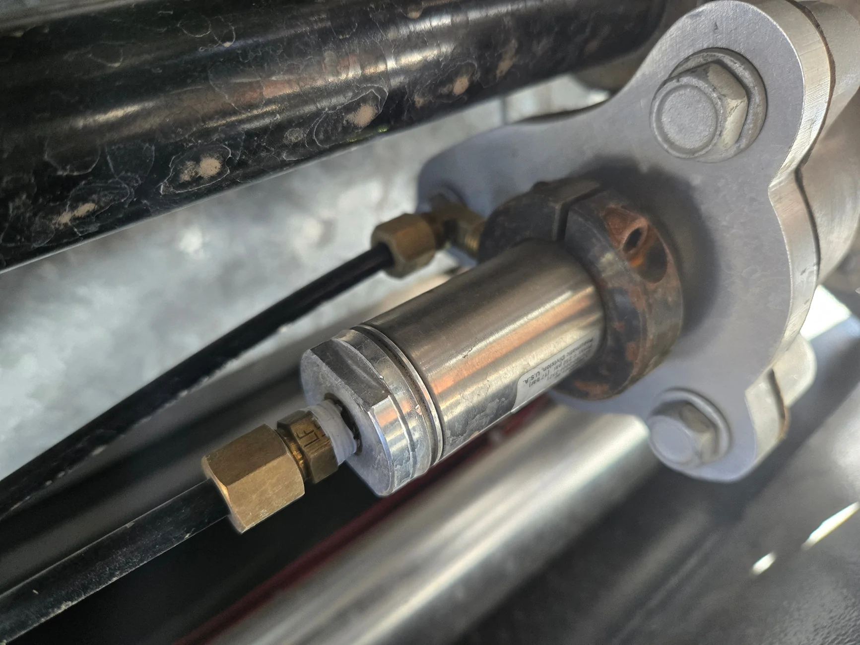

I installed a Rubicon sway bar and added a pneumatic cylinder to disconnect the sway bar.
I already had an ARB compresses for filling tires so I only had to add a pressure regulator some lines, fittings, solenoid valve and make the adapter plate and push rod.
EVO makes something similar.
https://www.northridge4x4.com/part/...yl8SP9j5xsY7_tBFLlIOaWWolIpZwuhRoC19oQAvD_BwE
The only problem with the Rubicon sway bar is it can stick in the open position so I doubled the return spring pressure. It has never failed me.
I like the fact that I can turn it on and off with a push of a button.

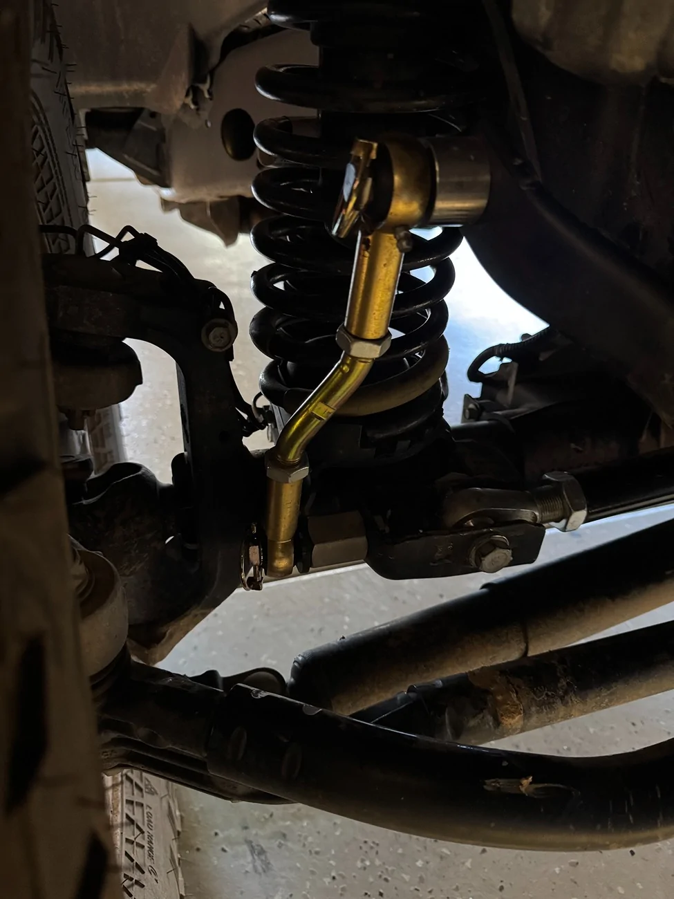

Either a Rubi sway bar with the manual EVO or Apex Lynx.
Best of luck.
