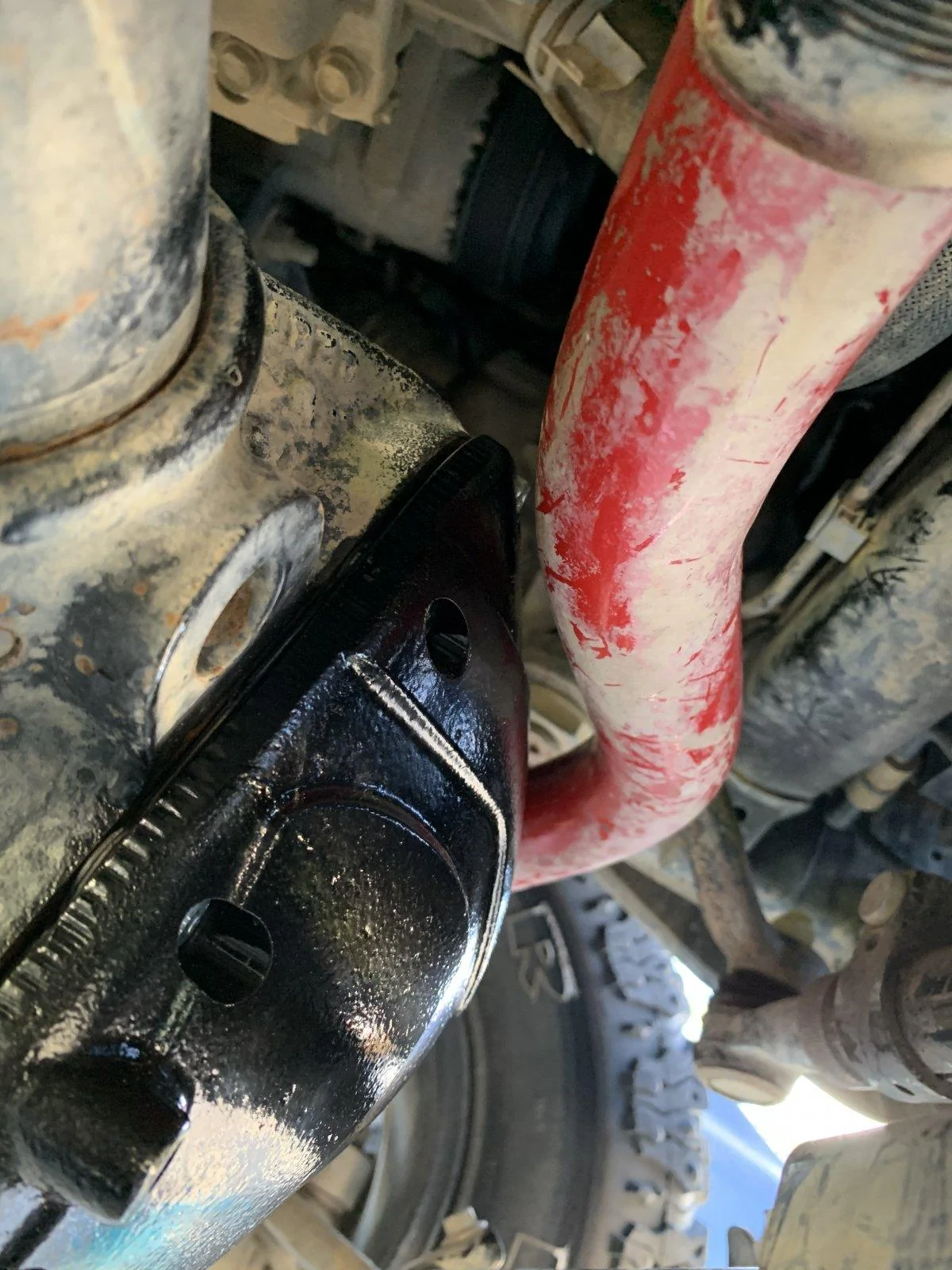

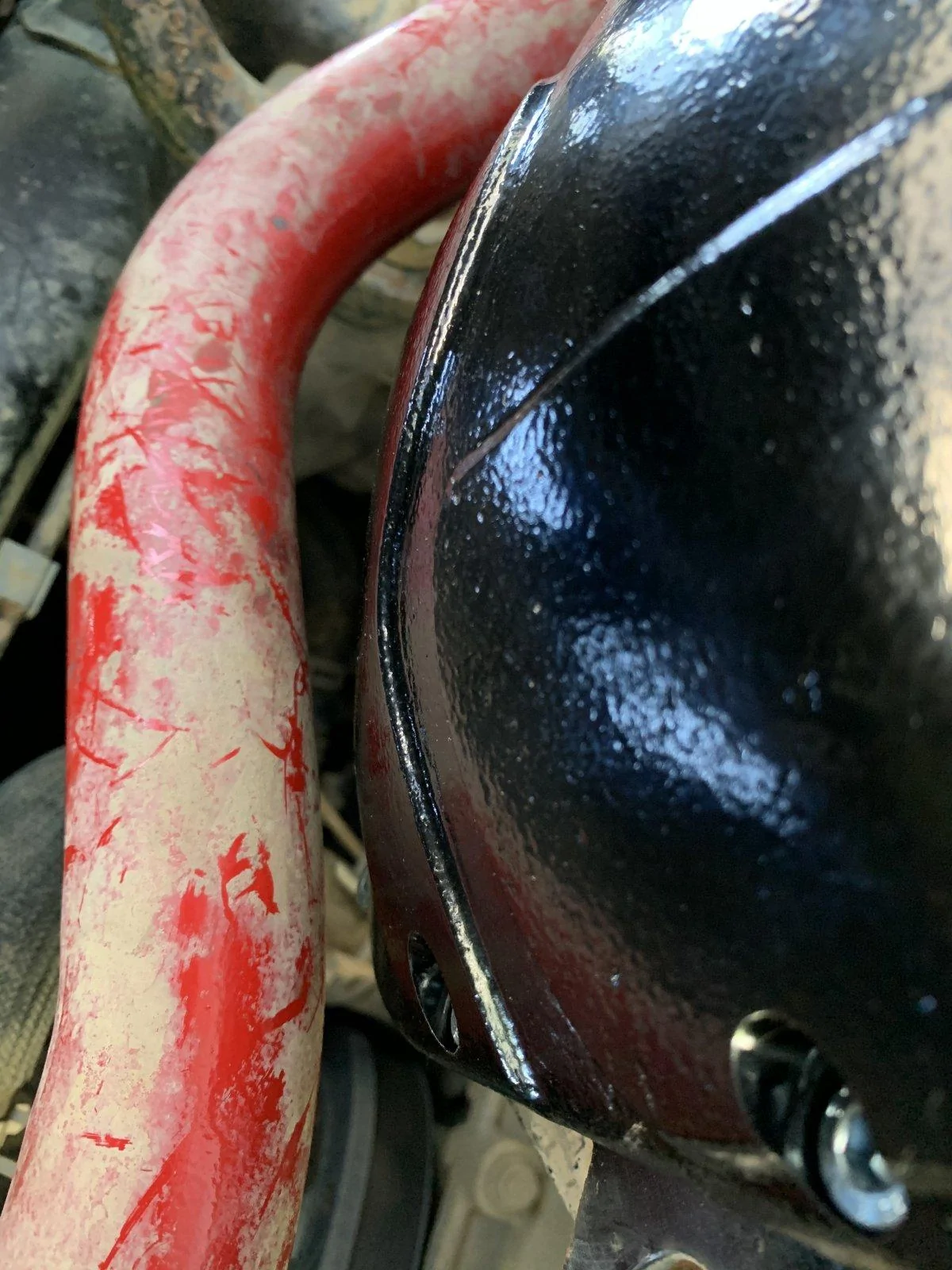

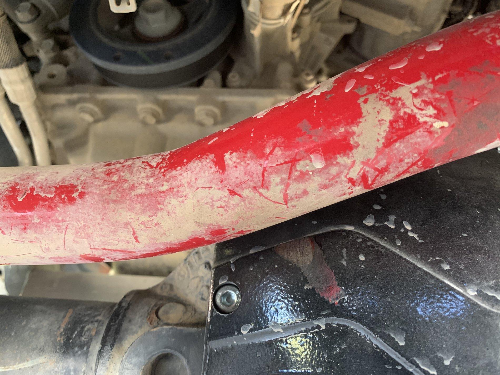

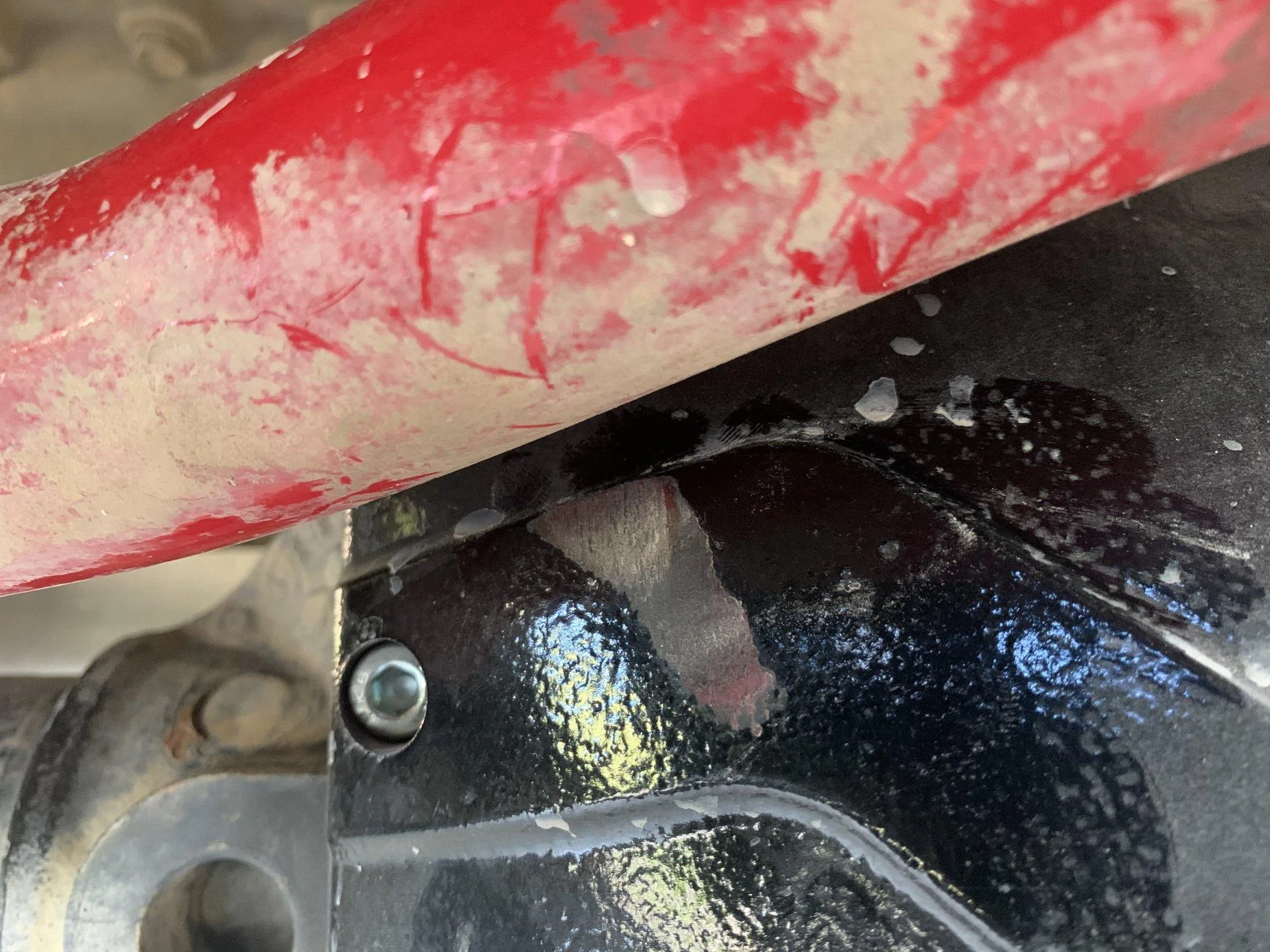

With the steersmart steering you have to be a little more cautious with with diff cover you go with due to the reduced clearance. I know the arb sticks out quite a bit. We run the motobiLt and it gets really close to the cover but it barely clears. Metalcloak released some nice ones too but I haven’t checked it against the steersmart stuff yet

Do you have a pic of how much clearance you have? I’m currently running RK track bars but considering swapping to SteerSmarts but have Motobilt diff covers sitting in my garage to install when I do the 500 mile check after the re-gear.
I can try and remember to snap one tomorrow. Any reason to not stay with the RK TB? I don’t think you’d be gaining anything going with the steersmart in practical strength.
