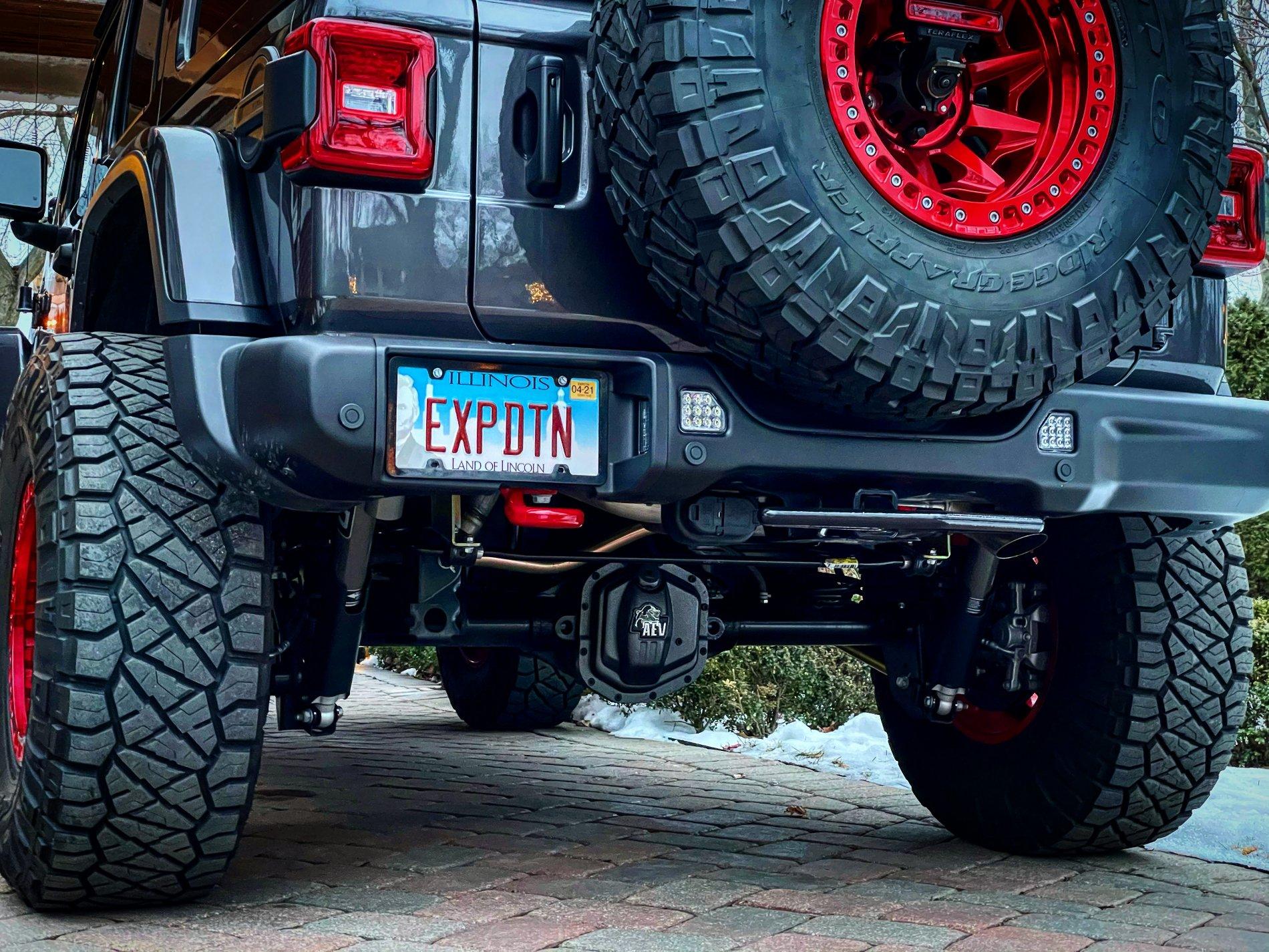

I like the covers a lot but you should know something about running diff skids with them. On the rear I am running the Metal Cloak golden diaper and the fins of the diff cover do make contact with the diaper. This has not caused ANY problems. You can see the skid rubbed into the cover a little bit until they were both happy living together. So don't freak out if you see this, it has no bearing as the Jeep has had the snot wheeled out of it with this setup for many thousands of miles.

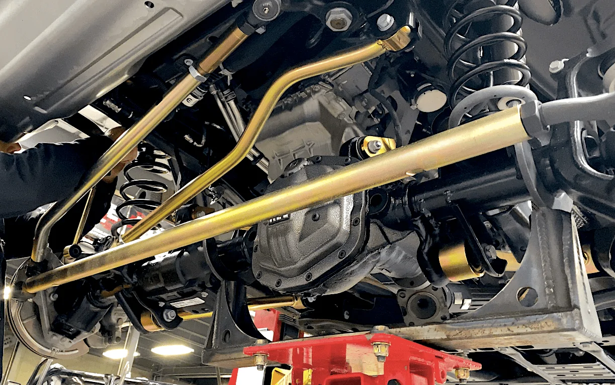

I am running the Rancho skid up front and if you choose to run that skid with this cover you will need to run to the hardware store and buy a long piece of threaded steel. Basically a 12" or so screw with no head on it, the reason is the one Rancho gives you barely fits the diff with a stock cover and when you have the Dana cover on it winds up being just a tick to short. Simply bend the piece of threaded steel you bought into the correct U shape and use it instead. It's very straight forward and the Rancho skid and Dana cover play nice together.

Front - The drain plug is exposed on the bottom of the axle and prone to damage which can make for a very bad day. Feel free to read up on my experience with this happening to us on the rear axle before we upgraded to the D44 axles. The Rancho skid protects that plug as well as the front lower portion of the diff cover.
Rear - The diaper does a great job of protecting the FRONT side of the diff and allows you to slide over things.
These covers are meaty and can take a hit but the reality is you don't want stuff hitting them if you can avoid that. The covers you and I have to a great job of OVERALL diff protection... i.e. not just protecting the cover. NOTE: the cover does nothing to protect the rest of the diff.
Both of our Jeeps run the Rancho up front and MC in the rear and both skids have taken a beating and been worth every penny because they kept that beating off of the diff and the diff cover.

I’m running Motobilt on the front and back. No clearance issues with Steer Smarts track bars and will be (still haven’t installed them, haha) compatible with Rancho front diff skid plate and MC rear diff skid.
