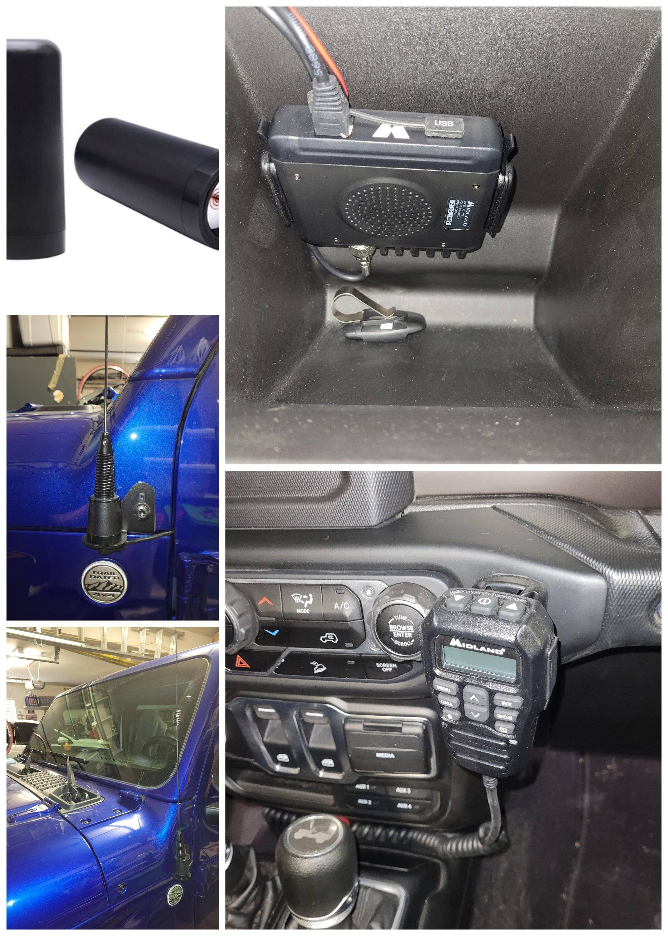

The midland is a great choice. With the controls on the handset, you can tuck the body out of the way - mine is mounted in the glovebox.
Get both the 6db antenna and the smaller ghost antenna. I run the 6db as standard - in the desert, so lots of open space. My 15 watt unit can easily hit l.o.s. repeaters from 50 miles out - but toss on the ghost when running in tight canyon or heavy forest as it gives better 'close in' coverage due to signal shape...

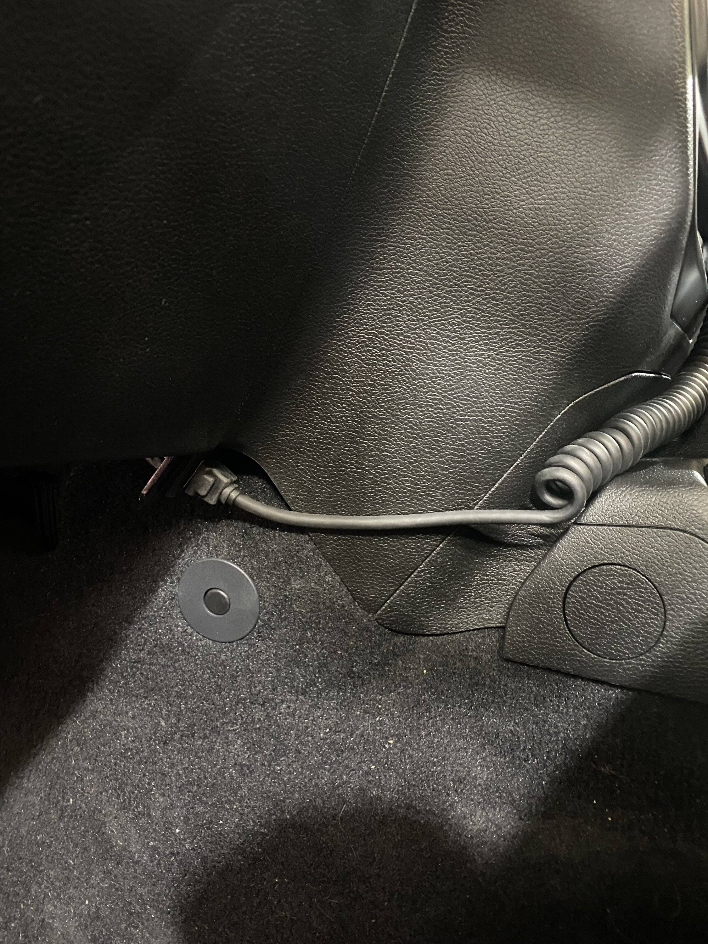

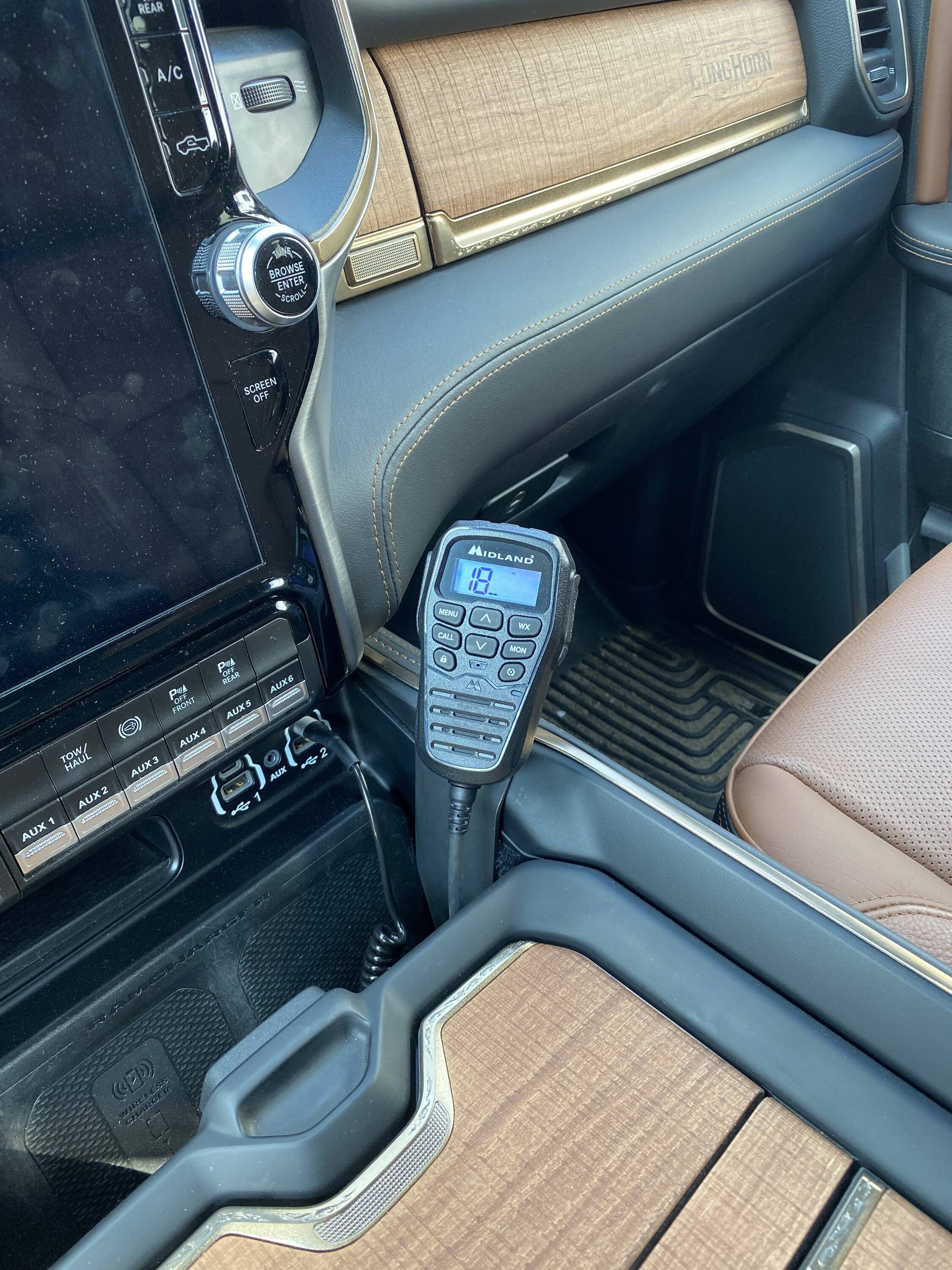

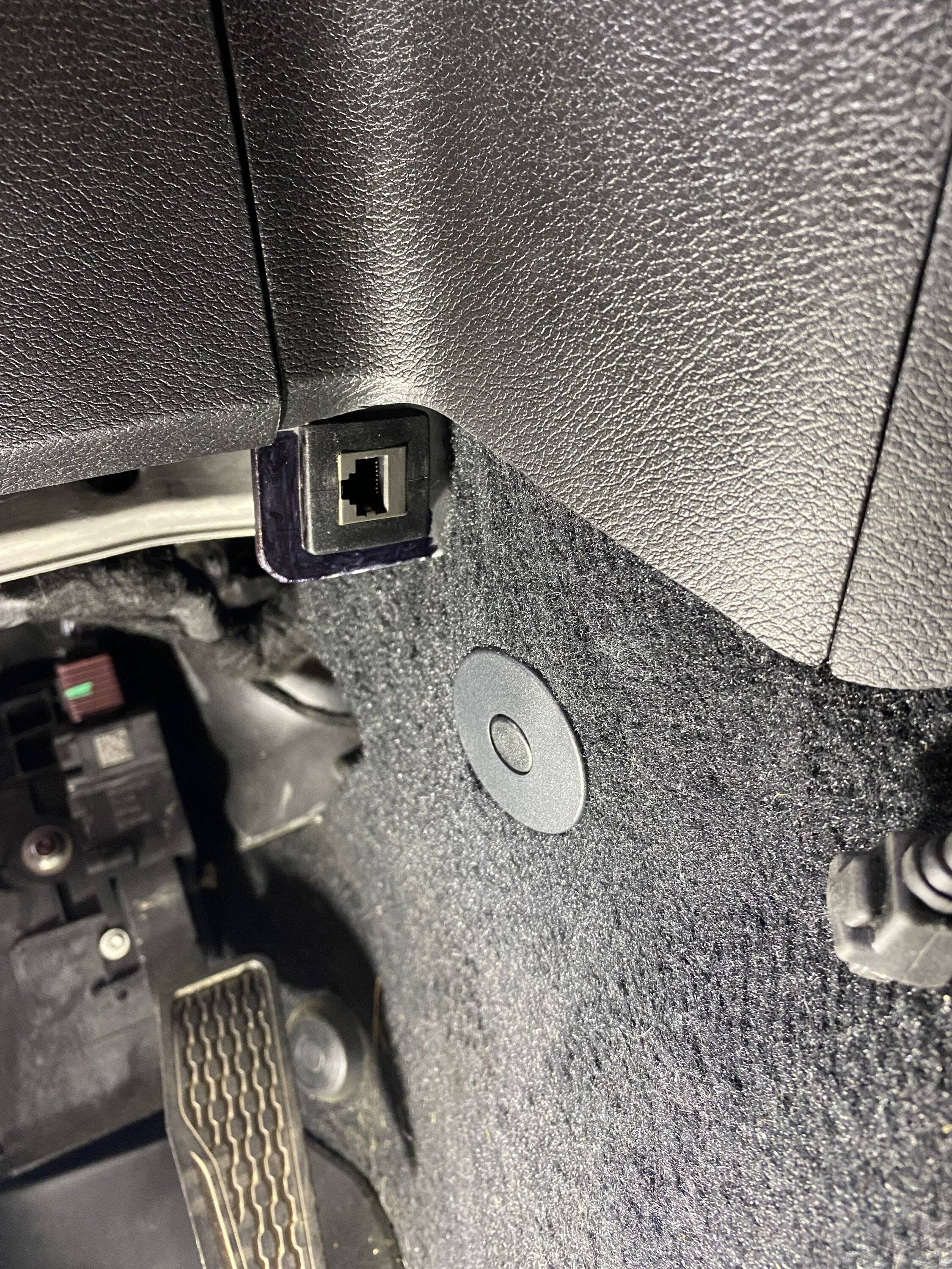

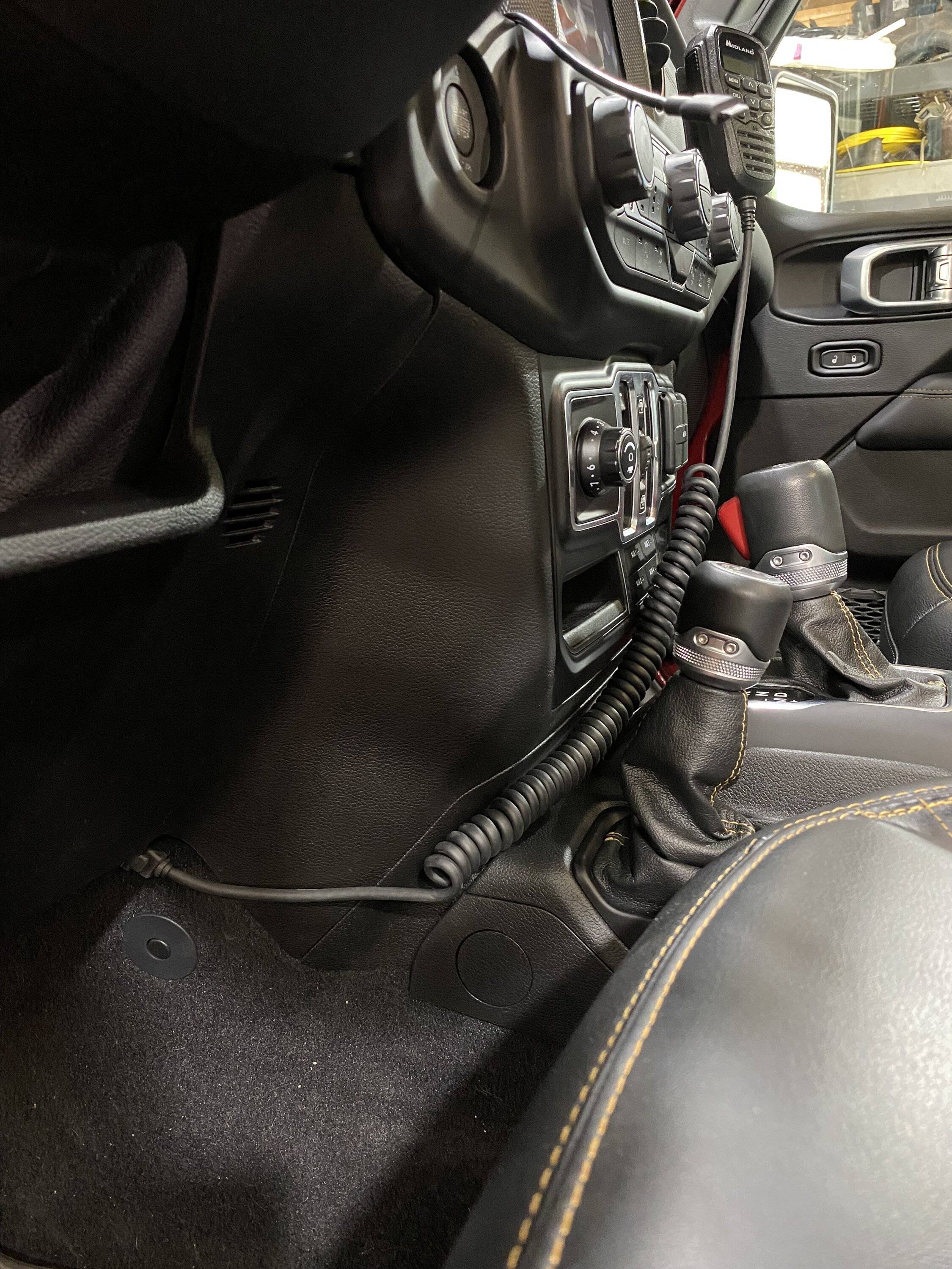

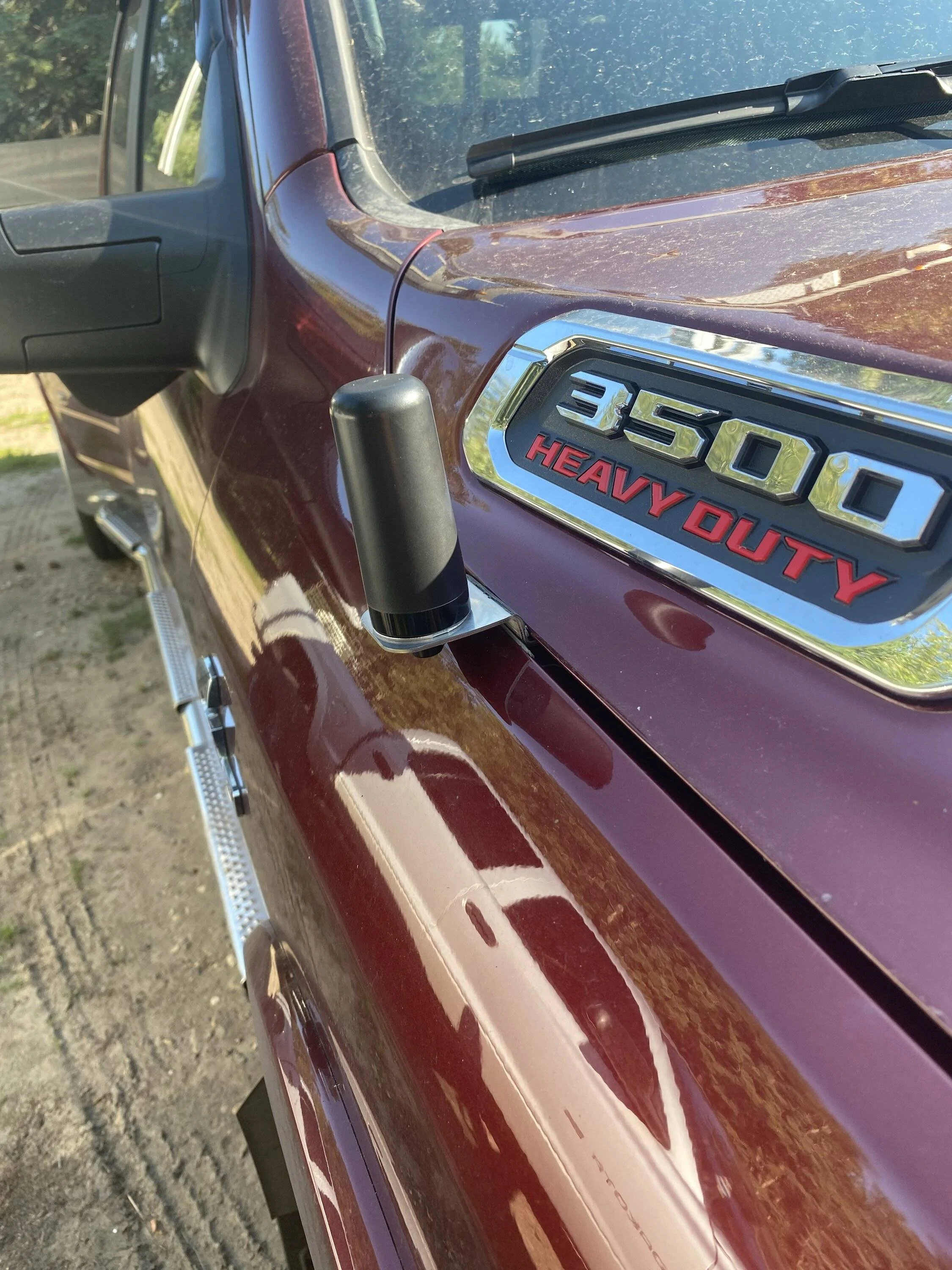

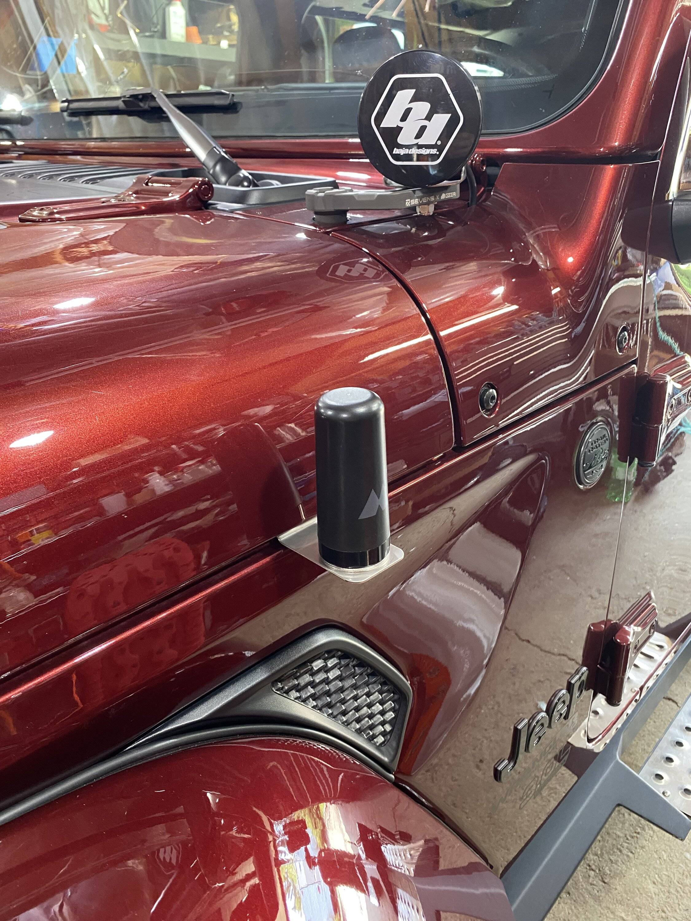

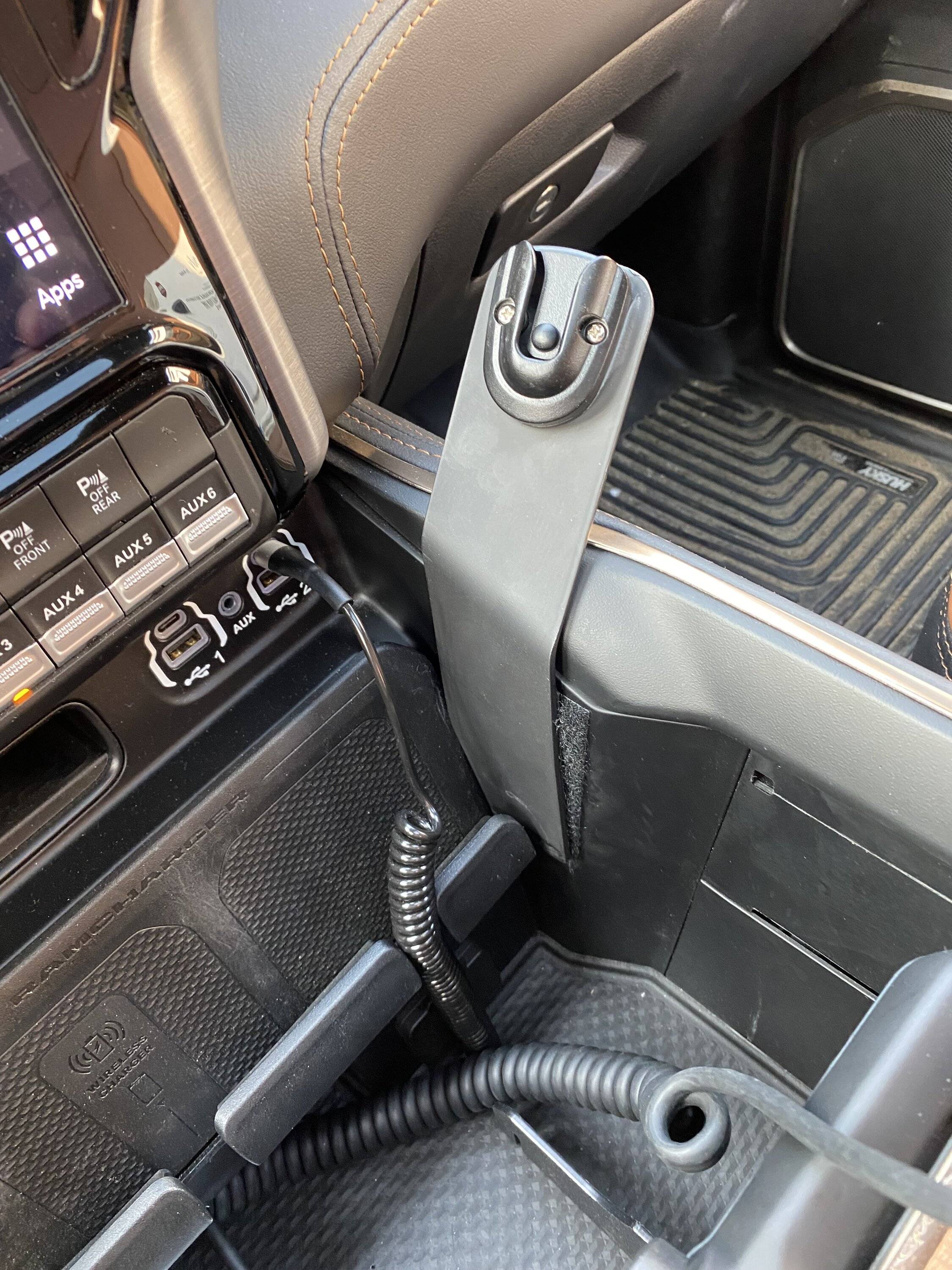

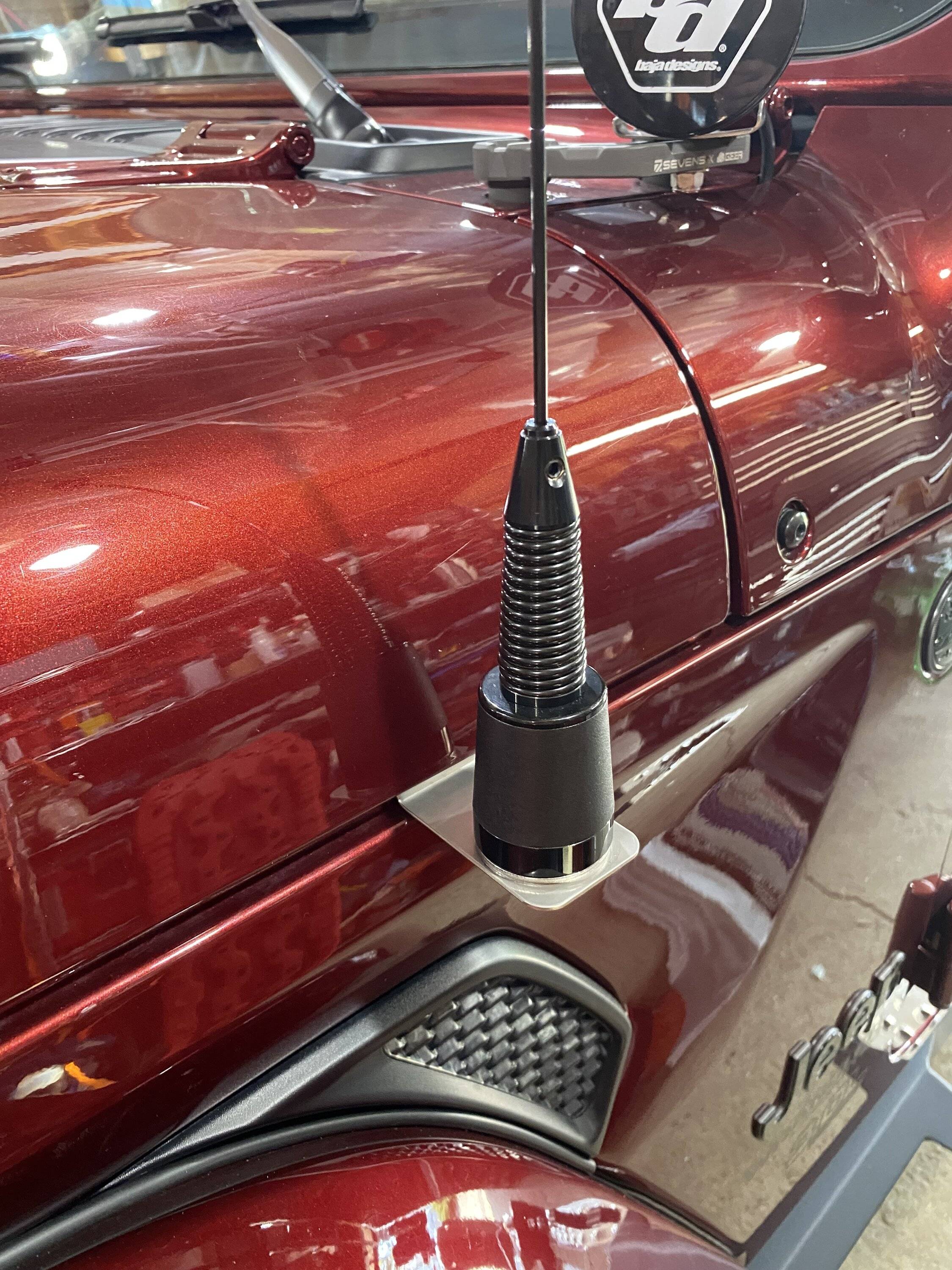

A vote for the Midland MXT 275 here for simple turn it on and it works, no programming etc. Clean easy to hide base unit as well. Mines under the drivers seat and I routed a cat 6 network cable extension so I can just unplug the handset when not needed.
Did the same on my pick up so I can just swap the base and handset quickly to the truck for road RV travel with family. I’ve got both the 3db ghost and the 6db whip antennas. I did the same network plug in the bottom corner of the truck console. On my first trip with it now in the truck with my sister using a handheld and it’s been awesome. One day I’ll just buy another unit so both have one. I’m just too cheap right now?
