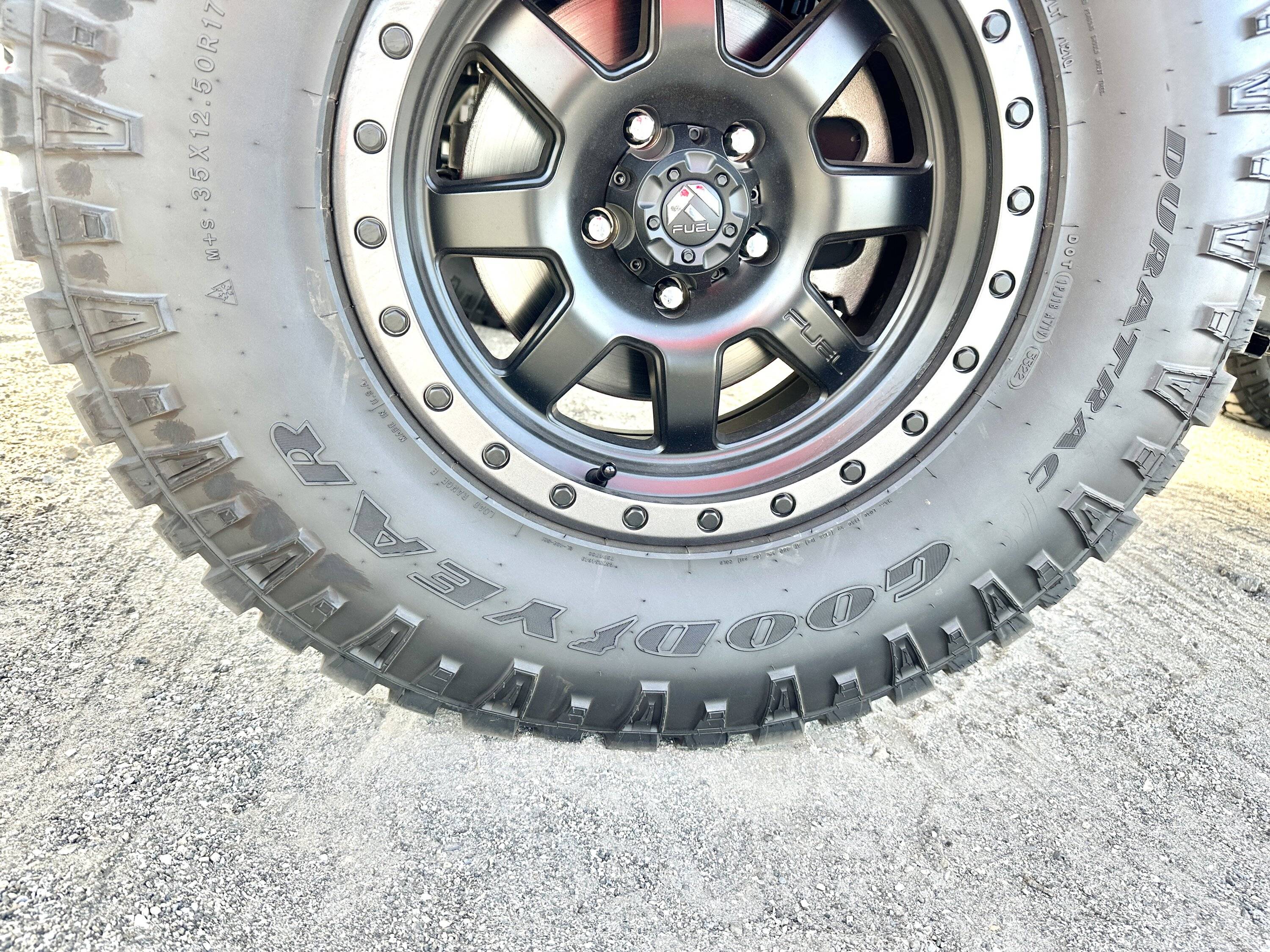

Been tinkering with PSI on my JLR. What I have finalized is: 33.5. Front, 32.5 Rear Street only.
Tires: 35 x 12:50 X 17 Goodyear Duratrac
Wheels: Fuel 17 x 9.5
Jeep is OEM stock except for the tires and wheels
The pics are showing the contact patch which I used to arrive at the PSI required. Laterally you want to go edge to edge but not over the edge of the shoulders. This optimizes the mpg, braking, and coefficient of traction.
NOTE: This only applies to my JLR, these tires and these wheels. Your psi with the same tires may arrive as a different number albeit close.
The was captured in the flat dirt (dust) parking area. The dust had not been watered down (they were watering down the parking area but had not got to where I was driving thru.

I run 28 psi cold. Anything over that and the tires don't wear correctly. I would think 33 and 32, like your at would cause the tires to cup real bad. Did you do a chalk test or just basing the pressure off of ride quality?

Be aware that the weight of your Jeep impacts all of this. That makes boilerplate suggestions about tire pressure somewhat challenging.
Supposedly you can measure the size of your tire's contact patch (width times length in inches), multiply that by four (4 tires), and multiply that by your average tire pressure in PSI. That should, according to the math / science, give a decent estimate of the weight of your vehicle in pounds.
