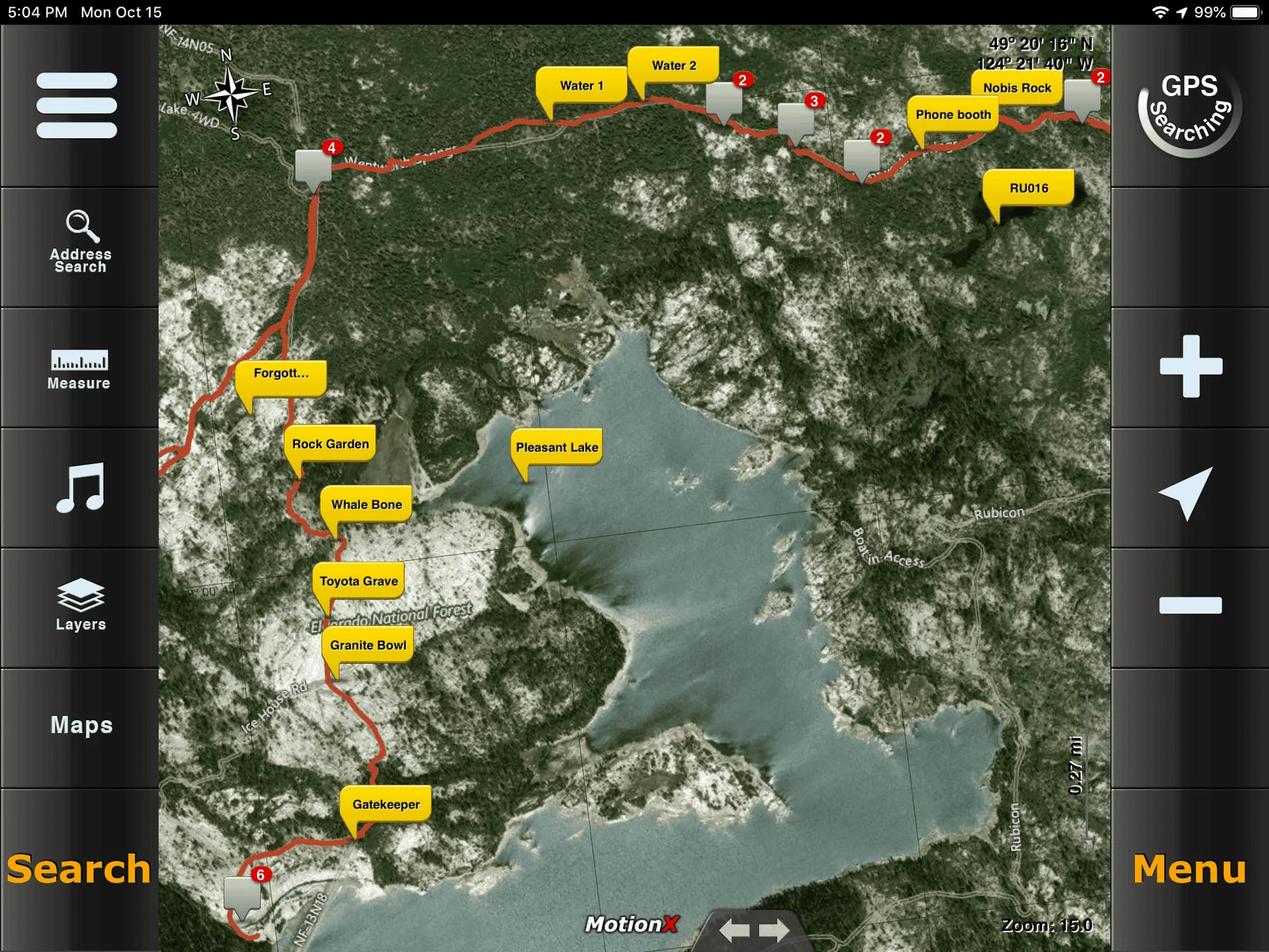

I have been using Avenza. But always looking for better..

Is this App good for Jeep trails as well or just hiking and biking.
It’s excellent. You can download satellite images for the area so you don’t need a connection. You can import/export tracks and waypoints. I have the rubicon trail imported already for my trip next year.
