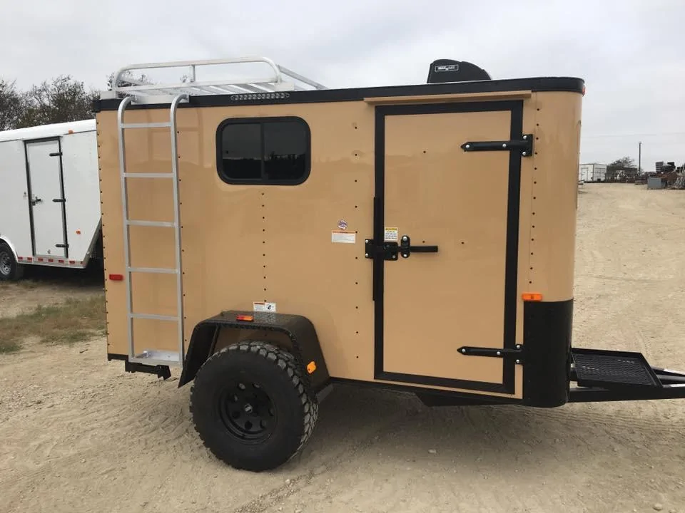

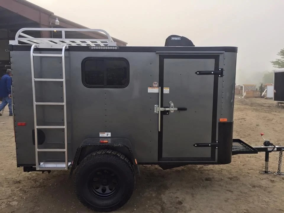

I’ve been eyeballing Cargo Craft’s “off road” line for a bit. They make a few custom rigs depending on personal needs. I’m pretty much settled on my “Tramper” (trailer-camper) decision....Best of both worlds for my needs since I can have it customized with tons of features. Coloradotrailers.com is a dealer but any Cargo Craft dealer should be able to order.
The first pic is the exact trailer that I own. Its sweet. I put a Rhino Rack 2.5m Awning on it. I have yet to build out the front end with a system to hold my tubs and fridge on a slide, but dual purpose. It hauls my BMW and I can camp in it as well.

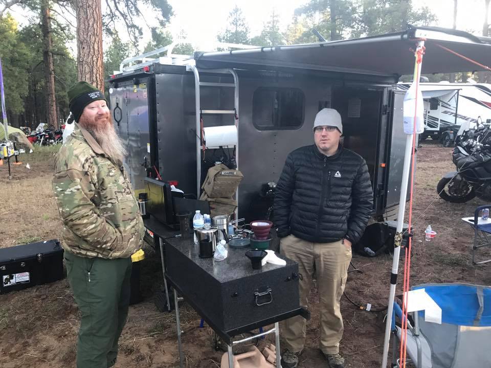

Here is a poor pic of my trailer in action last year at Overland Expo.
I plan on going this year...hope to see you and that trailer there!
