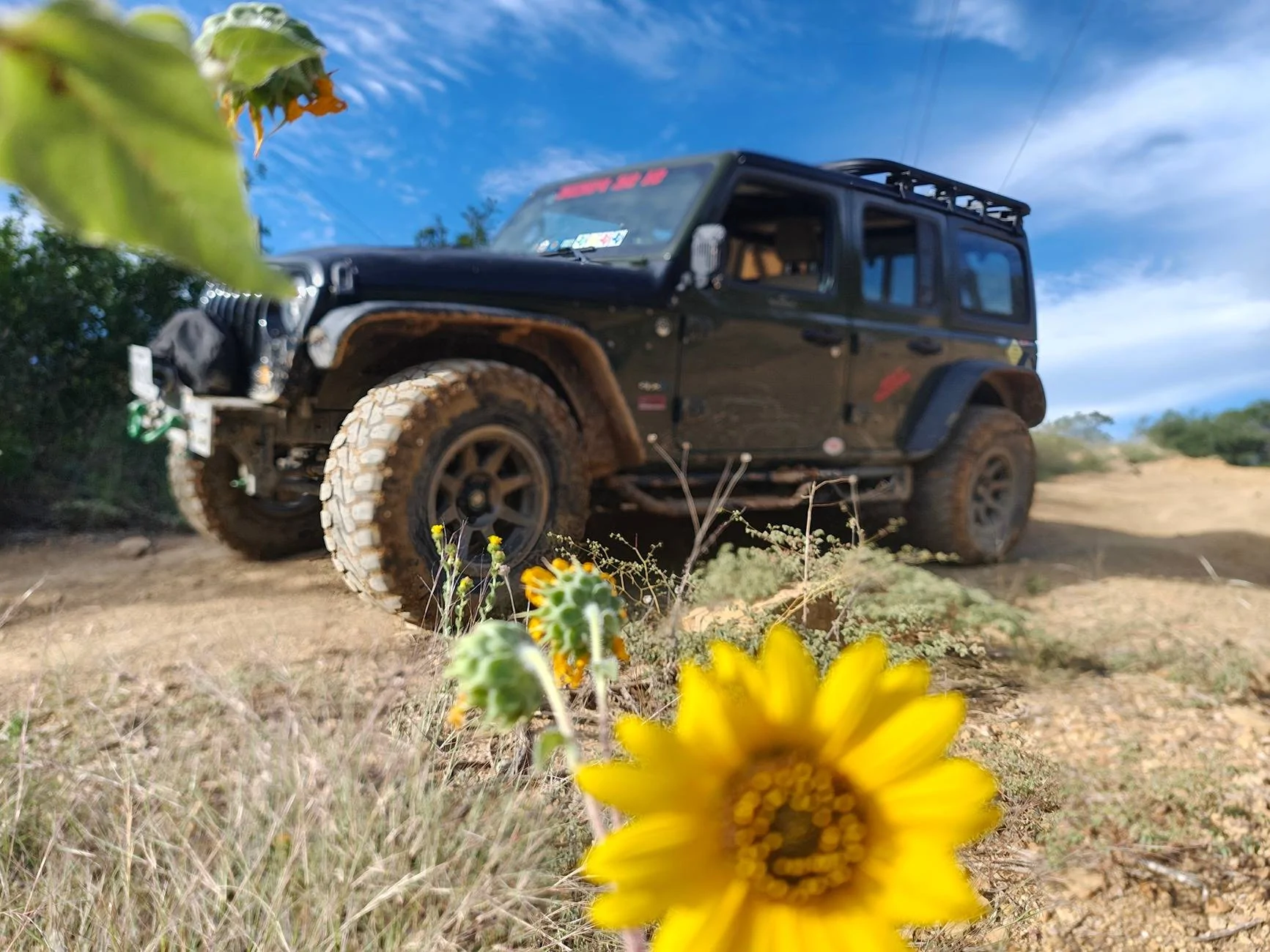

I've been running Icon Rebound Pros (never heard of the recon pros, maybe that's something new?) about a year and a half now. Mostly Street driving, but at this moment a handful of times off-road. I know for a fact you can go down to 10 psi with zero issues debeading.
Talk to pictures are on Sunday at Northwest OHV in Bridgeport Texas. Did some pretty hardcore trails as you can see in the second photo. That was quite the drop.
Jeep Wrangler JL Beadlock Wheel Experience / Opinion 1000003579
Jeep Wrangler JL Beadlock Wheel Experience / Opinion 1000003660
I was running 18 PSI just because I don't have a lift and I wanted the extra ride height.

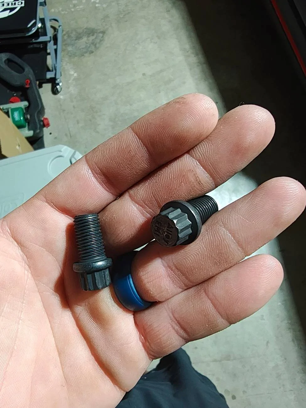

Personally I like the fact that I can legally run "interlock" wheels on the highways and byways. Personally I think they are actually better than beadlock Wheels. Can't tell you how many people I see running beadlock Wheels and their rings are heavily damaged and how many stories I've heard of people out in the middle of nowhere knocking their rings off. You can't knock my rings off, there are no rings to knock off. If I scrape the crap out of the side of the wheel, in the rim area, it might gouge the rim, but it won't leave me stranded. Kind of a nice feature to have if you ask me!
I definitely think it's an upgraded technology from beadlock Wheels, interlock technology that is.
If you do get these, I can point you in the direction of some lower cost replacement bolts and even some shorter bolts to plug the holes but so that you can still run them as non interlock wheels.
Jeep Wrangler JL Beadlock Wheel Experience / Opinion 1000003698
It's pretty costly to put tires on beadlocks, or in this instance interlock wheels. If you throw these bolts on there yourself first, you can save yourself about $300 bucks.

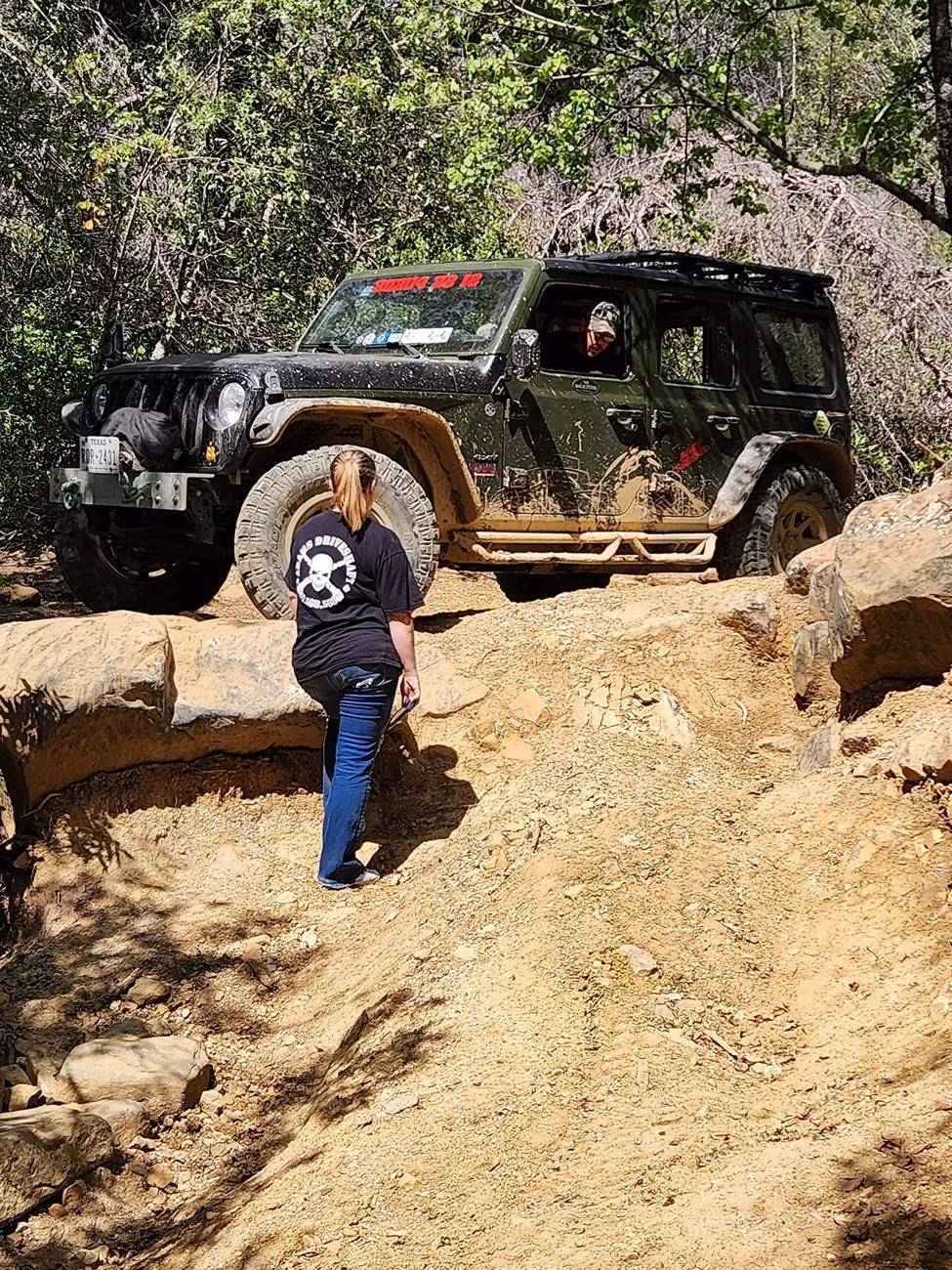

I am running Method 106 Beadlocks and I love them. You do need to retorque the wheels every month. Thats 25 bolts Xs 5 for me. I do mine on the first of each month.

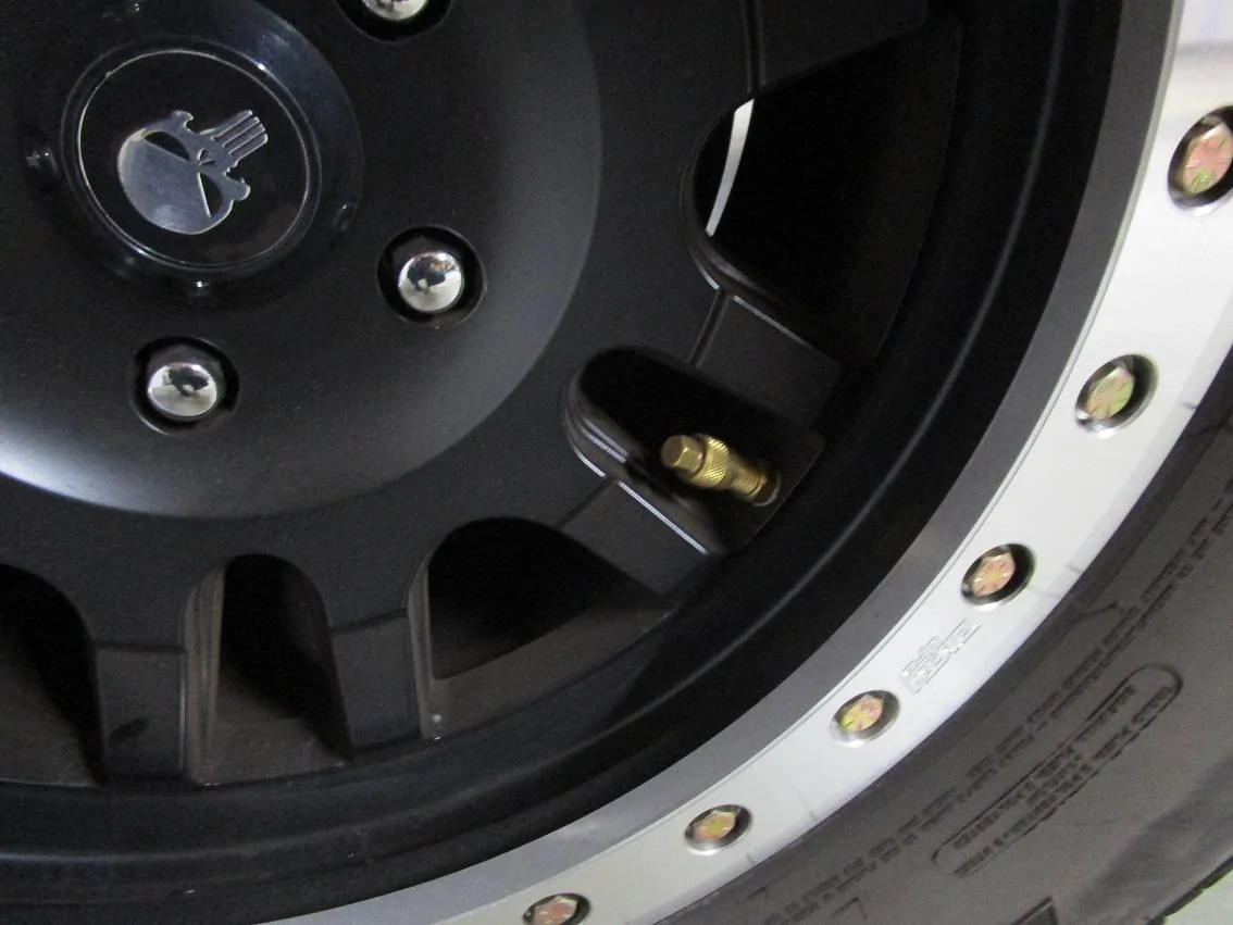

I am running Dirty life bead locks with large bore tank valves I installed. They cost about $6 each.
You have to drill and tap for 1/4 pipe.
I can air down one tire to 10psi in 30 seconds and air up two tires at the same time to 30 psi in 2 minutes using an ARB twin compressor.
3/8 hose and large fitting are the key to get air volume to refill.
I also carry a torque wrench with a socket on it for fast re-torque check.
