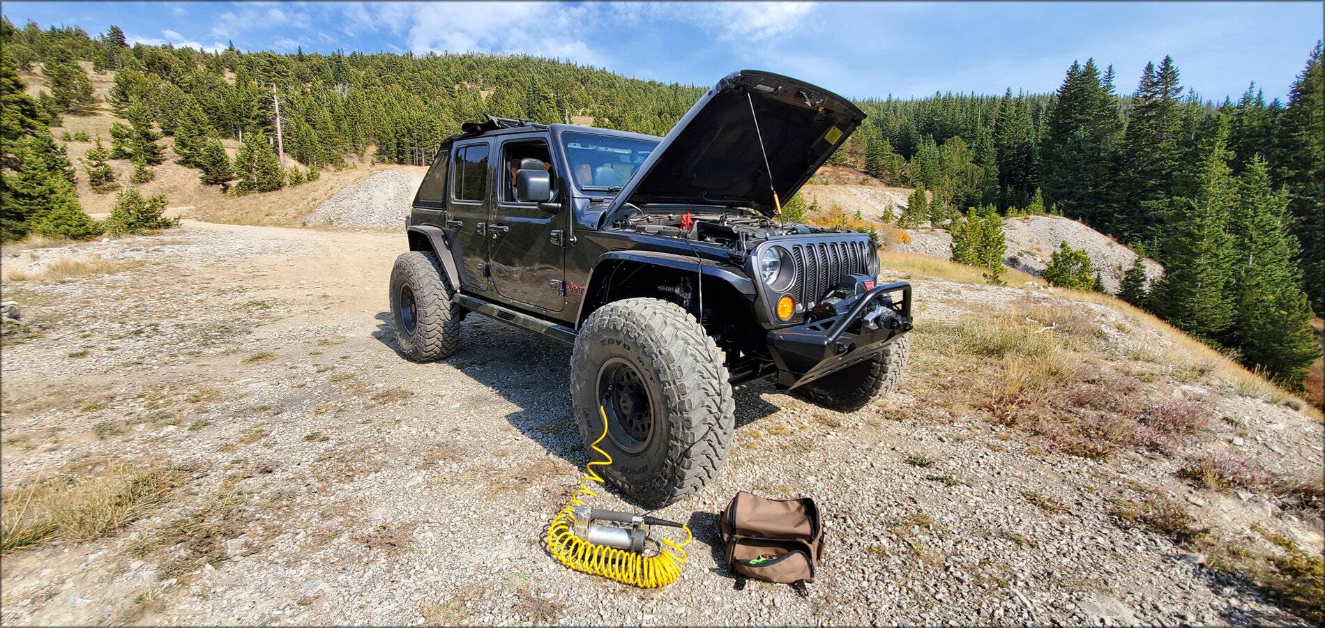

I use this locking air chuck... It does not fit well in the Dirty Life wheels.

The locking air chuck I use

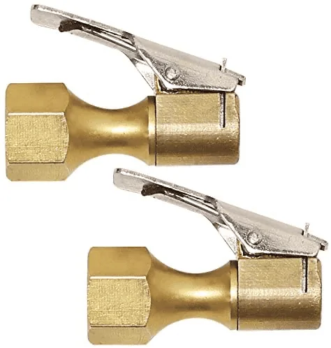

There are other locking air chucks. They typically just lock on one side and my experience is they just don't work as well, They will work with the Dirty Life wheels though.
Something like this,

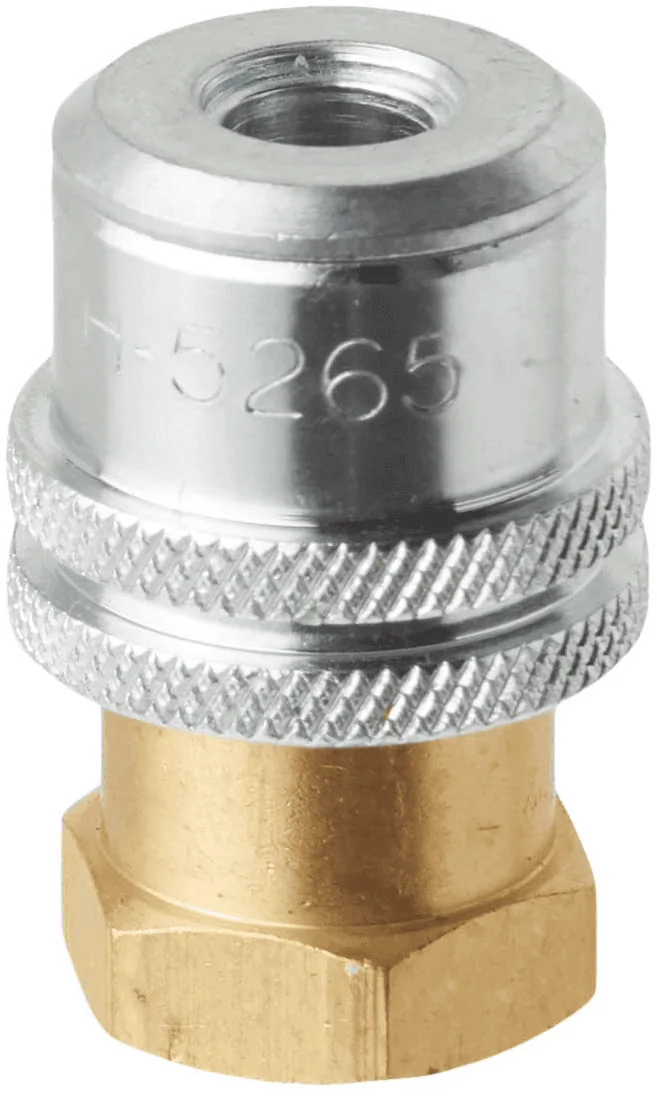

I use MORRflate kit that has the wider Haltec air chucks on all four air hoses. I meant to ask @DOOKEY and Hutchinson if their wheels are compatible.

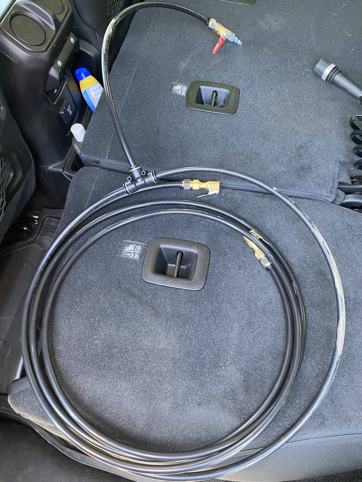

I use this type with no issues. Clips on so you don't have to hold it. I use a full metal valve stem so it removes the wigglyness of the rubber stems.
The lever type end only holds one side of the threaded valve, so it can leak. To use the Haltec valves, press it in, pull back the collar, it grabs the threaded valve on both sides, today sealed.
