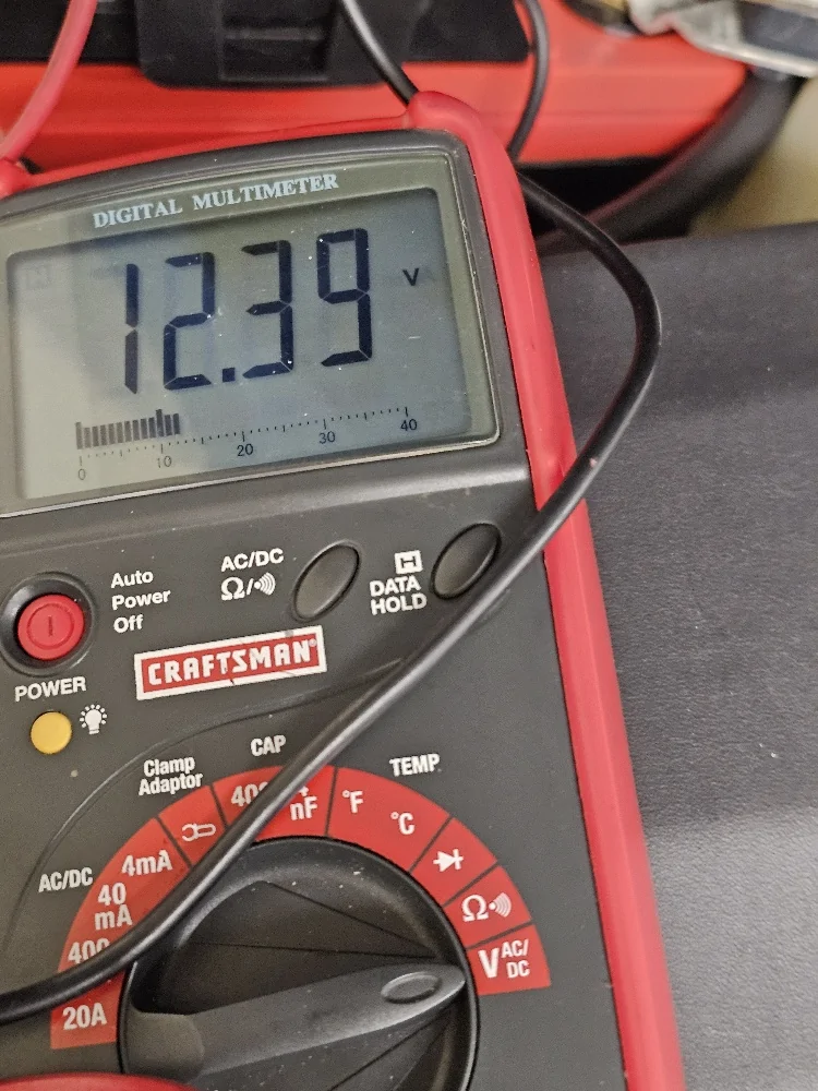

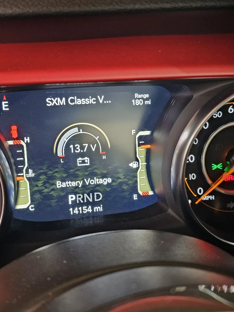

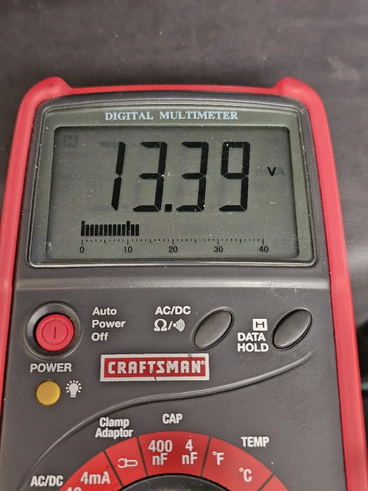

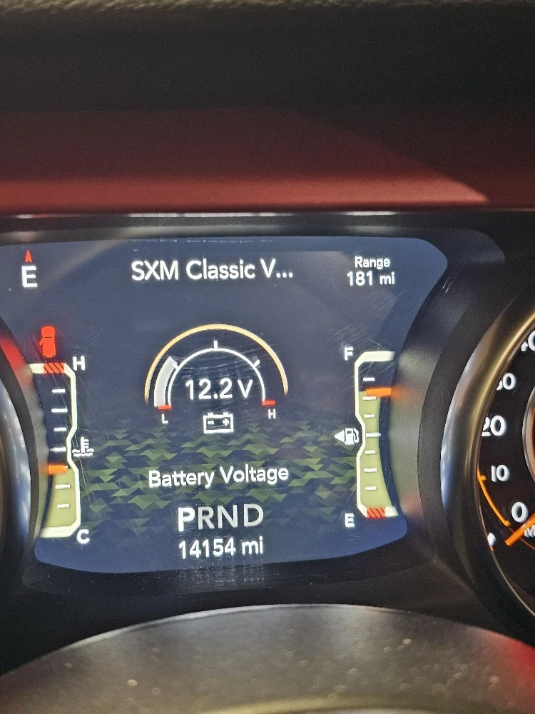

Oops, I guess I must have misspoke or flat don't know shit. Yep, the Voltmeter on the dash and the actual battery voltage are not the same. The actual difference between the voltmeter on the dash and my multimeter is approx. 2%. Yep, that is a huge difference and no way near of being accurate.
And this is with the engine not running. With the engine running, it is still about 2% difference between the voltmeter on the dash and the multimeter.
C'Mon, seriously!

I think the crux being “engine not running”. Again, don’t quote me on it, but the dash gives you a combined system output. It can’t tell you where your aux vs. your main is at. Also, 2% can be the difference between battery dead, and battery not dead. anyway - I don’t mean to offend you by doubting your measuring skills. I’m just saying that dash number has some interpretation to it.
Main Battery Only, I separated the aux battery from the main battery when I took the readings from the main battery
