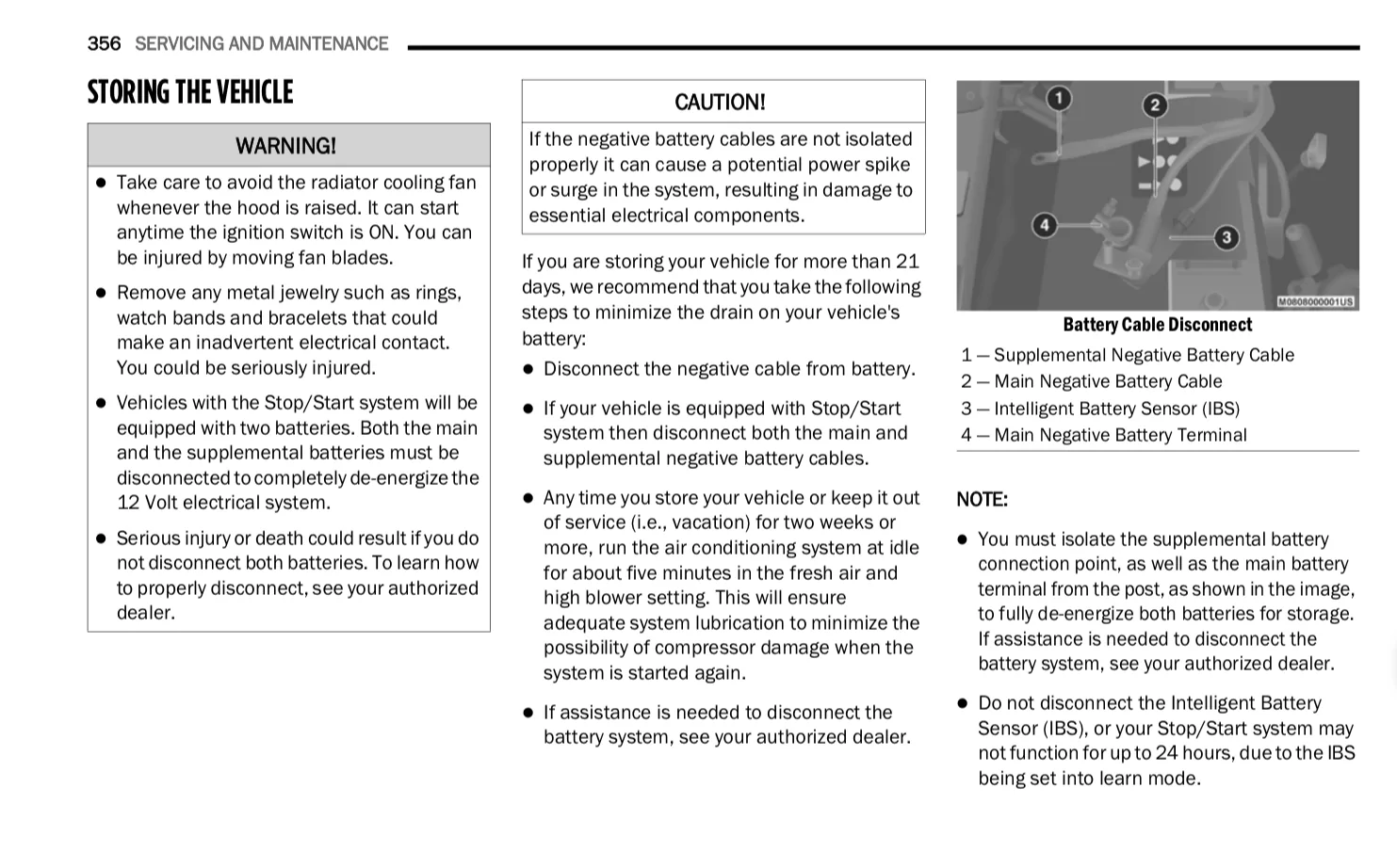

Planning on leaving my 2025 Rubicon X unattended in Colorado for a few months this winter and need to buy a battery tender. Looking for advice regarding brands and specific connections needed , taking into consideration I have the auxiliary battery. Prefer not to mess with it due to warranty concerns

Many people are happy with the NOCO 10.
Your placement of its leads on the main battery terminals with the vehicle parked will charge both the main and Aux battery, as these batteries are connected in parallel at all times when the vehicle is at rest.

NOCO chargers are highly recommended. You don't need a large one to keep your Jeep topped off while parked. The 2 amp will be more than enough.

Thank you. Wasn’t sure since the jump start and portable tire compressors connections are different

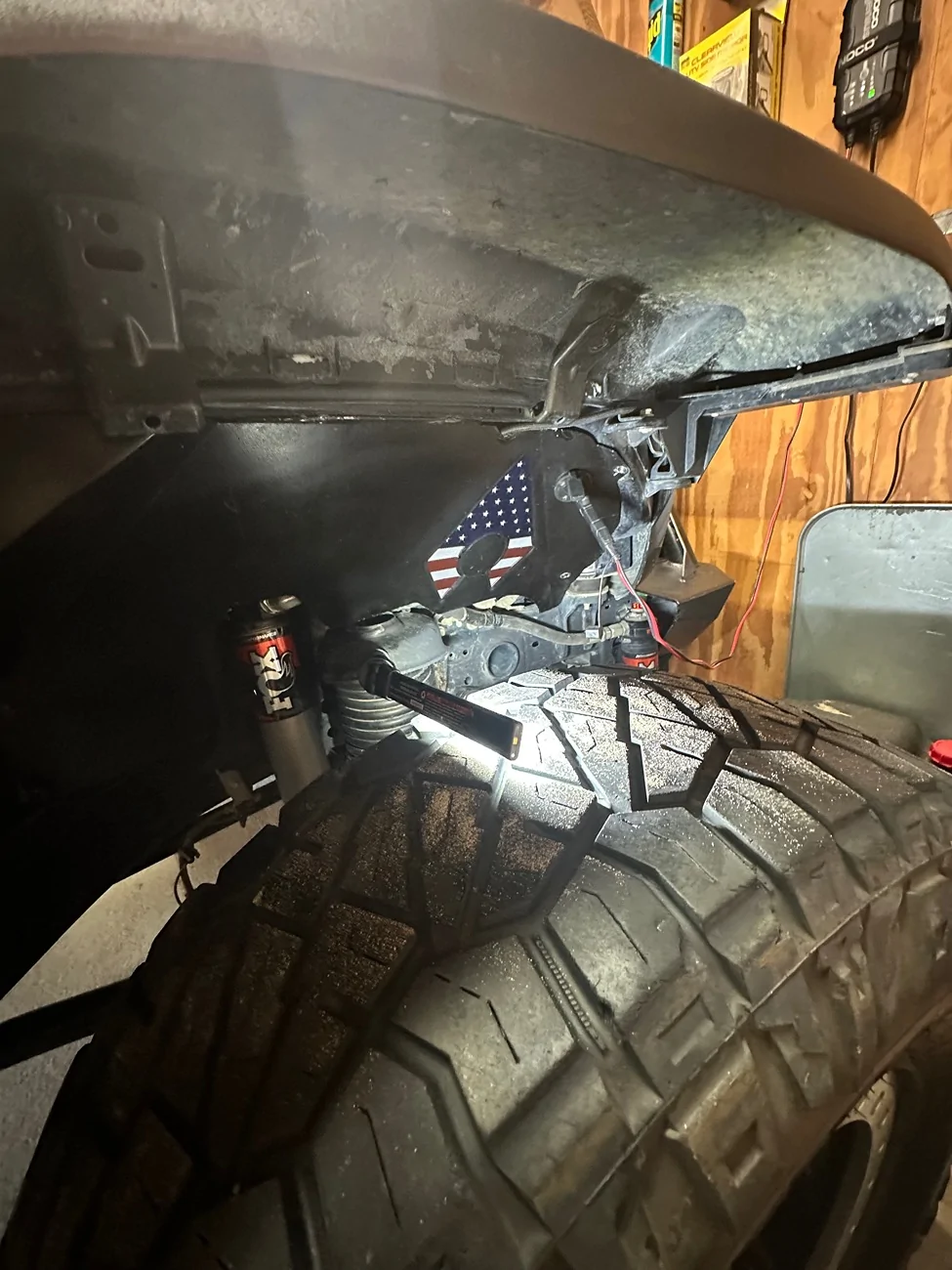

Because I usually only drive a few miles at a time, when I don't drive for a few days, I use the Noco Genius 10 and plug it into my towing connection.
