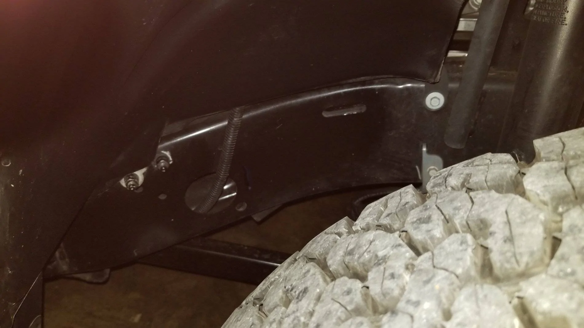

Buy a set of quick disconnects. Attach the quick disconnect to numbers 4 and 7 as shown in the picture below. Hook up like this and your battery tender / maintainer will do the deed for both the Main and Aux battery.
As for the disconnect cable... IF you buy the quick disconnect and a 2" short extension (eBAY) for the disconnect, you can actually drop the charge cable down and behind the fender liner.
Protect the cable with some plastic shielding and the capped end of it, you just lay in the frame rail hole til you need it..
When you want to charge, just lean into the wheel well, grab the cable end and plug into your battery maintainer...
No need to open the hood of the Jeep.

Thank you, Rhinebeck01 , that was extremely helpful. I almost private messaged you but thought I would put this out there for everyone in case someone else had the same question.
