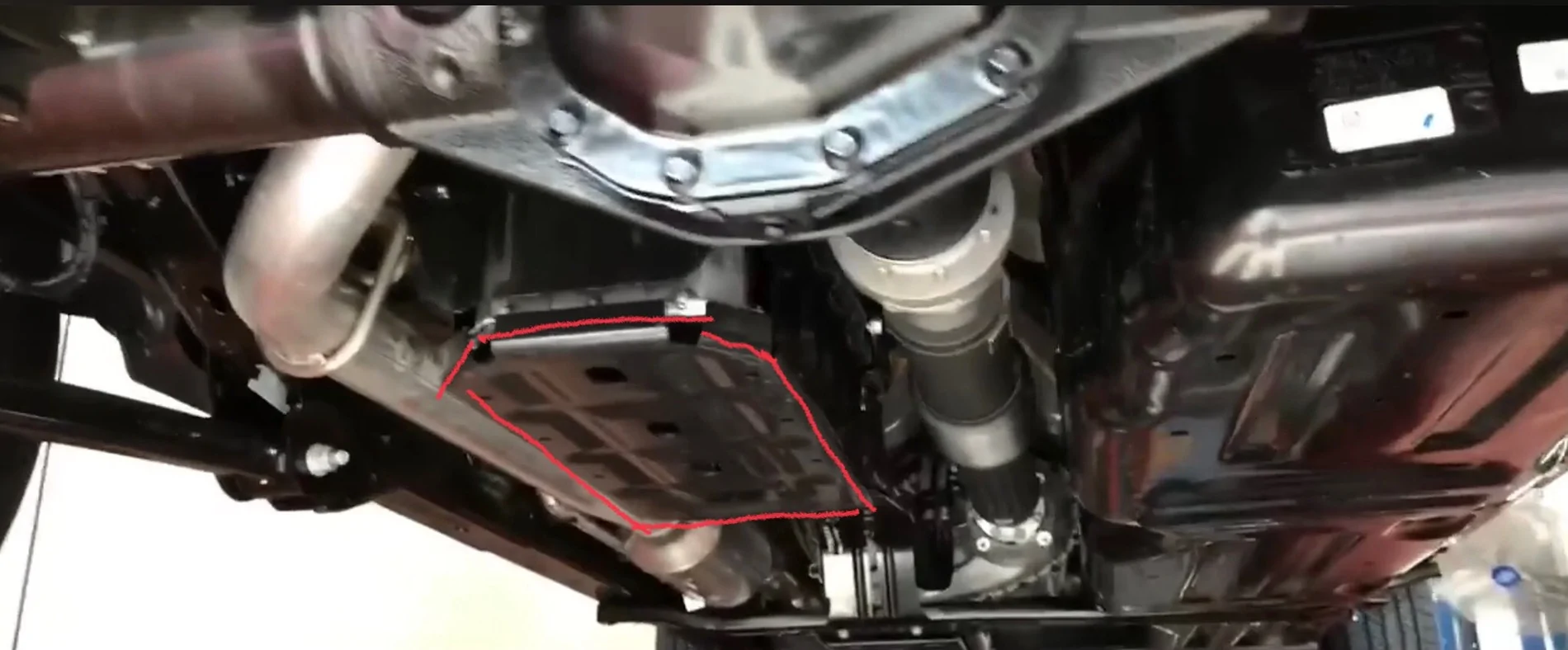

Agreed. As you discovered this topic has become overly complicated and confusing. Rather than suggesting people count battery cables or reservoirs or distinguish between an alternator and a belt start generator, people should simply be told to look under the Jeep. If you see this object outlined in red you have an etorque battery under the Jeep and an empty auxiliary battery box in the fender well. Sorry this happened to you.
