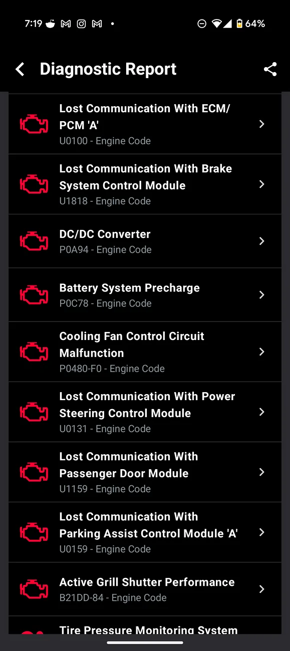

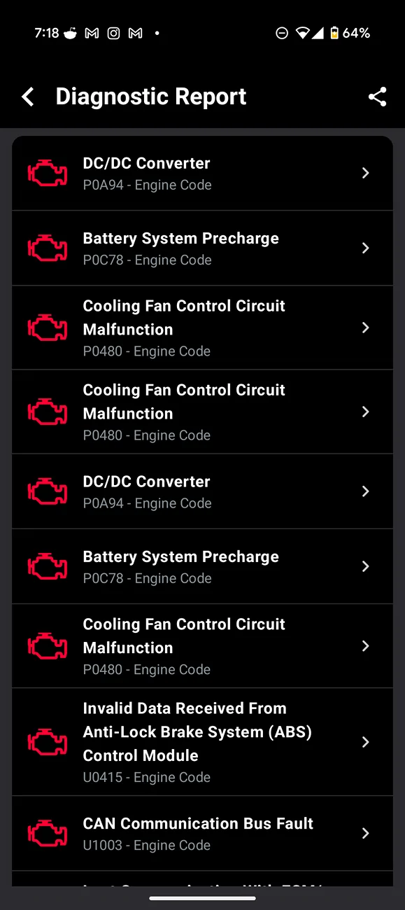

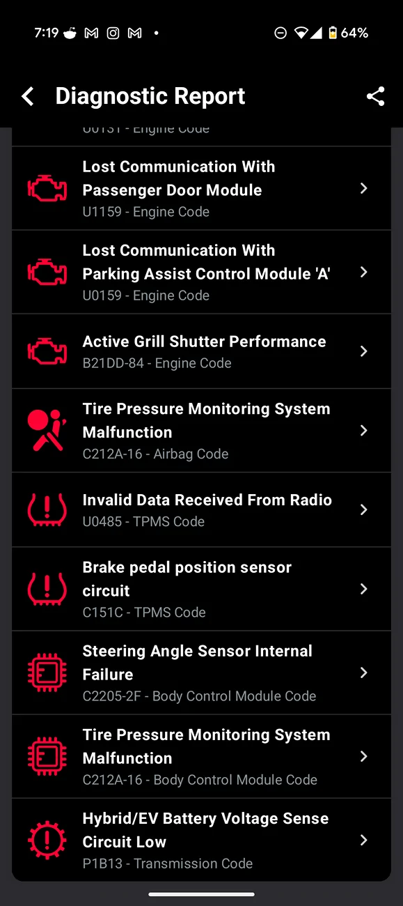

2018 JL e torque here. Had no start condition yesterday (push button, no crank). Tried switching the bypass on and off, charging main battery both ways. Eventually pulled the battery to bench test but something shorted in the process, electrical odor and discovered today that N6 in the high current fuse array, which is EHPS, was down. All other fuses in the array tested good. Replaced the fuse array.
It starts now, but radio unit is dead/no power, power steering and battery lights and displayed, my Tazer doesn't work and has no lights, and ODB2 pulls these codes.
P0A94
P0C78
P0480
P0480-F0
U0415
U1003
U0100
U1818
U0131
U1159
U0159
B21DD-84
C212A-16
U0485
C151C
C2205-2F
P1B13
Where should I start? Seems like maybe can buss?
