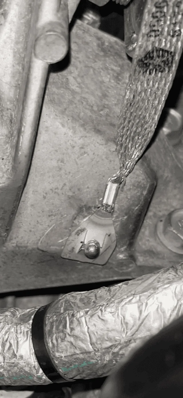

Not sure my reply will help, but I'M following a Youtube chain called South Main Auto. And what that the mechanic there thought me is that chassis grounds are the mother of a huge number of electrical issues, like good alternators not charging the batteries, ECM glitches etc.. If you live in the salt belt, corrosion of those big copper tress chassis/body leads can create havoc on your electrical system as the might look ok but be corroded from the inside thus not allowing enough current to pass through. From that mechanic,s experience, seems like a lot of dealers go for the obvious and just load the parts cannon... This is an example of a damaged ground lead on a grand Cherokee
