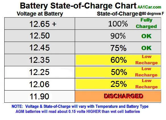

I ran into oddball issues with my 12v battery a little while back. I hadn't realized that a swing of just .3 volts can be the major difference between starting or not. I have a 4xe and even when the HV battery is 100%, we still need the 12v to start the vehicle.
One thing I learned and to keep in mind, is that the alternators of today don't "charge" the battery like the older vehicles. When I was coming up, the trick to keeping your car battery topped off was to run the engine for a bit. There is a post around here somewhere, where someone went into some pretty good detail about it - I think it basically boiled down to the alternators today simply don't put out the amps like older cars. There was another around here that showed that eventually, the alternator can top off a battery, but you are talking of hours of driving.
I even tried using a trickle charger on my Jeep and that was another learning opportunity; those 2AMP chargers just don't do enough either. As someone else mentioned, there is a parasitic power draw on the Jeep's - you really need a 10AMP charger if you really want to top off your 12v battery.
