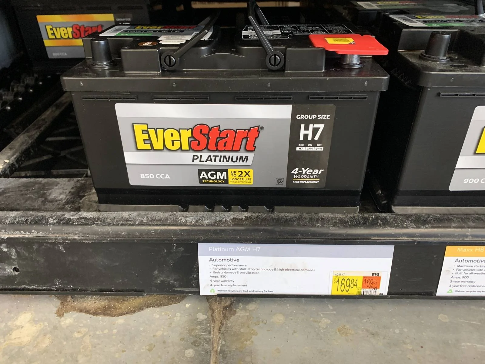

Don't waste your time testing batteries. Change them both. You old main battery has likely sucked the life out of your new aux battery. Even better would be to remove the aux battery and put in a Group94/H7 battery in for the main. You will have nearly the same battery power and the simplicity of just one battery to worry about. There are tons of guys and gals here who have changed to one battery and shared how they did it. Look in the forum in the battery section.
