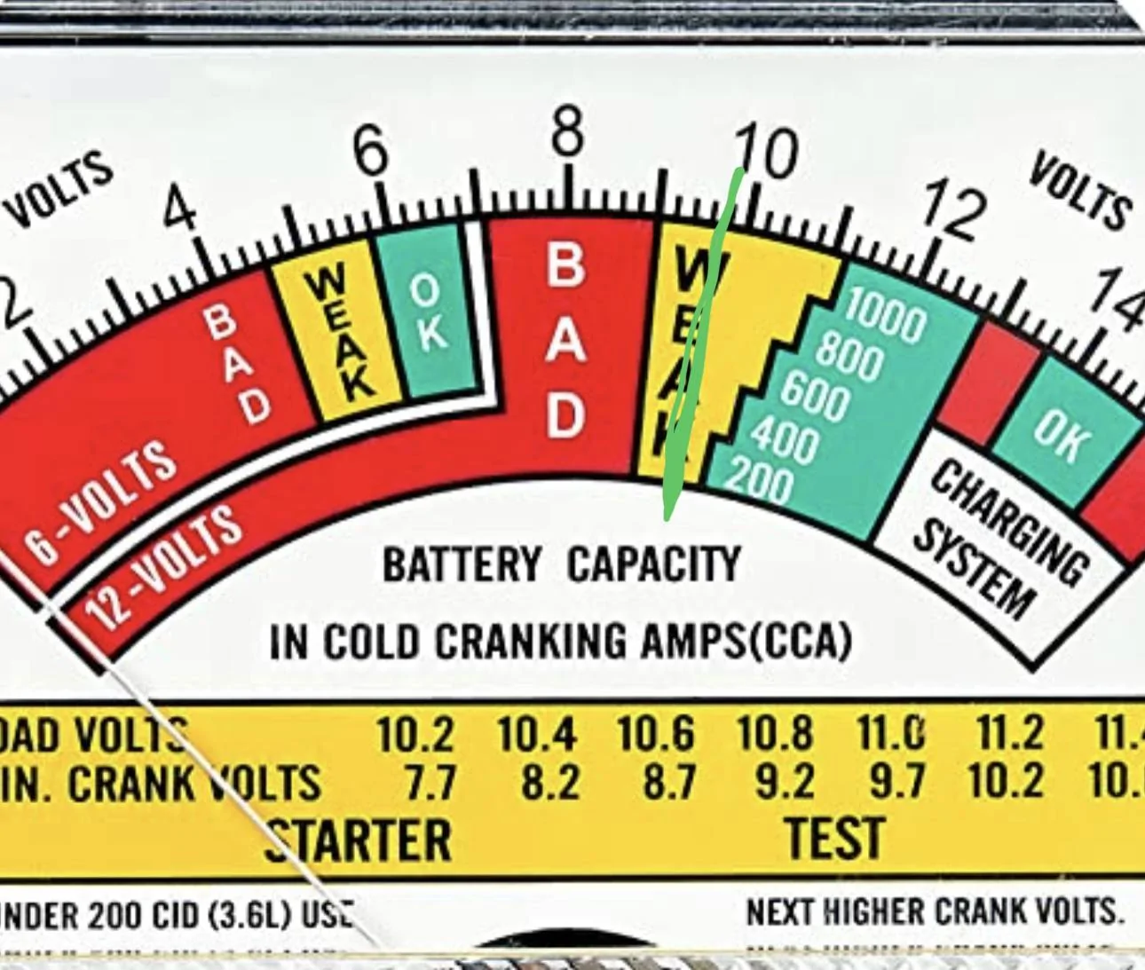

Ok so I charged the battery.
It started straight away.
I then did a battery load test.
However it’s results were “Weak”
So is it fair to say new battery needed?
It is not.
And this is the case unless you first electrically isolated your main and Aux batteries before effecting the load test.
I'm not saying your main and/or aux batteries aren't bad. I'm saying that if you did the load test with the batteries connected you did a composite load test of both batteries together from whose results limited information can be derived regarding the state of either individual battery.
Remove temporarily from the main battery's negative post the black cable that does NOT lead to the body ground on the passenger's side front quater panel.
After doing so put your load tester on the main battery's terminals and note your results. Next, move the negative side of the load tester to the dangling cable. That will be a load test of the Aux battery, yes, even though the positive side of the load tester is on the main battery's positive terminal.
Yes, I would replace the battery. And personally, I would delete the second smaller battery.
If a vehicle has a dual battery system it has always been said to ensure both batteries are the same age, size and capacity whenever possible.
I don’t understand why Jeep decided to pair a larger battery with a smaller battery in parallel. Old school thought is that is a recipe for battery failure and from the amount of posts with battery issues I tend to think the old school method of connecting multiple batteries together is still the correct way.

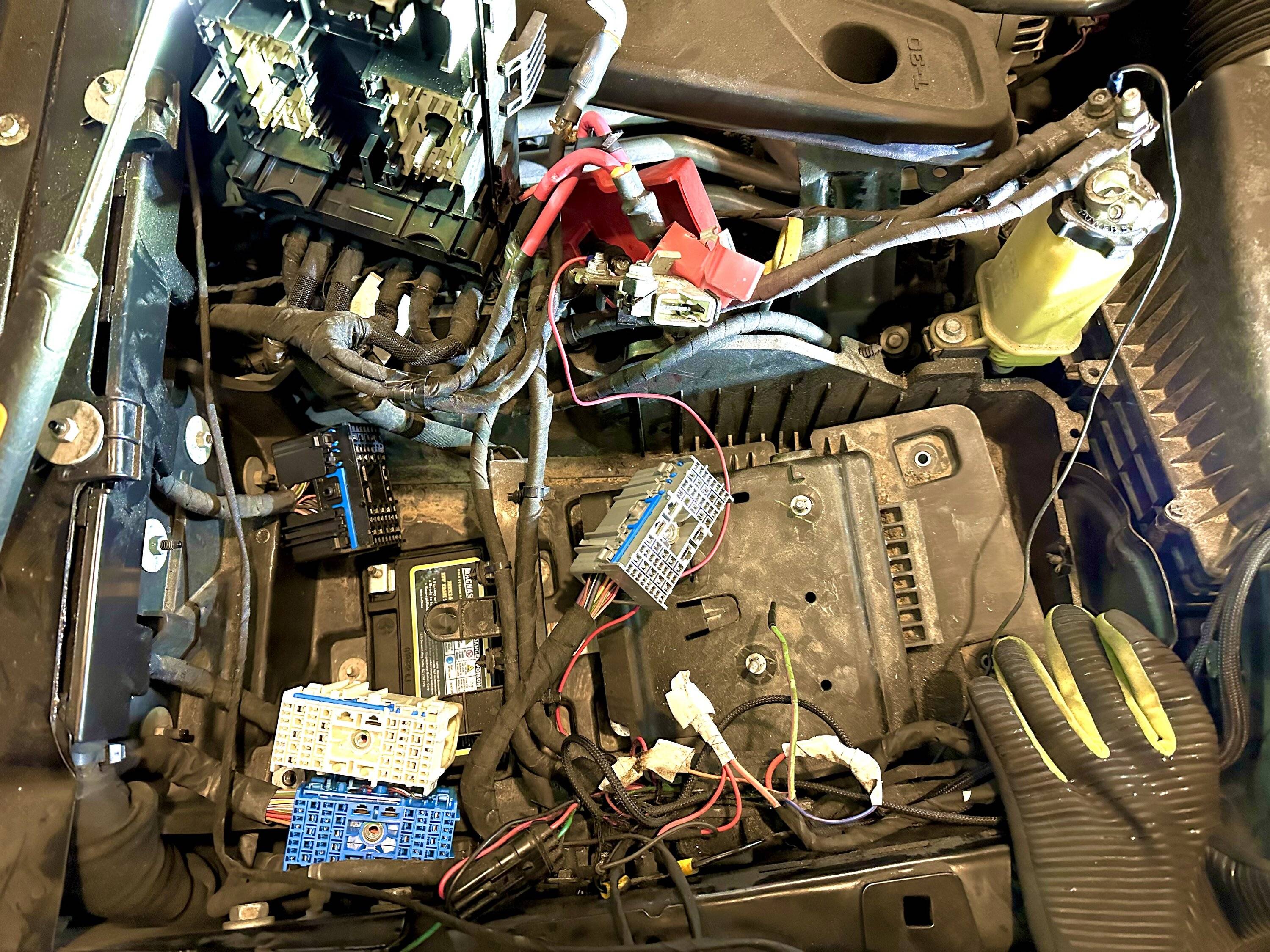

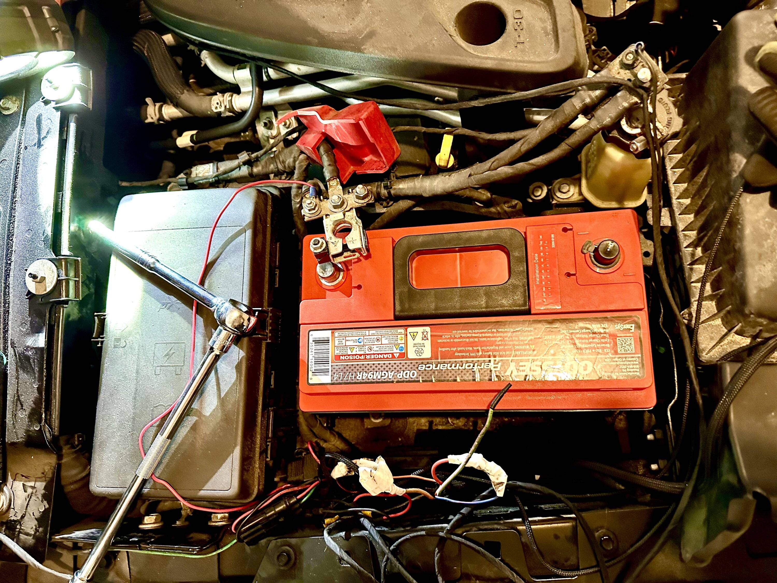

Ok done thanks everyone!
Bought a new Odyssey AGM H7 and auxiliary battery.
Replaced both this evening.
Getting at the Aux was a bitch but got there.
no more starting issues!
Is your aux battery an Odyssey?
