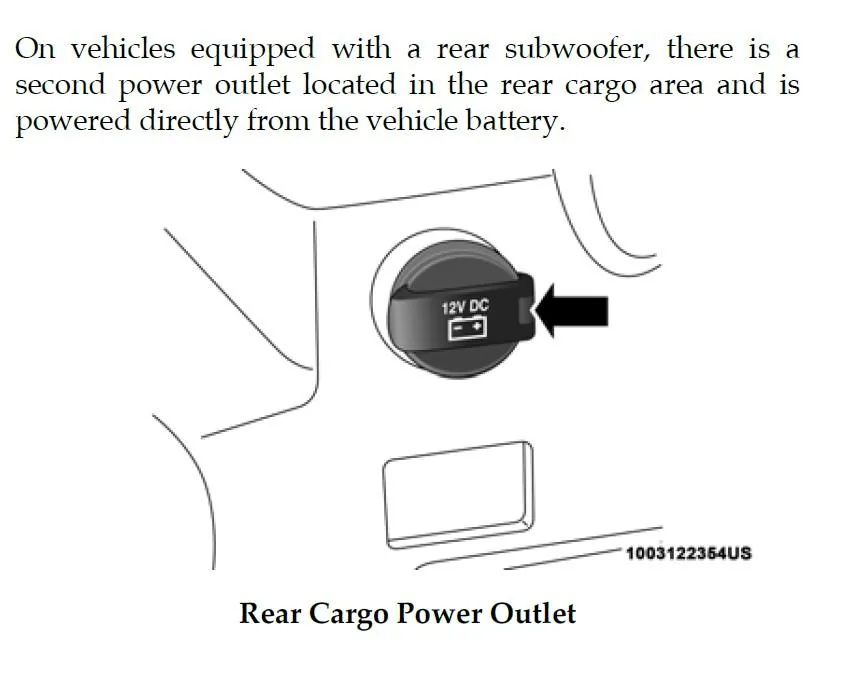

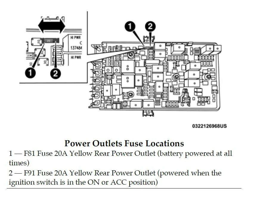

how is the rear power port a source of power draw if nothing is plugged into it and how would one set it up to not be, I’m guessing pull the fuse ?The rear power port is the source of your power draw if you haven't changed it to be ignition switched:
