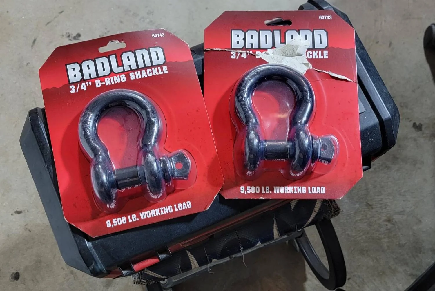

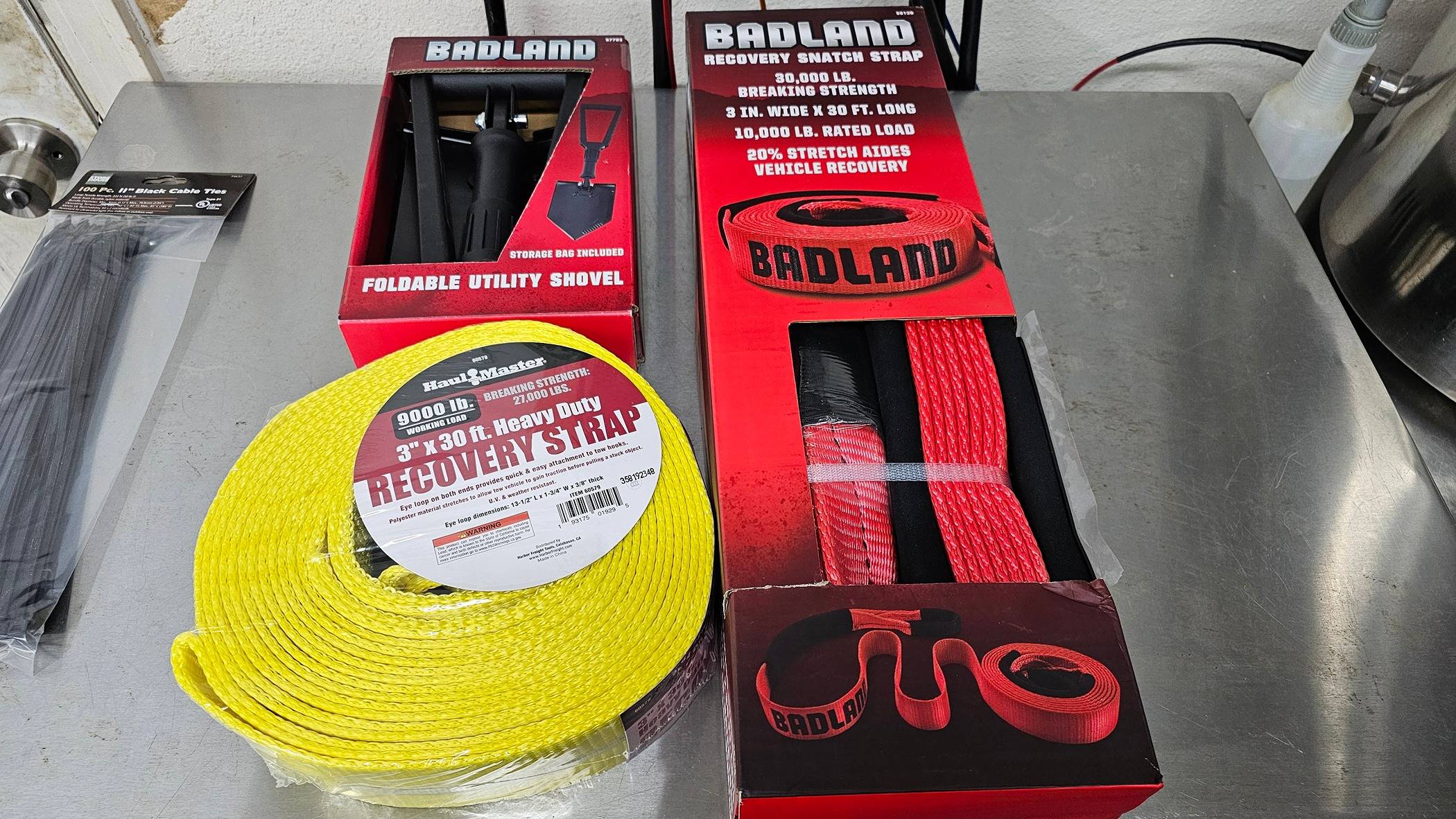

I grabbed a couple things at harbor freight today, a friend gifted me these d-rings, and I ordered 2pk of soft shackles on Amazon since they were cheaper online. Hopefully this will be a good start. I do plan to get a good kinetic rope and will continue to add to the kit. I appreciate all the advice here.
Jeep Wrangler JL Basic recovery gear suggestions / recommendations? Resized_20240608_204231
Jeep Wrangler JL Basic recovery gear suggestions / recommendations? 20240609_173902
https://www.amazon.com/gp/product/B0C497V6JJ/ref=ppx_yo_dt_b_asin_title_o00_s00?ie=UTF8&th=1
Funny enough, the same friend has a 12,000 lb Badland winch that is new in the box he never used that he's willing to sell to me. I just have to find a bumper! Hoping in the next few months I can get that installed.
