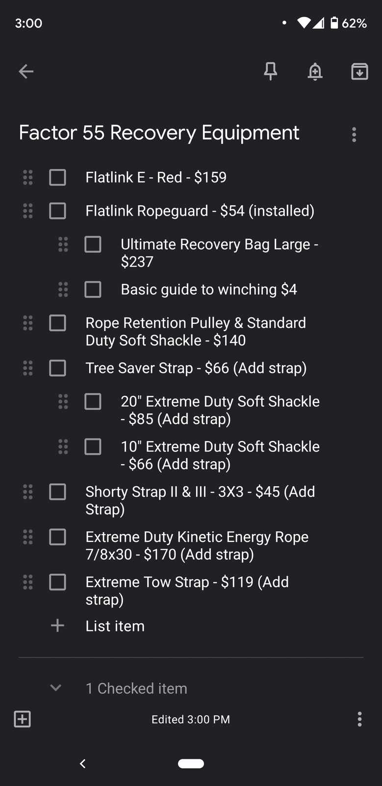

This is my "Recovery Build List". Start with a Winch, of course.
Indentions indicate buying together.
I went through the complete packages that Factor 55 and others had, and sorted through what I thought I'd actually need based on what I do and plan to do.
This is what I came up with. YMMV.
Jeep Wrangler JL Basic Recovery Kit Screenshot_20200716-150057
