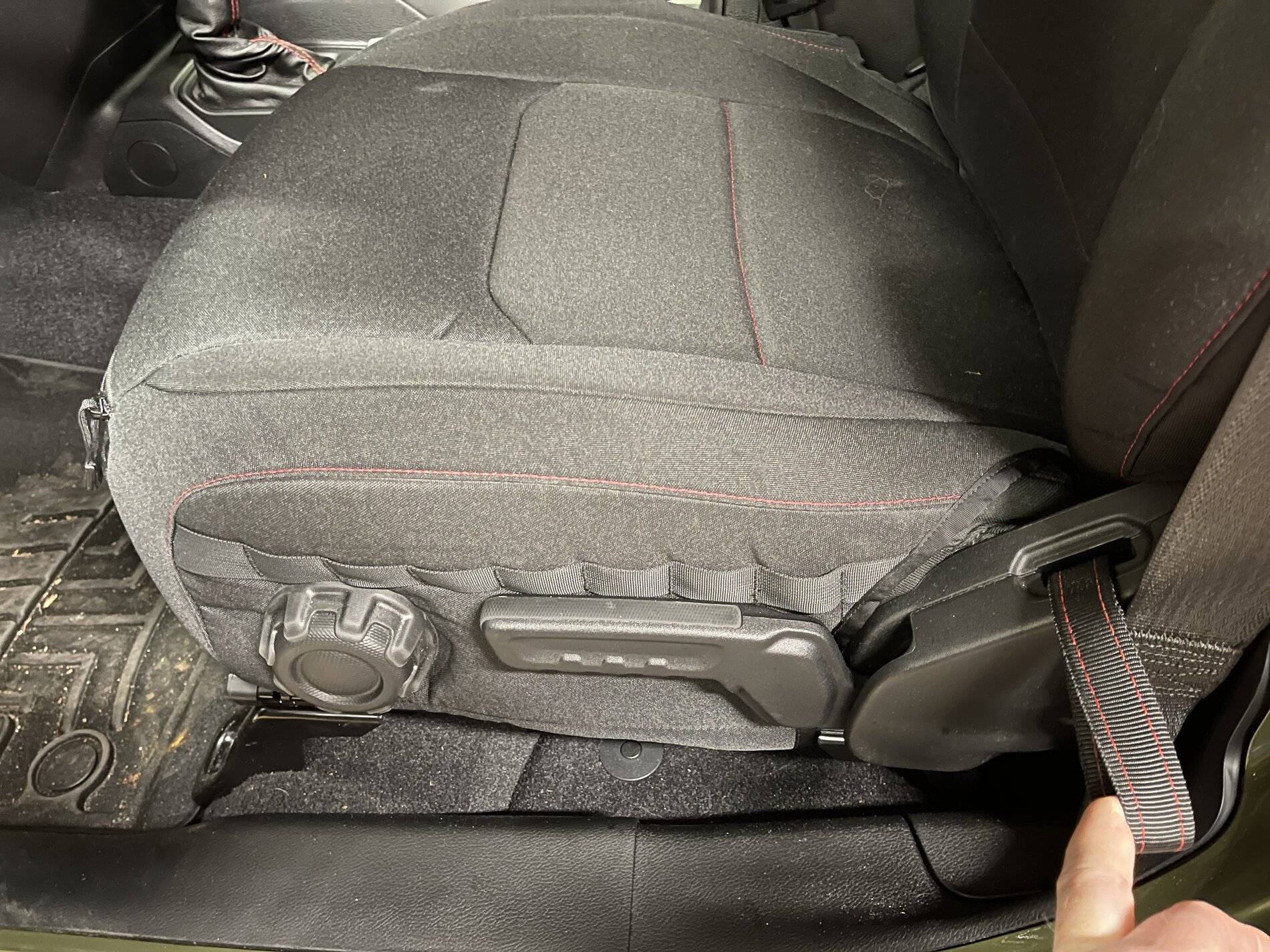

I have these on my 21 JLU and am having fitment issues. The seat bottoms weren’t covering the whole seat so Bartact sent me new ones but they seem to be the on the smaller side like the ones I previously had. Also they don’t seem to be staying tucked in, the bottom and the seat back portions.
Can I see pics of how yours are fitting, especially from the side view?
Is the velcro on the edge of the seat back that you tuck thru the seat supposed to Velcro to anything? Also there is Velcro on the seat bottom that gets tucked thru that doesn’t seem to velcro to anything either.
I have them on my 14 Willys and never had these issues.

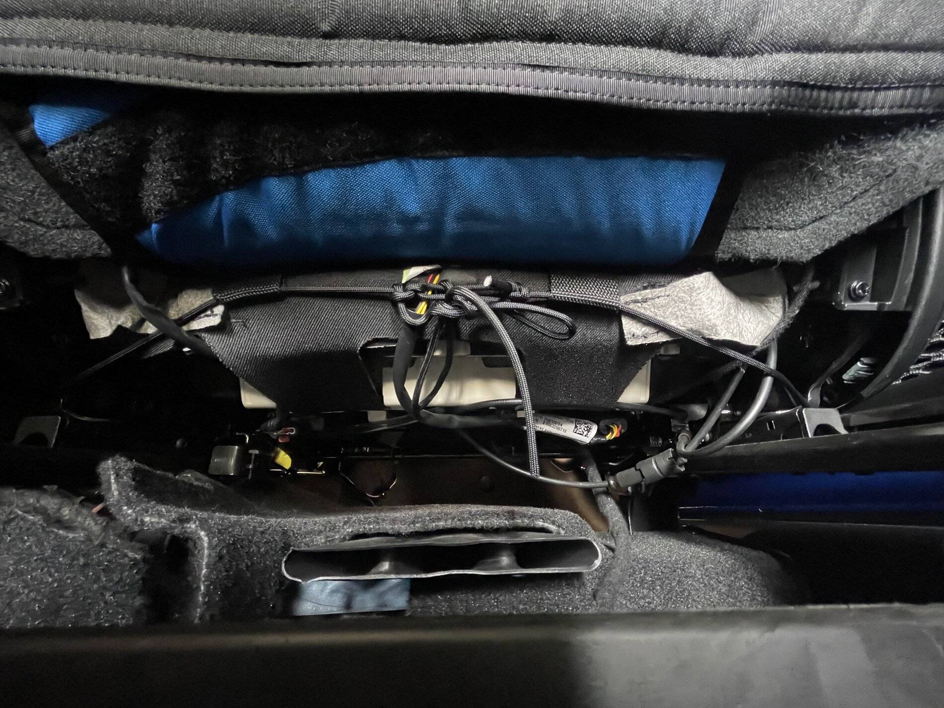

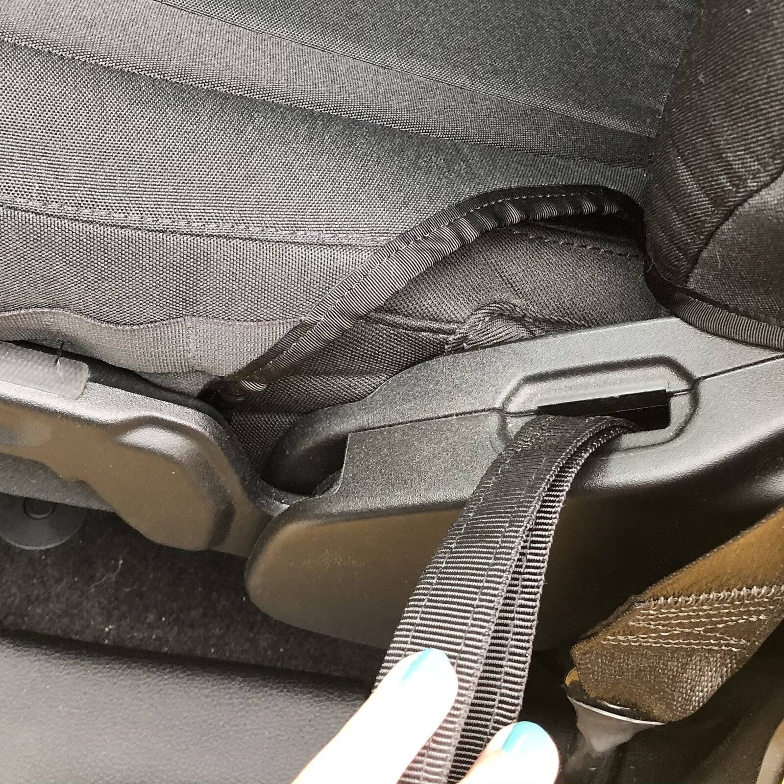

Some pictures...
Jeep Wrangler JL Bartact seat cover issues IMG_3767
Same gap near the back on mine.
Jeep Wrangler JL Bartact seat cover issues IMG_3772
Bottom half not pulling tight through the seat crease.
Jeep Wrangler JL Bartact seat cover issues IMG_3769
OEM plastic clap tucked down into the front flap of the upper cover piece.
Jeep Wrangler JL Bartact seat cover issues IMG_3771
Front flap of the upper cover stretched around to reach the back flap of the upper cover. Also, the cord that holds the bottom cover on.
According to Bartact, this is how they're supposed to be installed now with the new design. So yeah, I'm just gradually tightening them as they get broken in and hoping for the best because I love everything else about them.

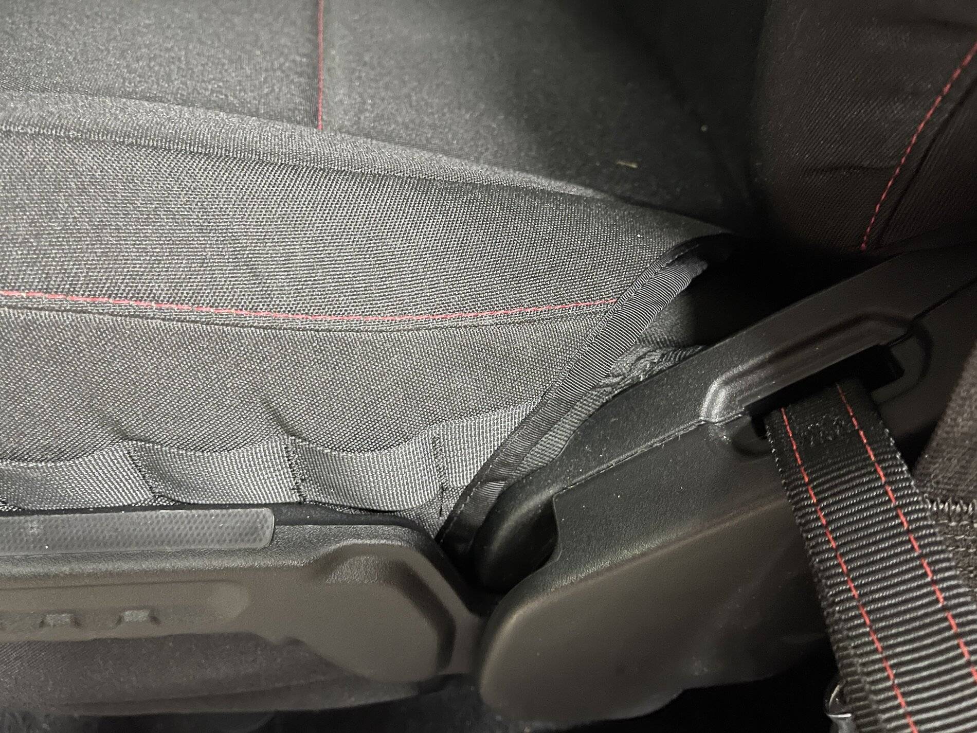

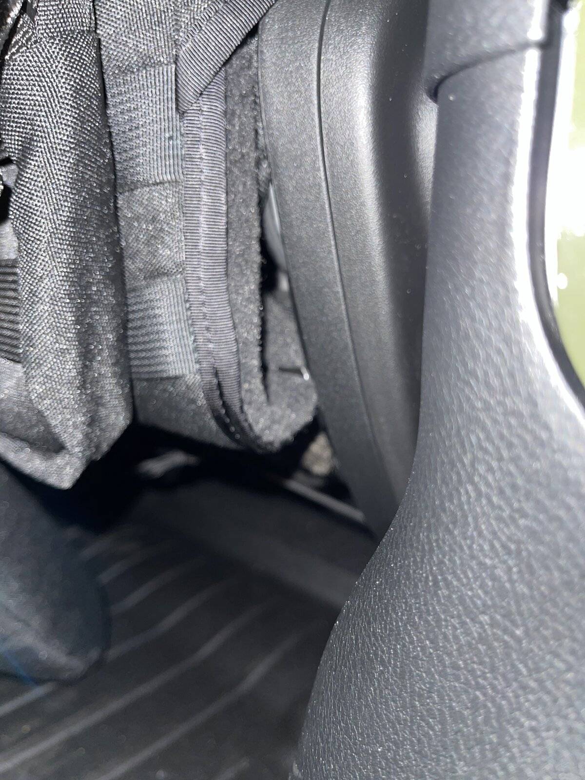

here are some pics.
First the lower cover position. Pull it good, use the MOLLE straps to help position it and muster any and all super powers to pull the back flap thru and velcro it down. All paracord does is keep the sides and front curled under for a nicer look.
Jeep Wrangler JL Bartact seat cover issues FCE4E18B-884C-4F89-BAD9-AB99BE926858
Jeep Wrangler JL Bartact seat cover issues 0AF2DF87-BF27-4695-9442-A92BCB85FF60

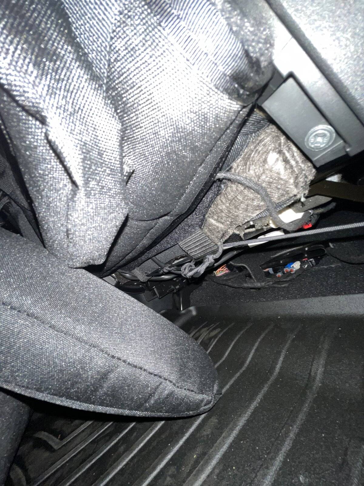

the back images here show the lower Velcro’d and the OEM flap folded upward. I will say this was not easy to do cleanly solo. If you can have someone hold the OEM flap while you pull the top cover tight it will be quite easy. I did it solo and it just took multiple attempts to get it tight and cleanly tucked up. I’m in the middle of doing a pretty big project and my seats are folded down and I can’t fold them up right now. This is looking in from passenger rear door at the passenger front seat.
