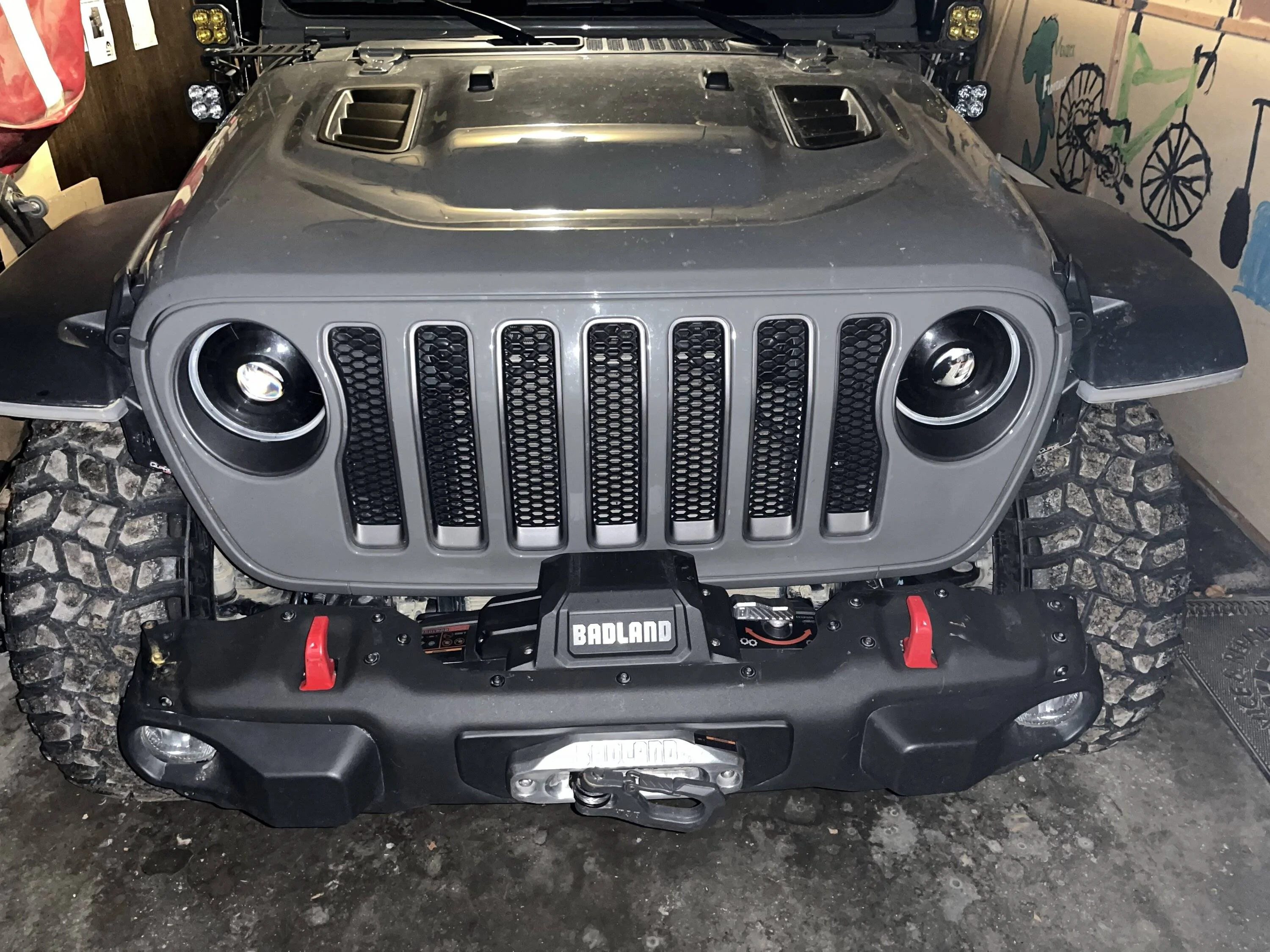

Anyone have a recommendation for a bumper that will work well with a badlands apex? Just got my 24 Willys and starting my build.
I have the Badland Apex on my Rubicon I installed the Extreme HD steel bumper I got from Extreme Terrain Jeep it's a little cramped up at the grill ( the wires are crammed but no problems)

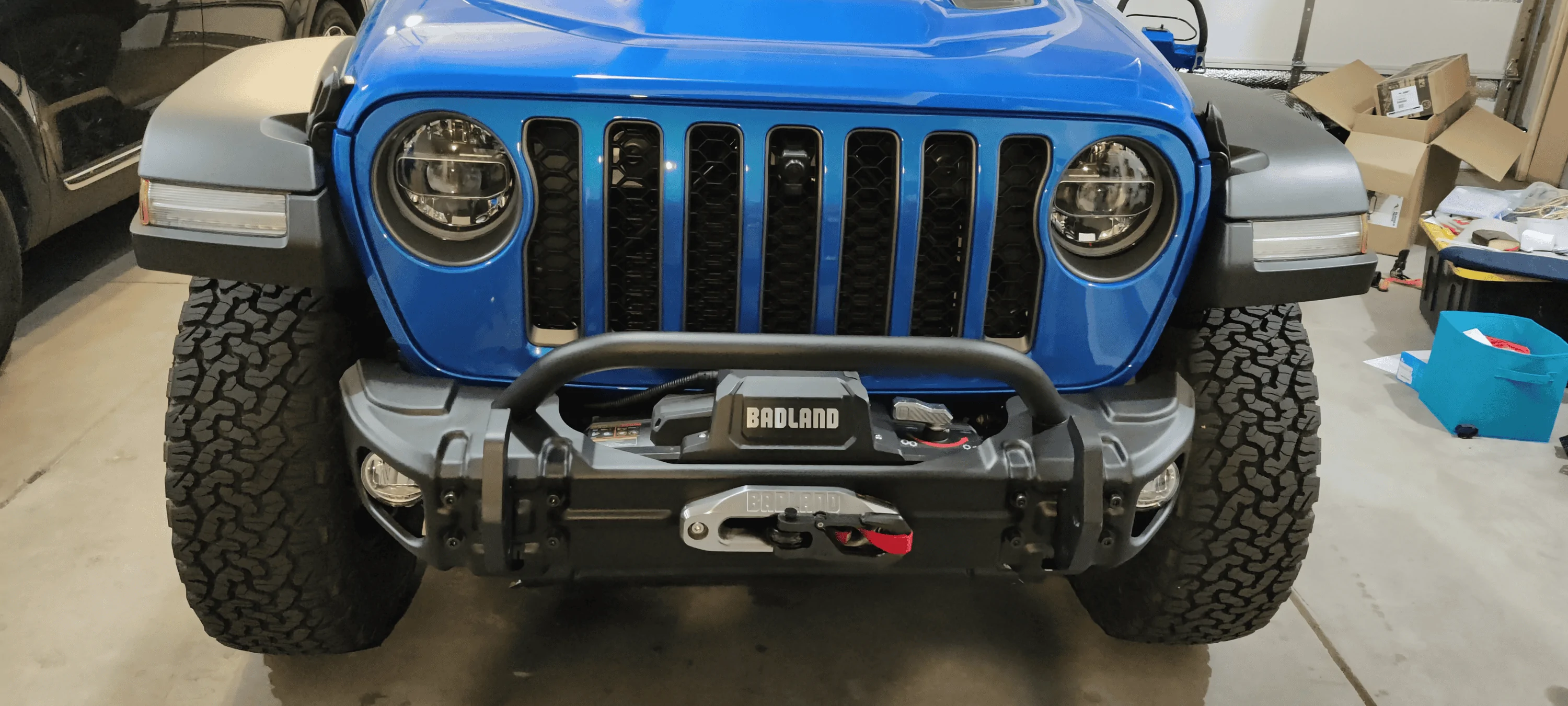

I’m running the mp concepts aluminum bumper. With the badlands winch I only saw 1/4 drop and gained about 30lb over stock plastic bumper. It came with the winch plate and skid plate.
