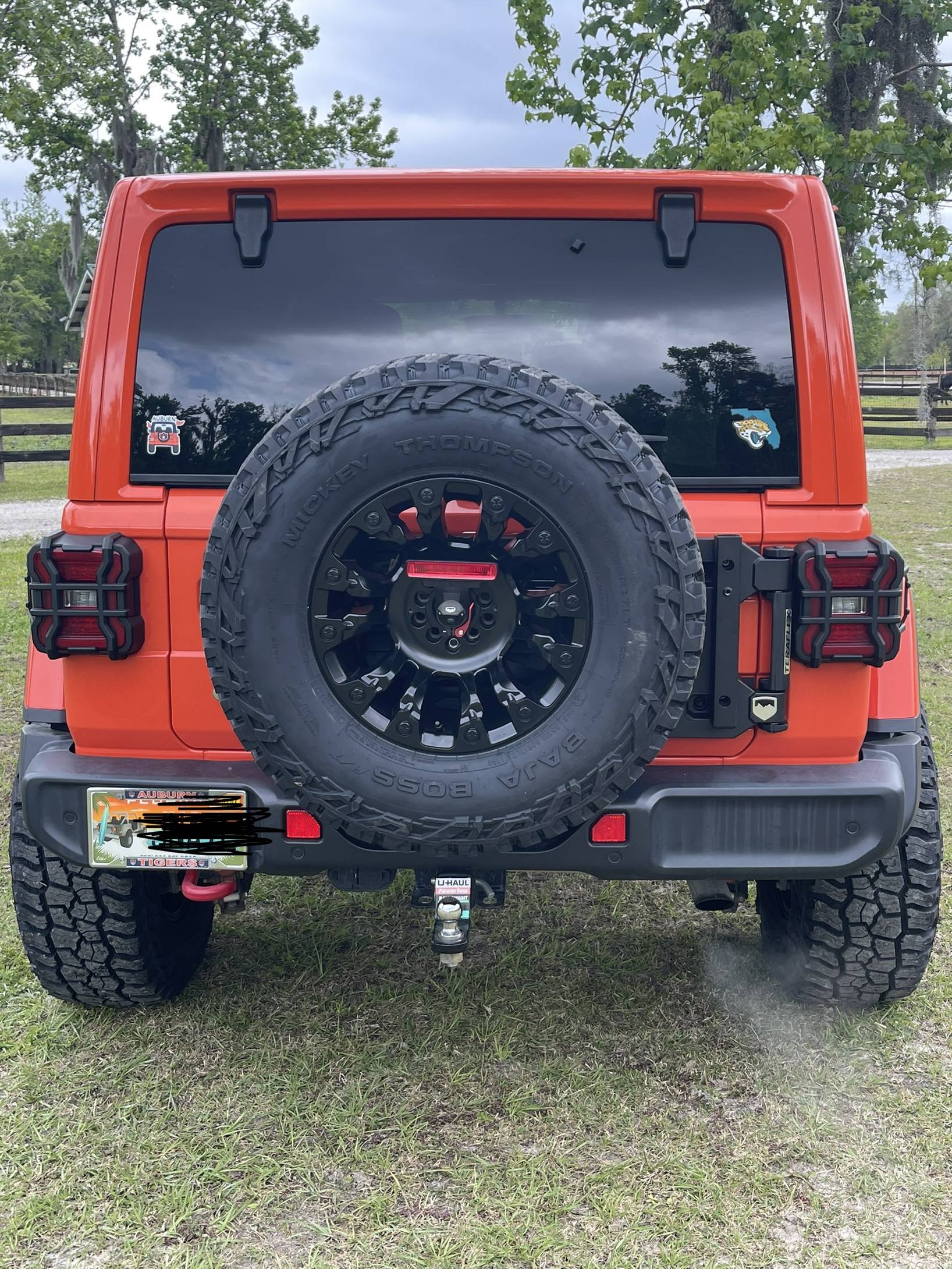

Thought I would revive this thread as I just added 35s on the Teraflex Alpha tire carrier and tailgate reinforcement.
wanted to see if there were any other suggestions out there to solve for the rear backup alerts.

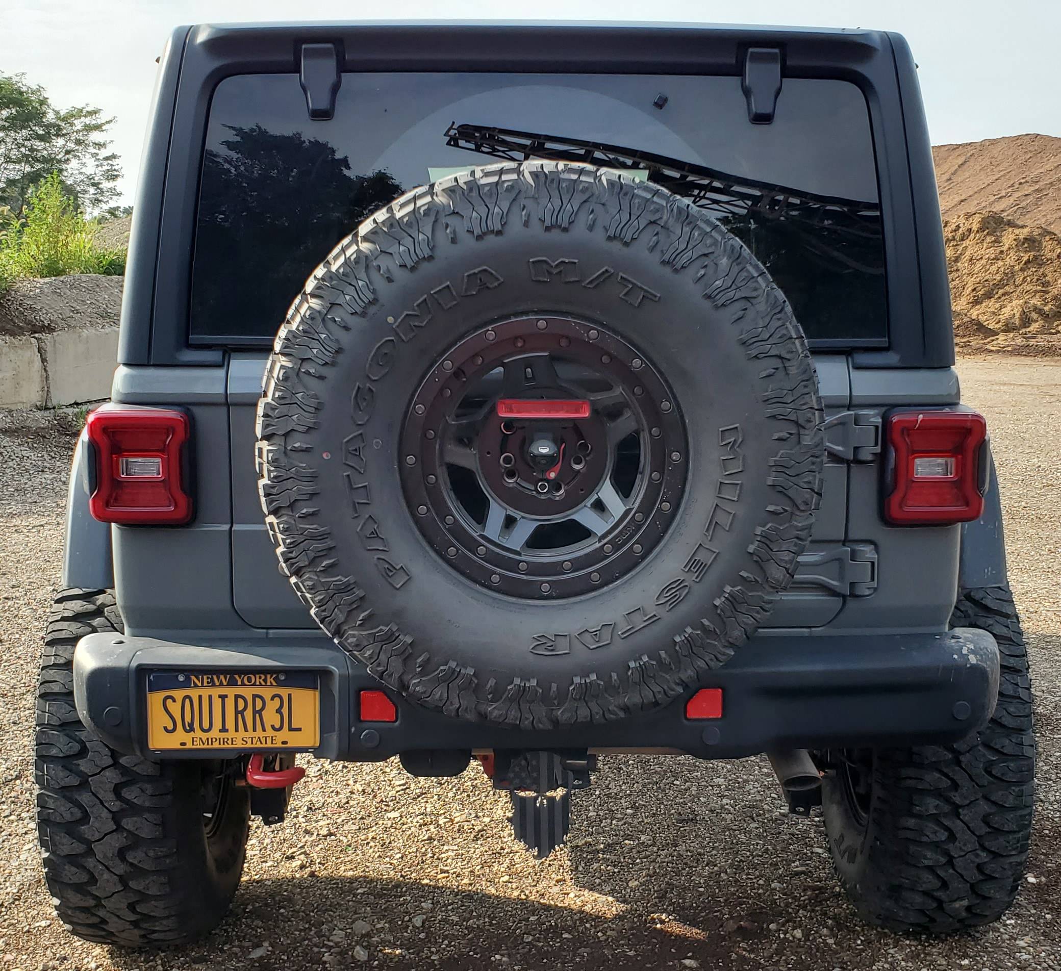

Here's a couple of pics...

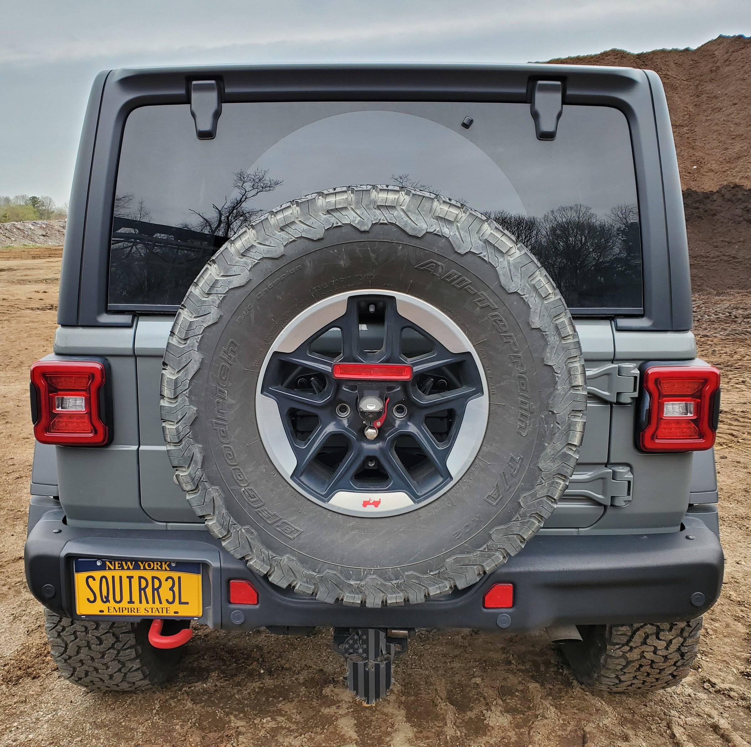

Factory wheels wrapped in 315/70-17 bfgoodrich ko2's on the spare carrier and than the Alpha HD set to the highest position to maximize rear departure angle...

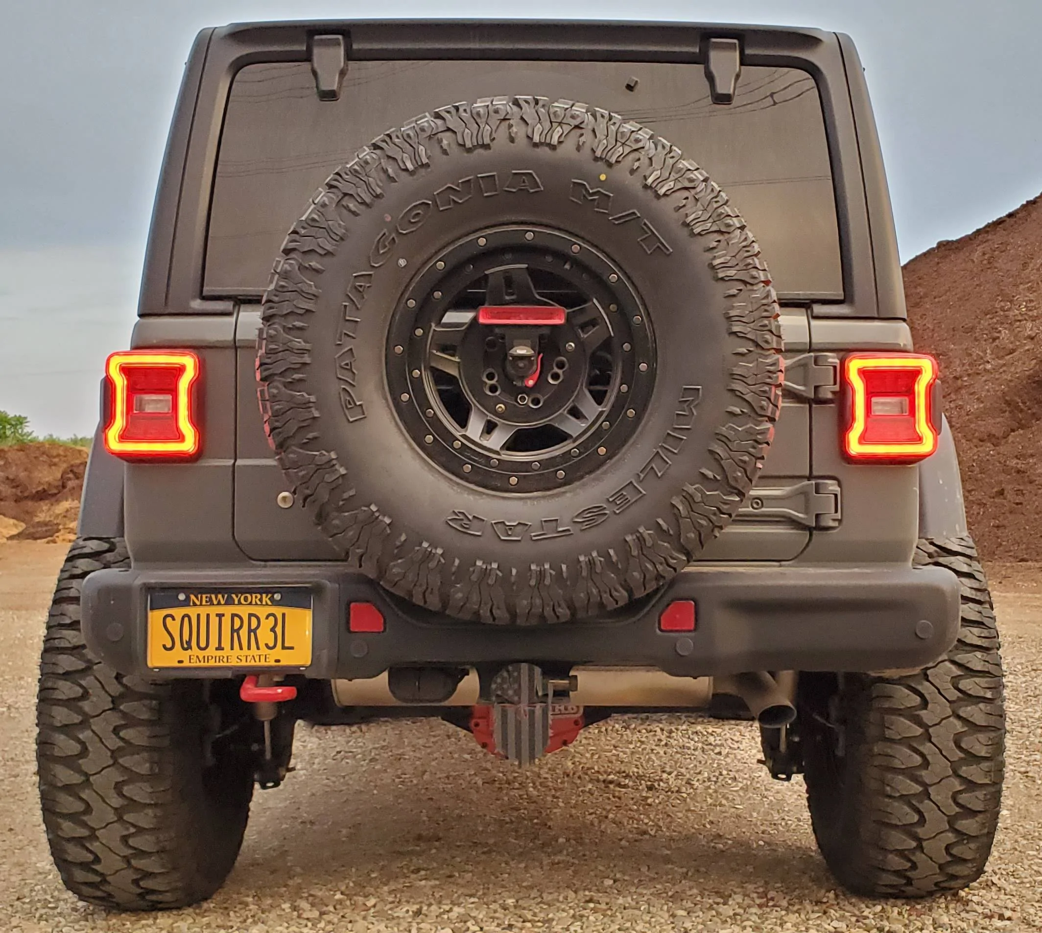

KMC 17x9 wheels with -12mm offset wrapped in 38x13.5's on the Alpha HD. This heavier combo is when I started getting more rattles and started noticing that the factory hinges were the weak point...

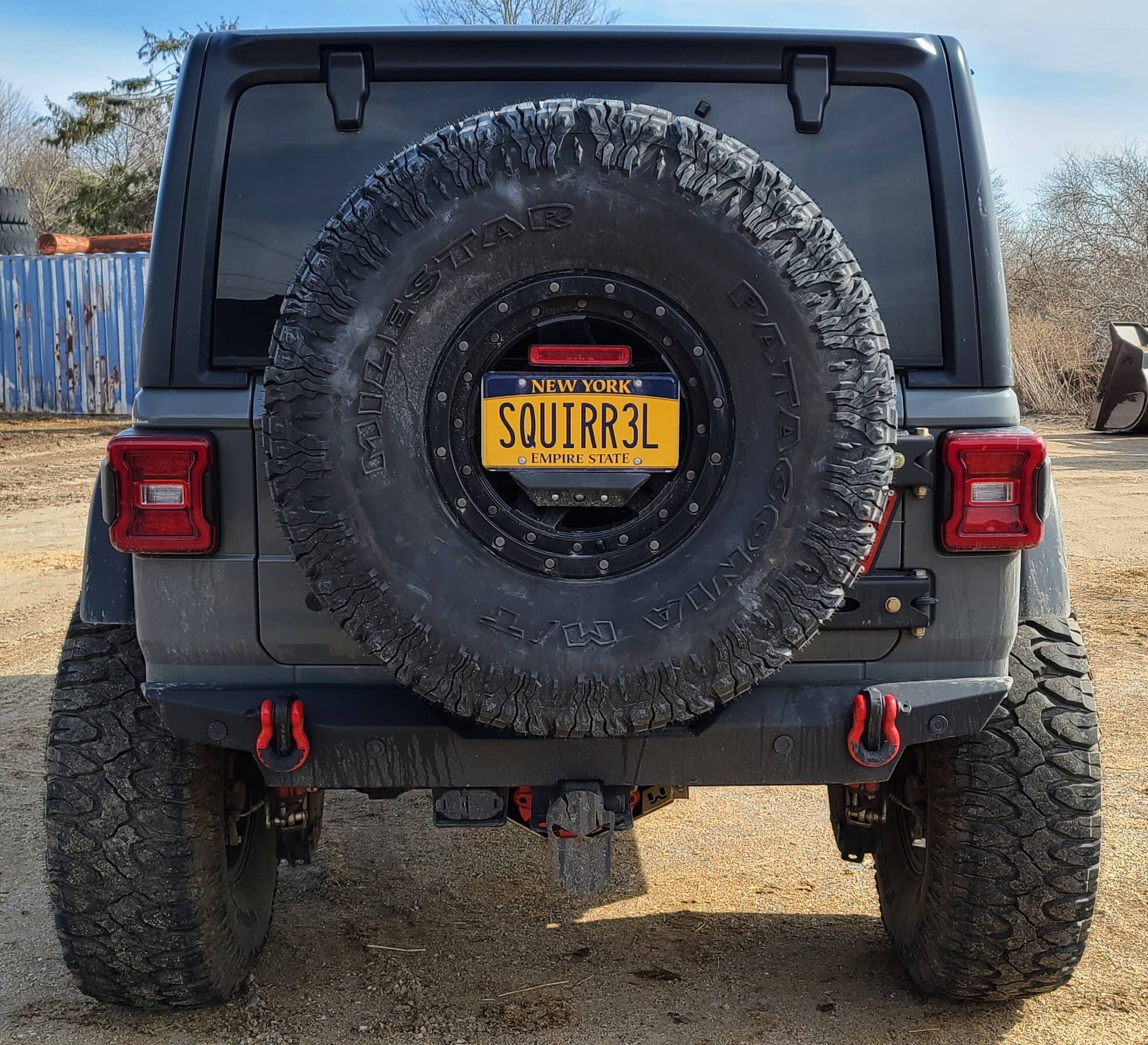

Same wheel and tire combo on the Cavfab Elite hinged carrier, also set to the highest position for maximum ground clearance and departure angle...

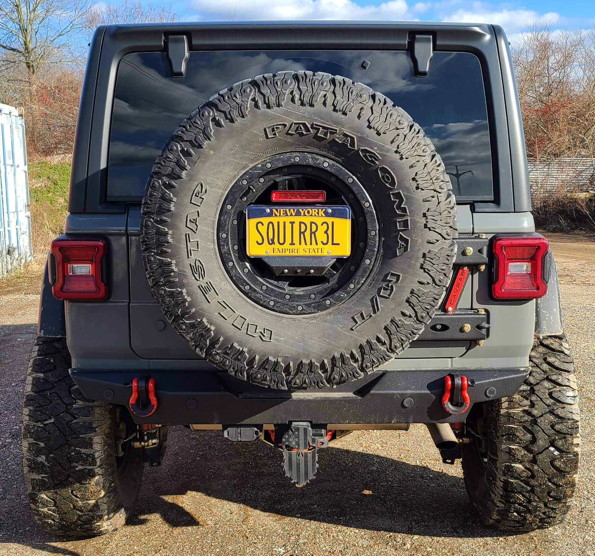

And finally as it sits right now. Same wheel and carrier, but with 40x13.5's...
No exaggerating, I can hang my 180lb bodyweight off of the open tailgate and still not get any movement other than from the suspension. This Cavfab Elite hinged reinforcement and adjustable carrier is phenomenally strong!

The Cavfab Elite definitely held my previous 38's higher than the Teraflex Alpha did. Both carriers set to the highest position.

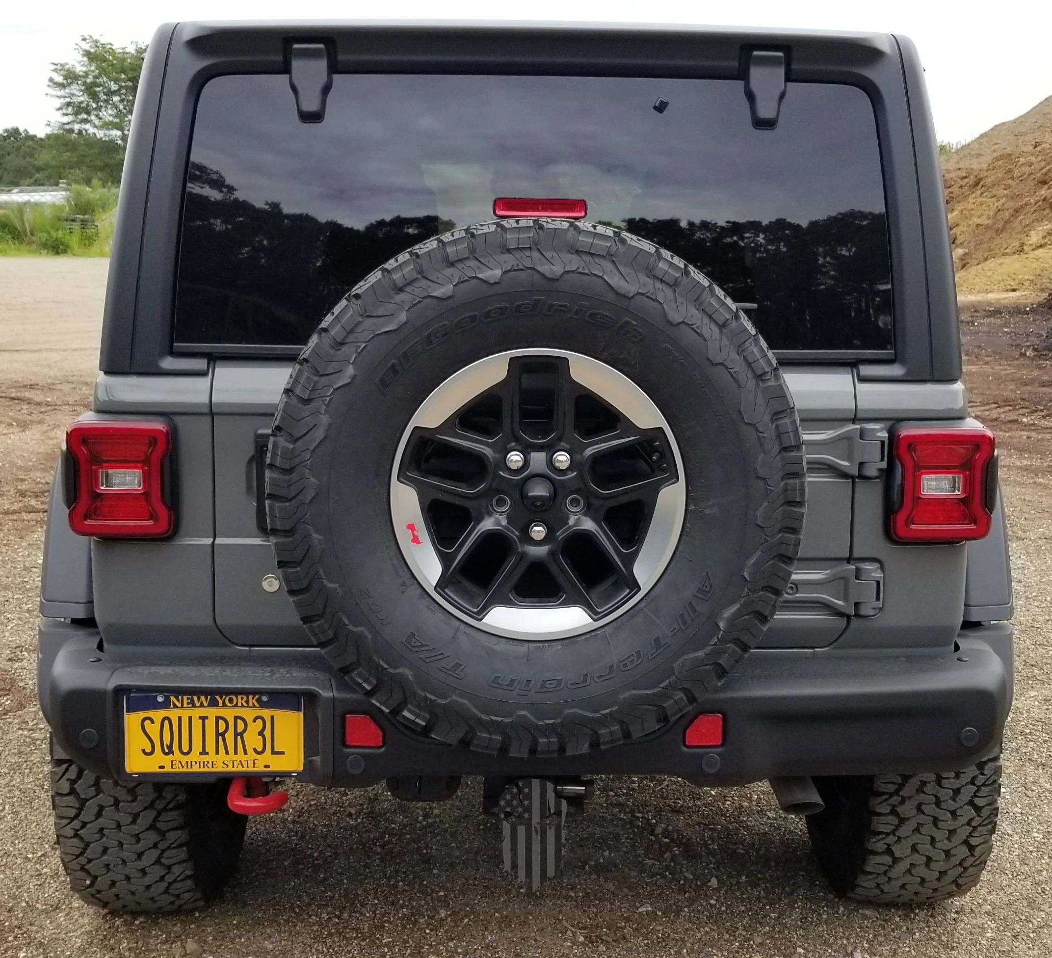

Here's comparison pics. Since I also changed the rear bumper at the same time as the carriers, note the relationship between the same exact spare and the bottom of the tailgate panel, and the top of the tire to the roofline...
Jeep Wrangler JL Back up warning sensors going off. 20200628_200959_resized
Jeep Wrangler JL Back up warning sensors going off. 20210117_135607_resized
Maximizing departure angle is also a priority in what I've done to my Jeep. A great trick that I learned from Lite Brite, is to fully air down the spare when in a scenario that involves dropping off of ledges. This allows the tire to flop around rather than transmitting the force into the tailgate. The tire will stay on the beads as long as it doesn't get seriously dragged.
