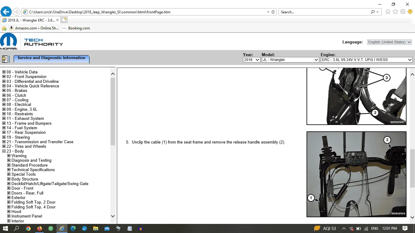

Yeah, it sounds like a cable issue. There is a procedure in the service manual.
Jeep Wrangler JL Back seat 1668877231737
Jeep Wrangler JL Back seat 1668877270290
